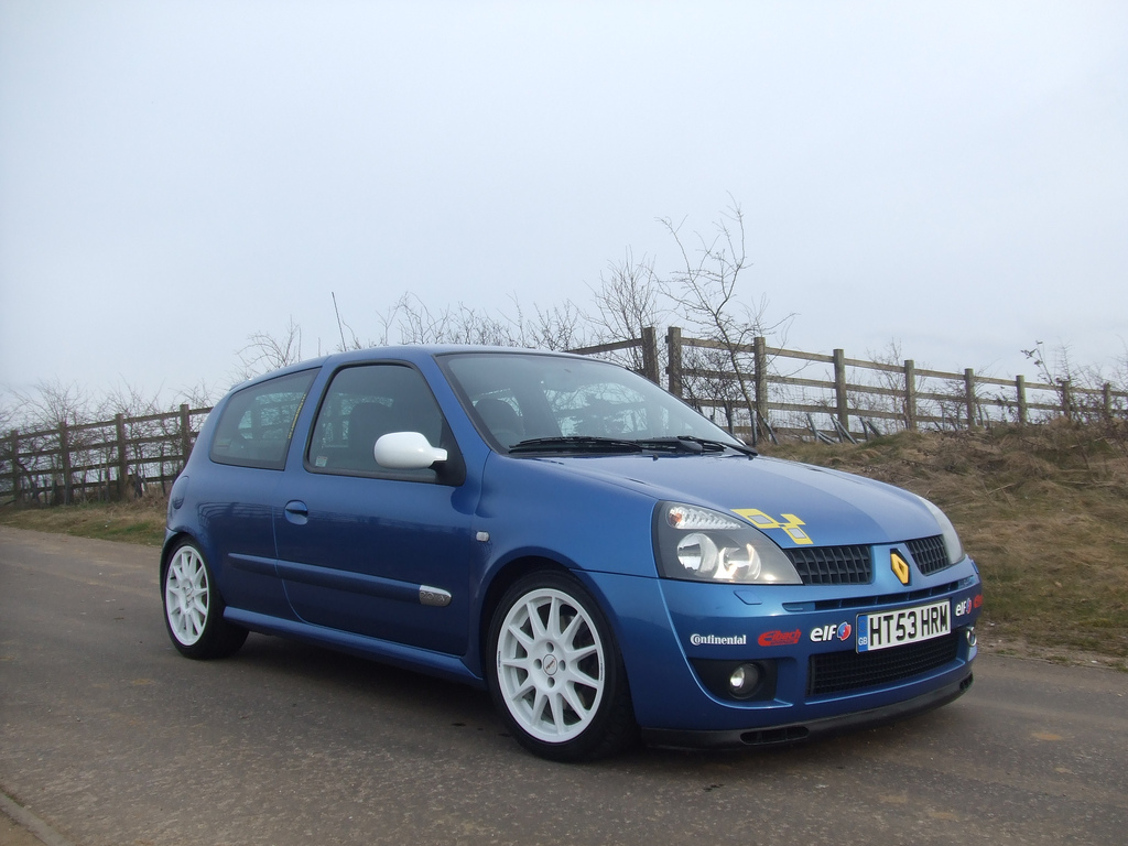

This is how my car is set up now. Was just wondering what its ment to be?
It does Seems very understeery and the backend is just planted and wont move lol.

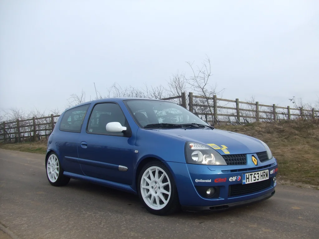

With mine I tend to drive on smaller B roads all week to and from work, where the road quality is generally uneven and poor. I do not intend to lower the car any more as it needs to be practical to drive. I have noticed the slight (not known to be accurate in my case) camber I set it up with (without measuring gear it is about 0.75-1 degree) leads/makes the car follow car into camber and bumps of the road more than it did before. I'm looking for a more stable setup if possible with possibly less following of the road.
Please bear in mind this photo was taken the day after fitting new coil-overs so some settling will kick in over the next few weeks (and yes the gradient I was parked on prob doesn't help but I don't believe it has shifted the suspension comparable to when on the flat).
