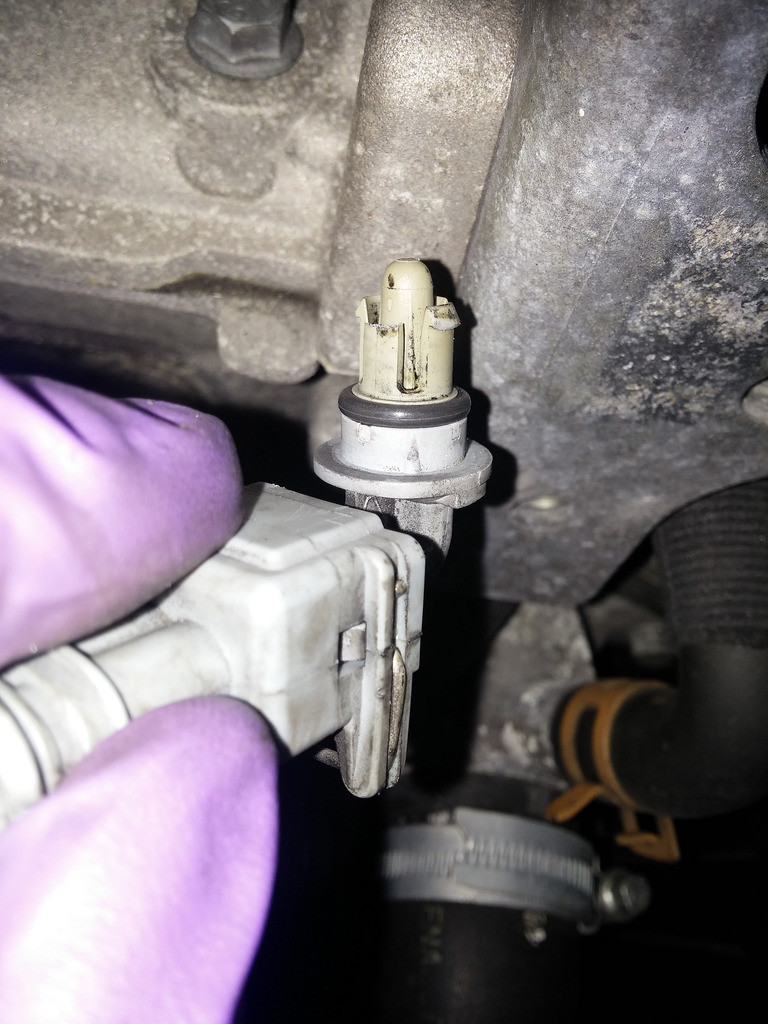

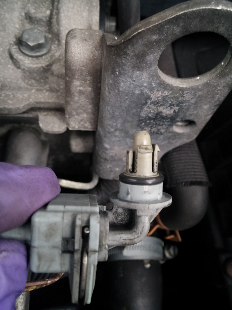

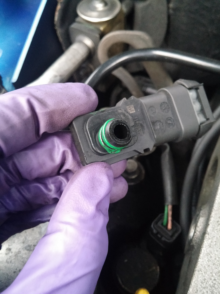

Tried changing the throttle body and cleaning the TDC sensor but to no avail however today my mate came over and we started looking at some of the sensors going into the inlet plenum. I'm hoping these are what's wrong and maybe causing a vacuum leak!
The AIT sensor has a clip broken on it so it's fairly loose, not sure if it's supposed to be loose-ish anyway

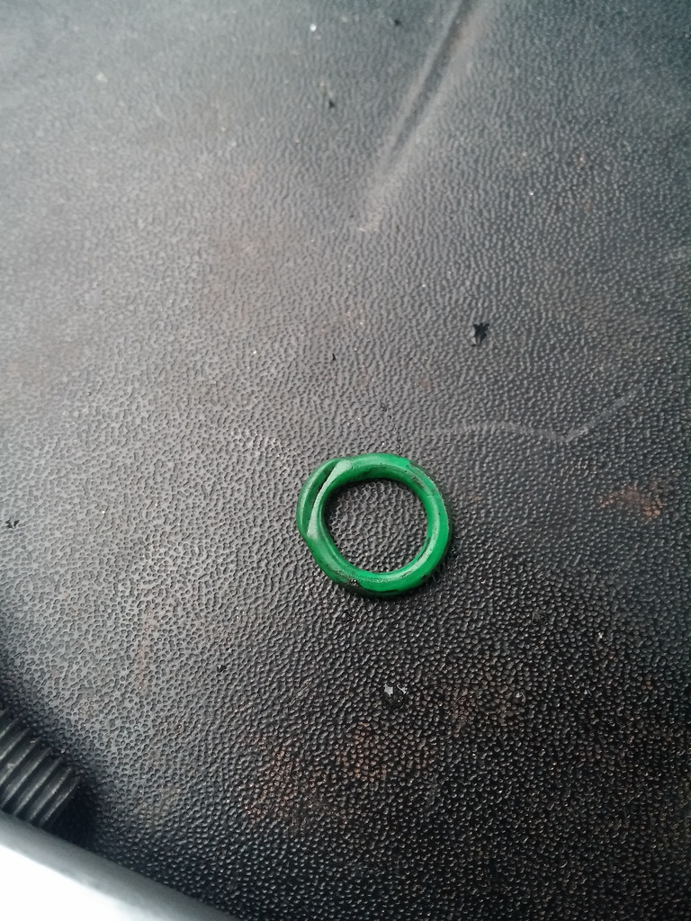

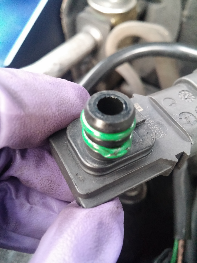

And the MAP sensor looks like this! Changed the seal to a new one now and about to go for a drive to see if it's doing it. The issue is is that it's intermittent so I can't tell straight away if it's solved it.

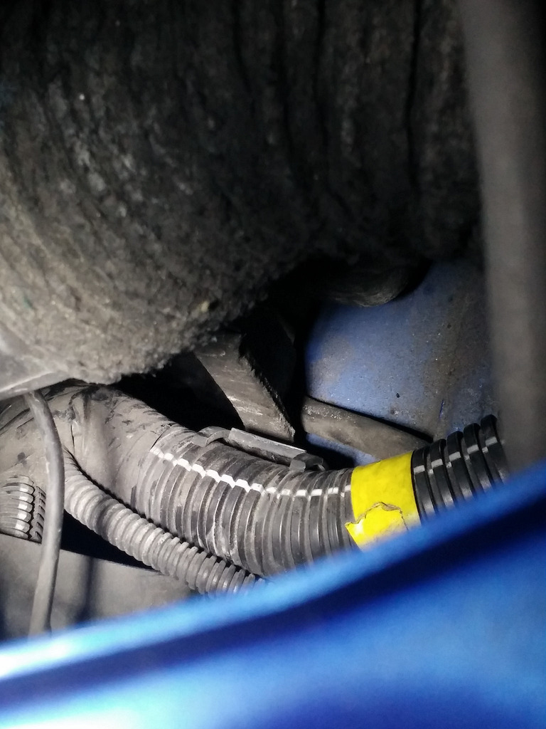

Got back from the gym tonight and somehow found the strength/will to have a look under the bonnet to see if I can see anything spurious!

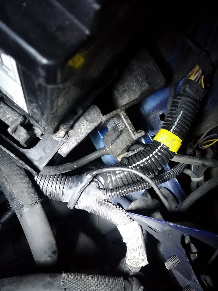

I noticed something in the corner of my eye that made me go HMMMMMMMMMM. Check out this.
20150113_204316 by dann2707, on Flickr
That pipe above the yellow bit is the pipe that goes to the acoustic valve (or a bolt in my case as I removed it yonks ago). And that pipe happens to be crushed under the engine. It's either from when the cambelt was done or the clutch but basically that pipe is trapped under a nice bit of thin metal.
This shows it better!
20150113_205215 by dann2707, on Flickr
So my initial thought is that's giving me a vacuum leak, it's got to be. So I started the engine up and sprayed that area with combustible maintenance spray expecting the engine revs to increase. Nothing :(
However my thought process is this, it's trapped when in gear and when i'm pressing the clutch (when the problem occurs) it's rocking the engine possibly moving this bracket/trapping of pipe and it's allowing a possible split pipe to suck in air if that makes sense? And might suggest why it's doing it intermittently.
What do we think?
I cut the pipe off above the trapped bit and bolted it up so time will tell tomorrow on the drive to work tomorrow!

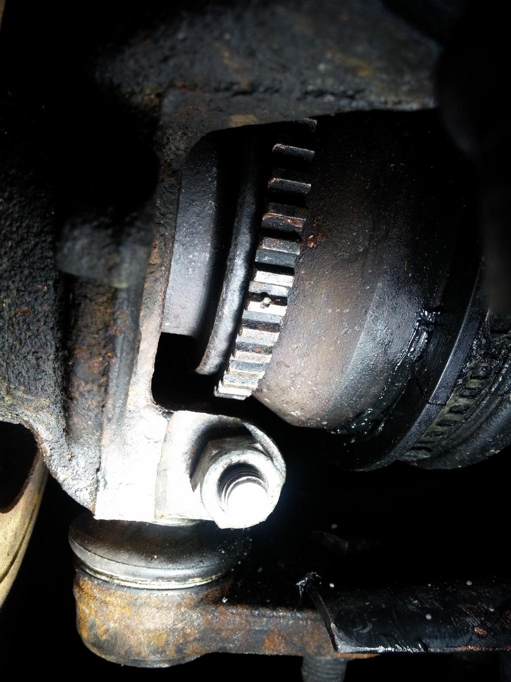

@bashracing being a hero hooked me up to his diagnostic laptop and found that the nearside sensor wasn't mirroring the other sensor indicating that something along that side of the car is at fault. The reluctor ring isn't cracked or split apart however I noticed something last night that the ring, one one tab has an indent in it much like it's been hit with a centre punch but the tab is still there.
Could this be throwing it out? Will take a pic tonight to show if it is or isn't bad. The wiring looks to be intact too.
