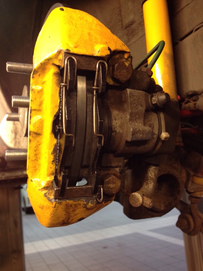

Here are the spring clips in the correct position
