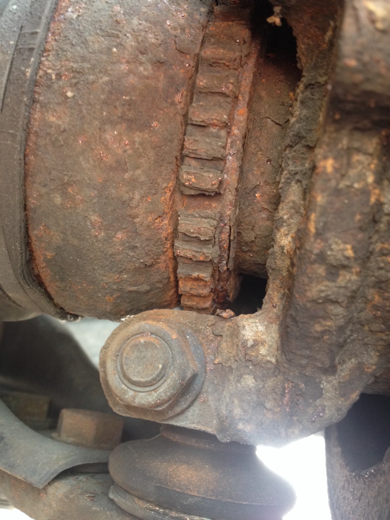

Does anyone know if it's 26 or 44 teeth on the front rings for a Ph1 172 and does it matter if I have 44 on the rear but 26 on the front rings?

Confusing as another thread says it's 26. That's what I have just put on and the ABS is kicking in. Dialogys doesn't show it so I'll check with Adam at Renault see if he sells them.
  172 Ph1/Scooby MY00
Grand. I fitted new ABS rings this afternoon (with 44 teeth this time) and everything now works fine. I have just been out to properly bed in the pads again along the bypass and no ABS issues, even on the rough parts of the road where it used to cut in before.

Have I missed a tooth lol .
Rotten as a pear
I'll order a 44 tooth one as mine is also a Ph1 172
