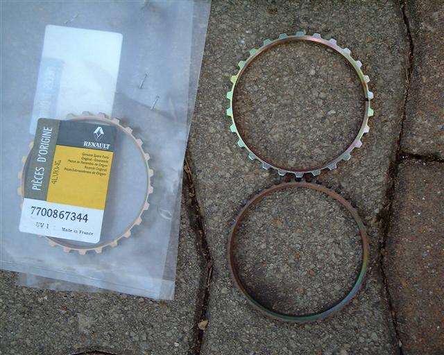

Yes the ABS rings are stuck onto the hub end of the driveshaft.
You can get new abs rings from renault I think. Mucho cheaper than a new shaft.
  Lots of Alfas
Yeah ask renault and see what they come up with. The rings just tap on the shafts. When the clios came out at first you couldnt buy the rings but now they have released some so you can buy seperatly. Especially since some of them have been found to split/crack. Heres an example, that may fit, but iirc this was one for the rear discs.
