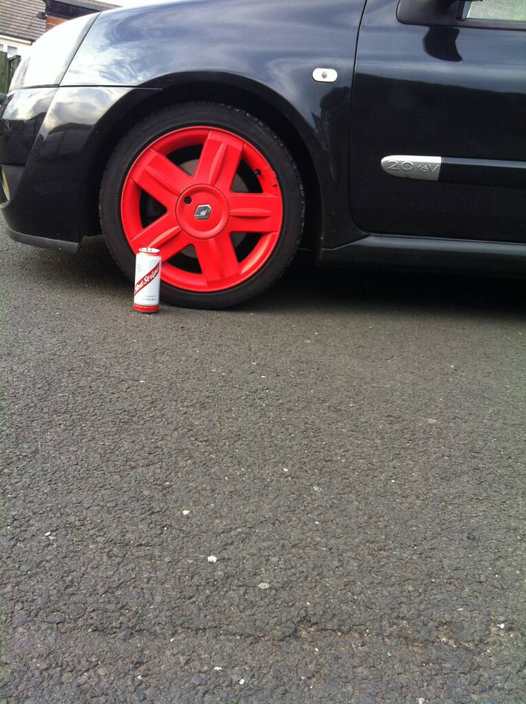

Good old clio at it again lol. Touch wood mines behaving it self as of recent. Not cost me nothing so treated it to a wheel refurb!
You watch a big bill soon!
  172
What colour you gone for?
Gold bronze colour the cars black so it gives me free reign. At the moment I've plastikoted my wheels red
