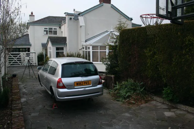

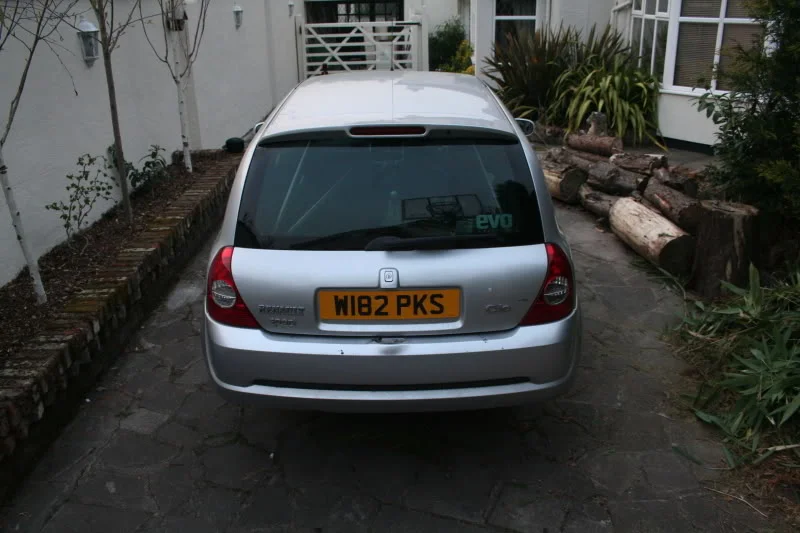

Just thought I would share a few pics of where the new clio is upto..
Will do a full blog but a few cheaky snaps of where its at now... aiming for a bawls out 240hp 180 lbft NA track/fast road beast!
Needs to be done for FCS in 8 weeks. Owtch. All the work is DIY bar the BE build. So go easy lol.

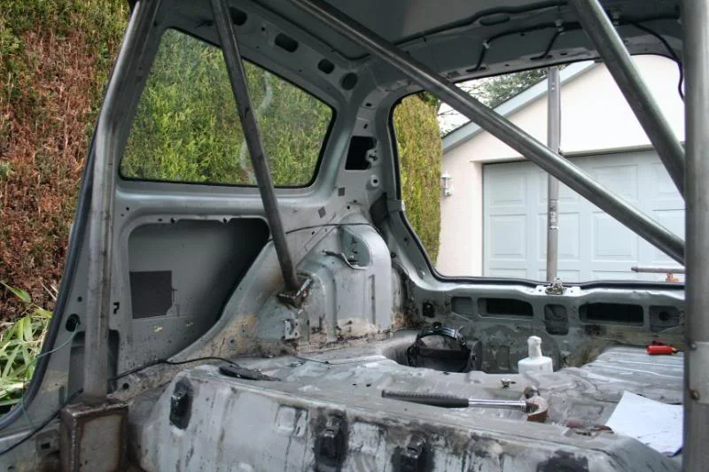

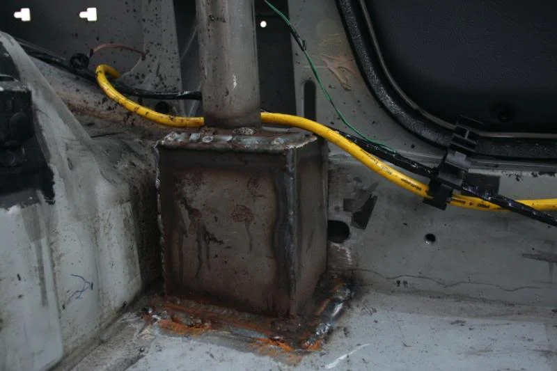

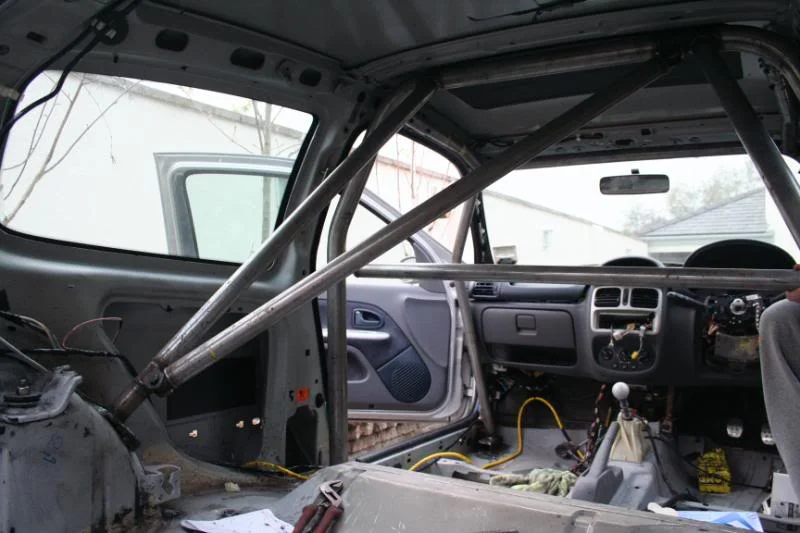

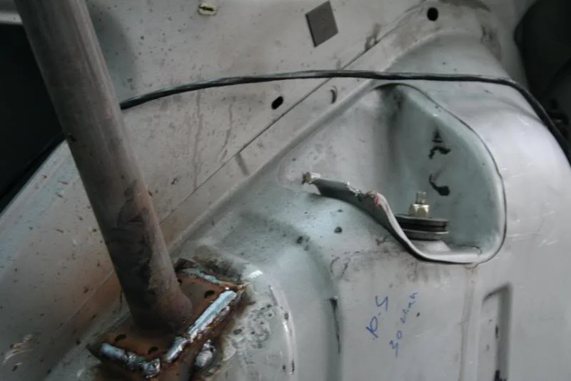

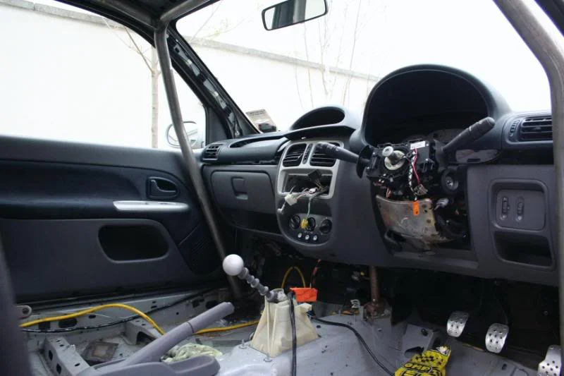

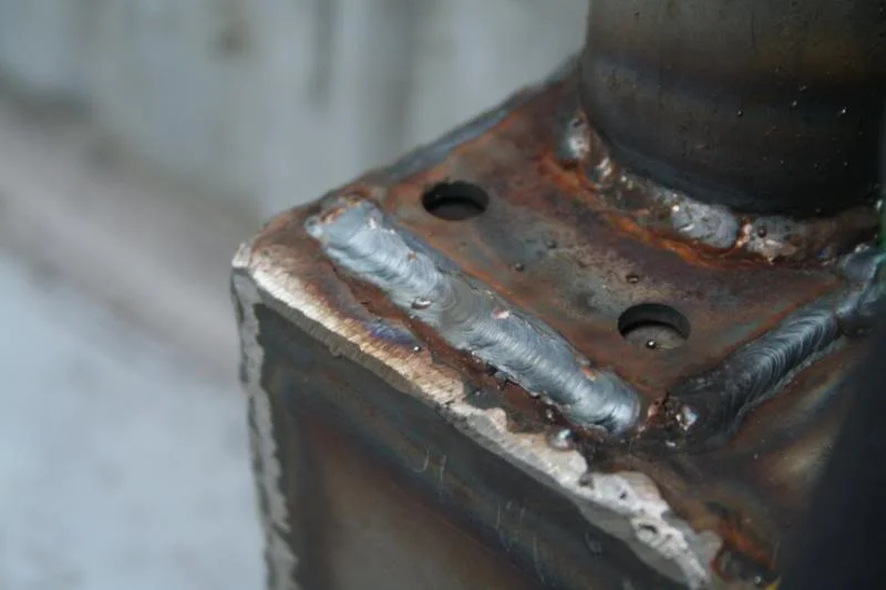

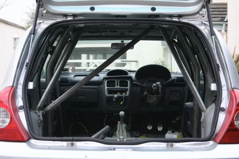

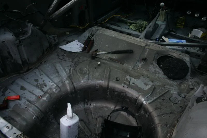

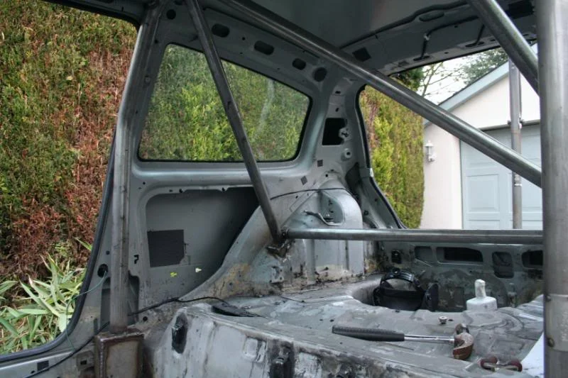

The cage is only about 70% in still needs door bars on, harness bar, main hop support etc but the fit was s**t, took me 40 hours and 12 cans of gas, 5 grinding discs and a huge sheet of 3mm steel. f**k knows why OMP give you mounting brackets as they dont even fit! I couldn't use a single one so had to fab them all, plus the cage was too short all over leaving a 3" gap between the bars and roof etc so had to make front and rear feet to accommodate for that.

welding skilz .. fred dont even start.. its not 50% finished!
Pics of cage
where i want the harness bar
where i want the main hoop support

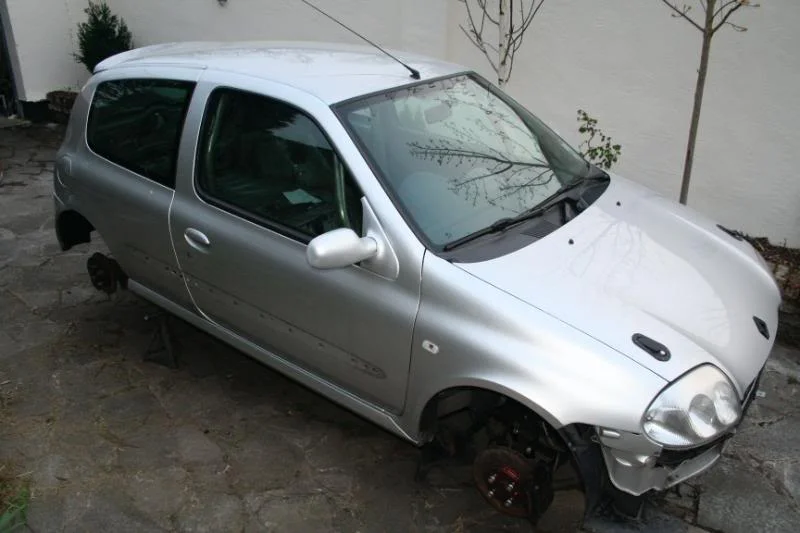

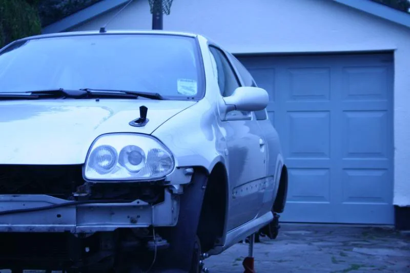

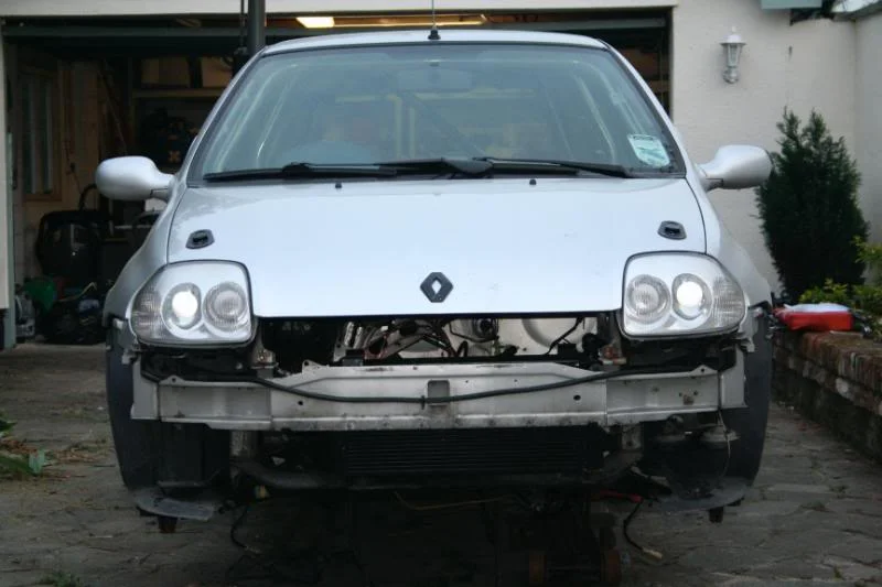

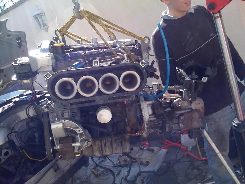

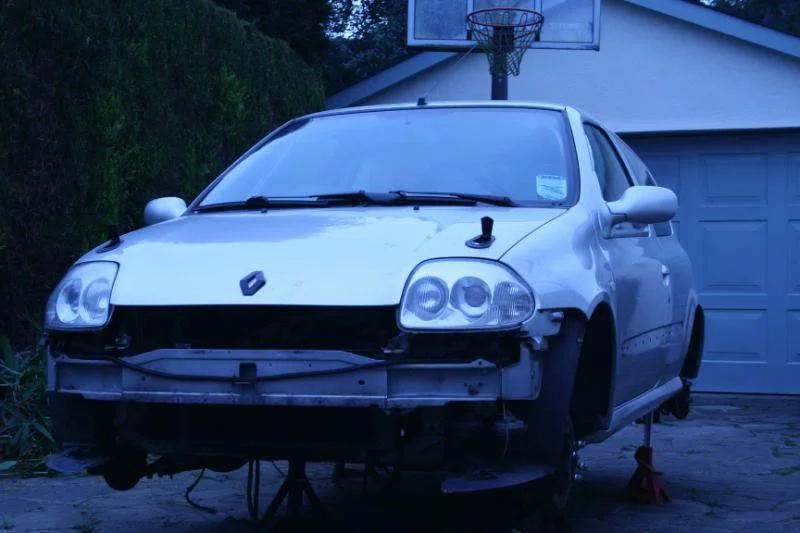

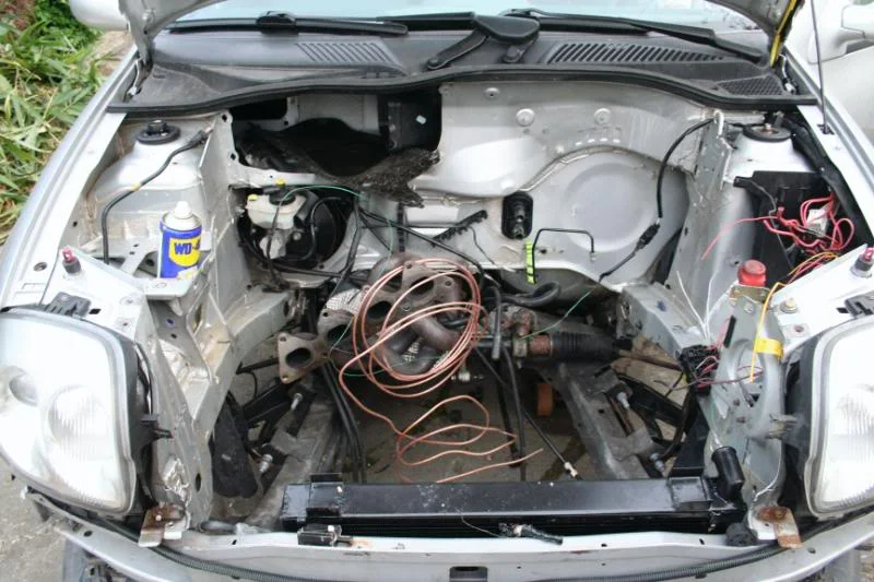

engine gone

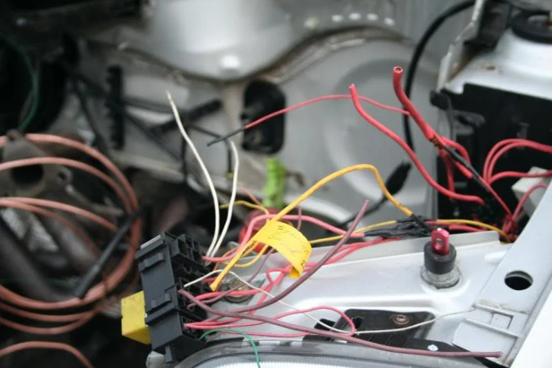

old loom chopped out with bolt cutters :cool:
new stealth and 182 de-cat link pipe

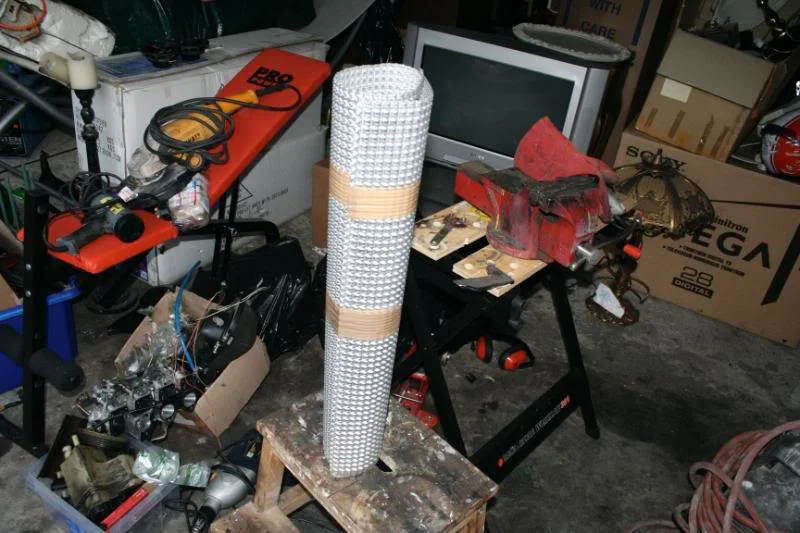

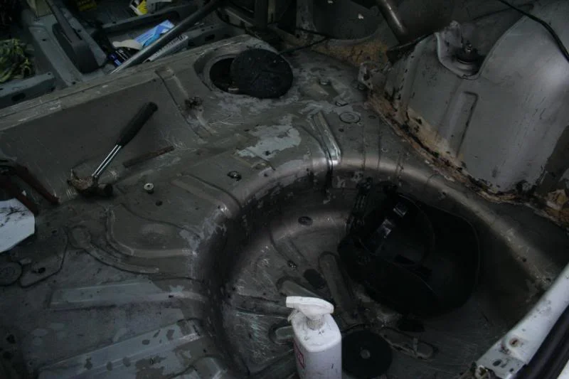

25 hours later and the dynamat has gone...oh and the prime and glav..lol

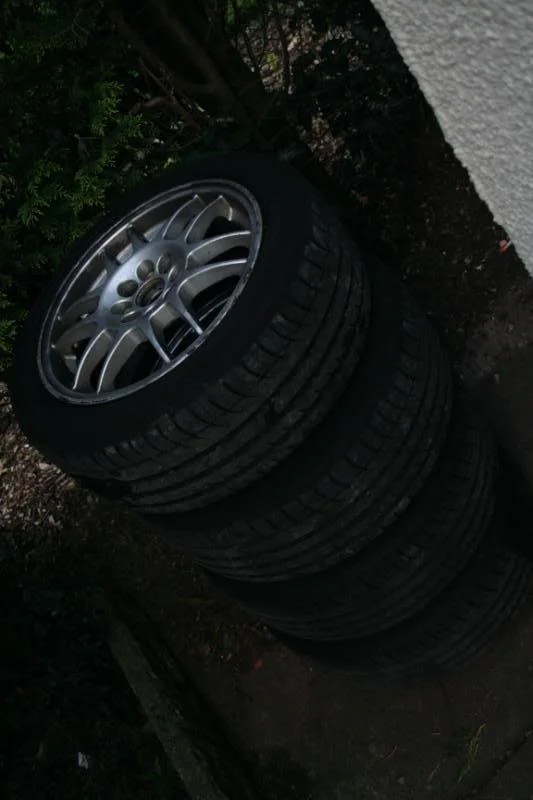

bought some OEM wheels

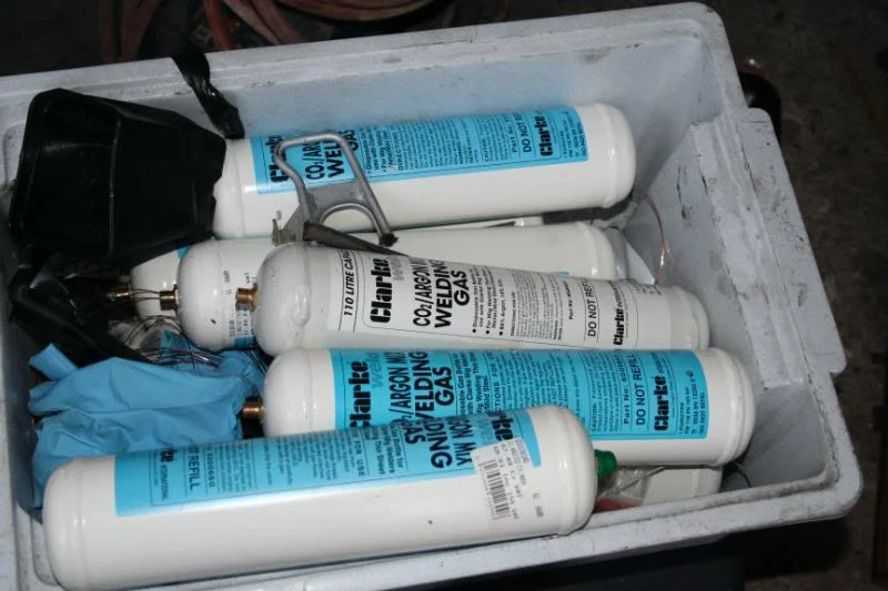

9 dead cans of mig argon gas lol
new omex loom as the old one was pissing me off

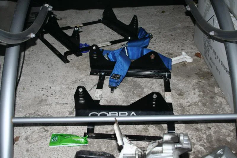

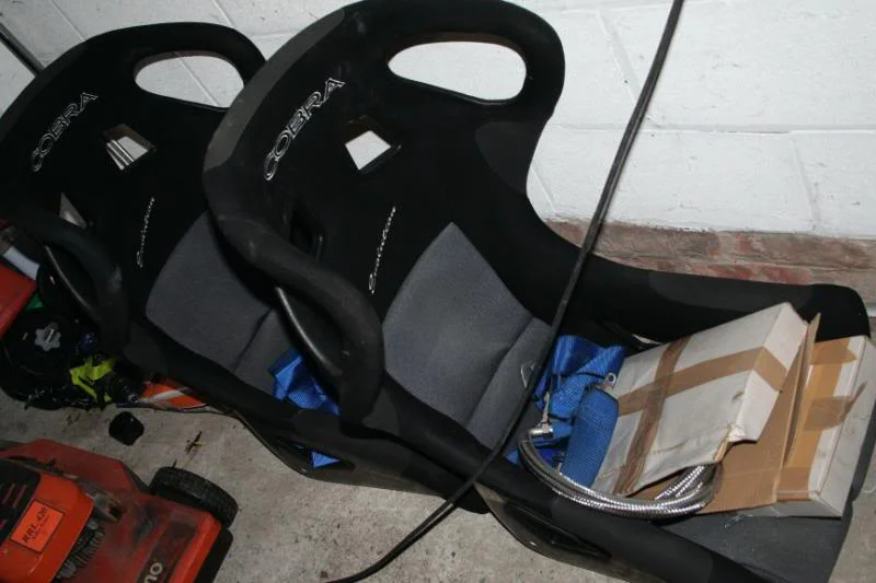

New seats (evolutions in kevlar)

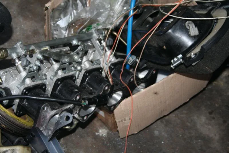

jenveys

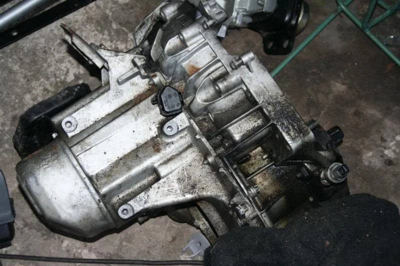

fucked gearbox

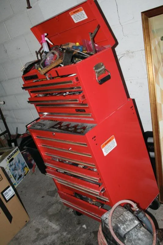

tool box gets opened again!

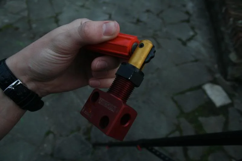

tilton bias valve
old engine out

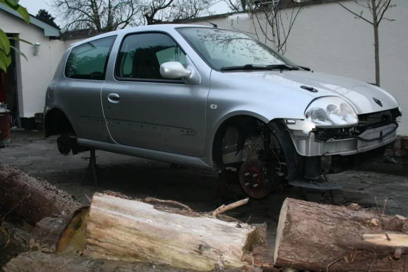

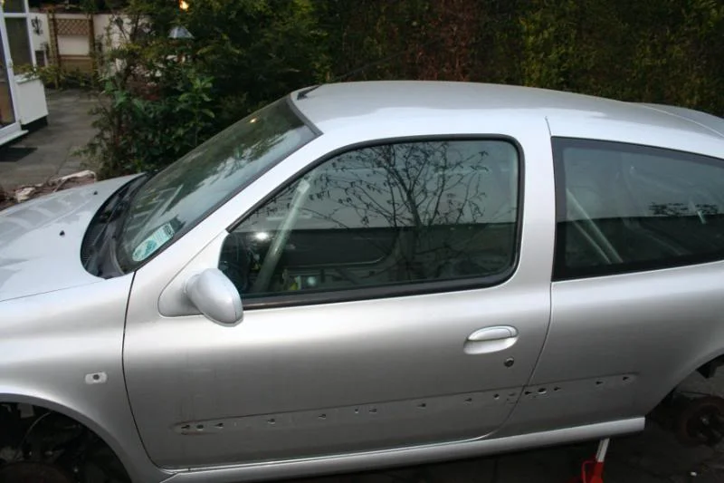

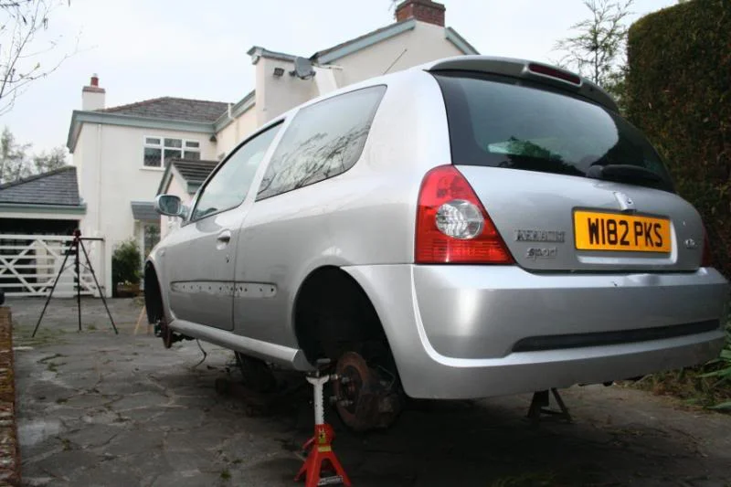

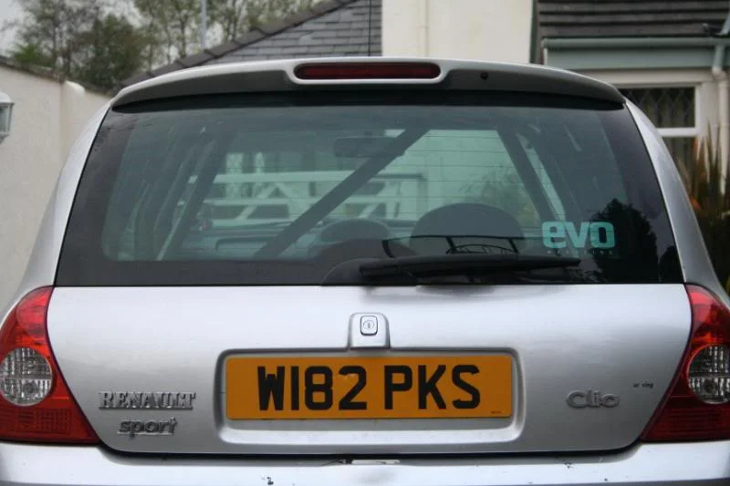

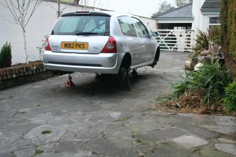

Randoms of the car

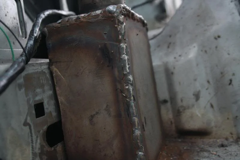

Brave pending completion in 8 weeks but I'm no welder but the one's on the Roll cage worry me slightly
  C63 AMG, F430 & 172
Na there reet! the guy next door has worked with metal for 30 years and he said there not the tidiest but there strong as f**k lol.. a bit ott he thought :cool: there not finished yet, most are just spotted in places or a quick beed has been run to hold it in place

really like the look of this mate. is this the omp cage?
Yeah OMP 105/220
Dont buy one unless you have about 40 hours of spare time to fab stuff up and make it sit true and level before you can even begin to weld it! :mad:
  Tesla MP3 2021
Yeah OMP 105/220
Tell me about it. What a fooking joke lol

fit the new brake lines and bias valve (removed the ABS)
