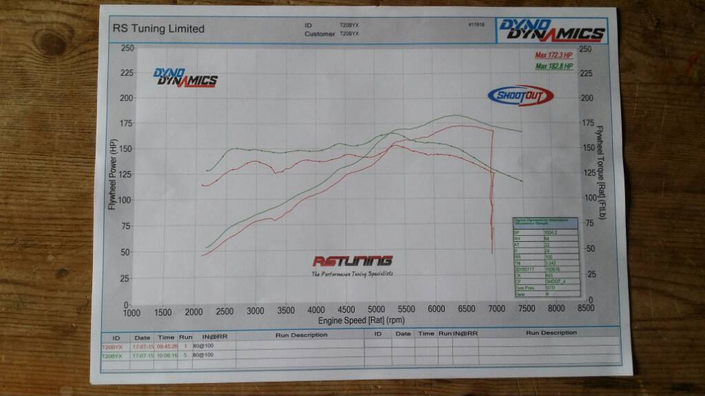

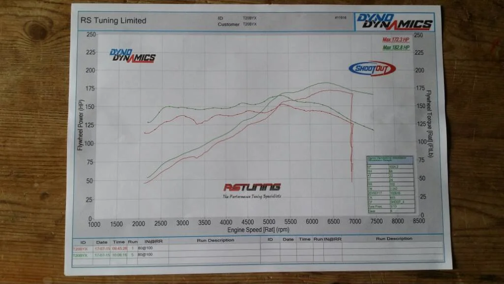

To be fair, and in conclusion to this thread I decided to go to RS tuning and get a proper remap. I'll attach the graph but I'm sure it speaks from itself.
I don't personally believe an RS Tuner map is anywhere near as good tbh as the amount of times he tweaked it and amount of power runs proved the base map just didn't cover as much as could be gotten out of the engine.
The car ran 172 and after the first map, the base map, about 176. So I gained additionally to that another 7bhp proving how much better the proper map is so to speak. When you're not going mad with power I thought I'd be best to make the most of what I had so was dead happy with pretty much 183 bhp, with exhaust mods and an induction kit!
