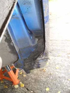

Whipped the wheels and arch liners off to find the sill full of mud
Cleaned this out, hopefully it'll solve the soggy carpet under my seat.
