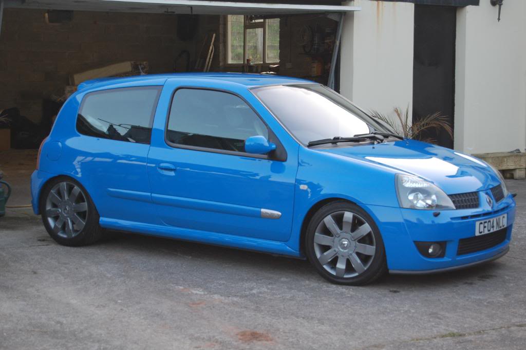

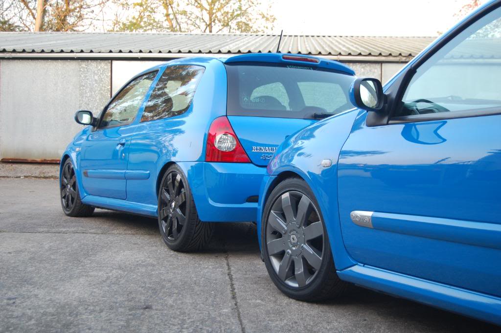

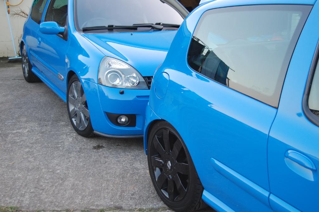

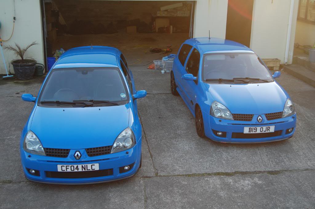

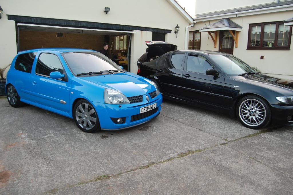

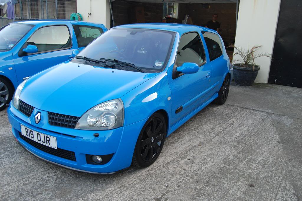

Huw spent the day going over the clio started with a snow foam, hand wash, clayed, washed again, paiint corrected, 2 layers of sealant and finally 2 layers of wax. I may have missed something out. The results are amazing - thanx to huw and owen for the work.
  Glanza V

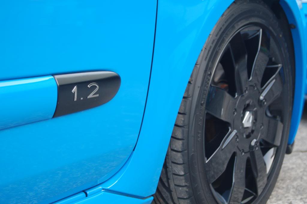

great work fella :) both look great i especialy like the 1 with the black wheels it makes a change seeing black on rb :D 1.2 badge ftw hahaha

looks stunning with you, was there a lot of swirling on yours,mine is in need of a detail will huw do mine lol

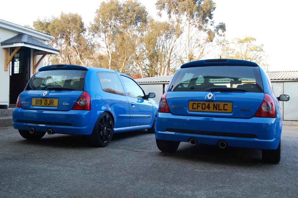

Guppy - it's ridiculous tbh! Cat is still in place, how the hell people decat YS 'zorts is beyond me! Gave me a b*****d headache.

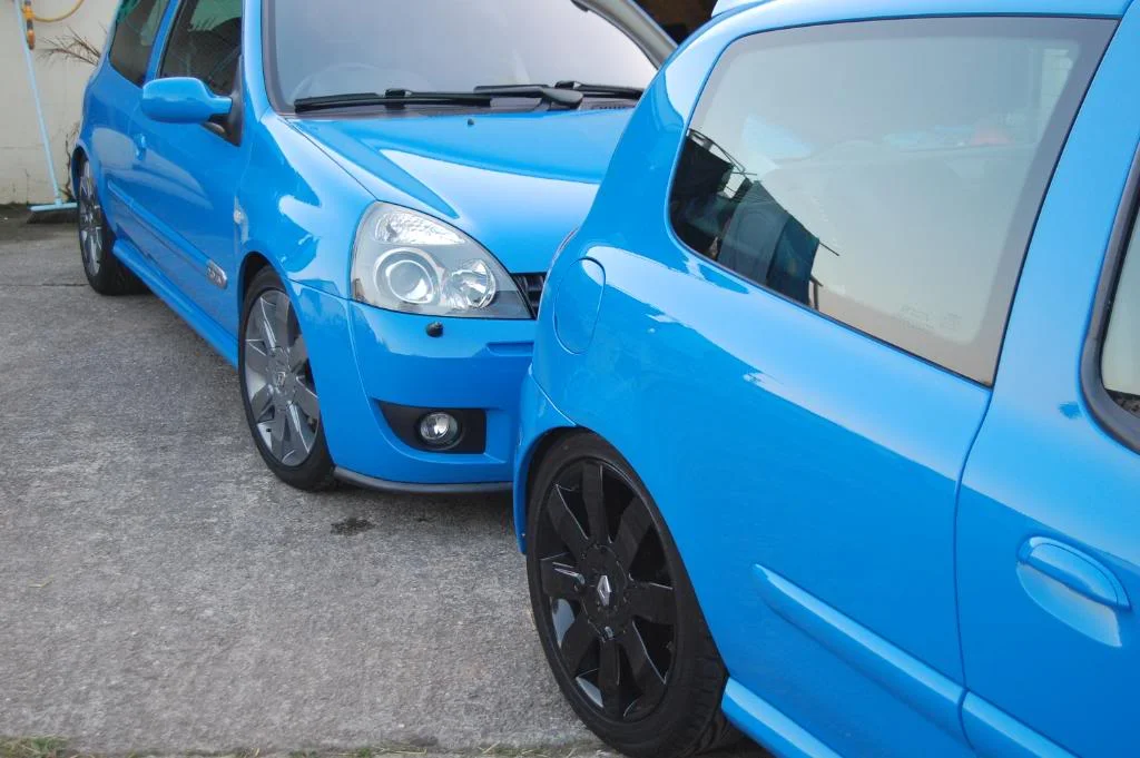

Not sure how long it is going to last on the car, ha ha. Dan's prospeed is spot on looks and sound wise.

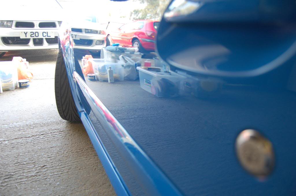

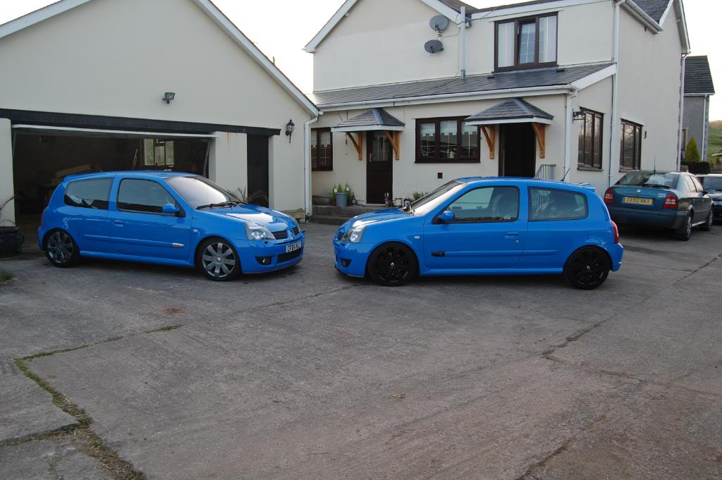

Amazing to see how much lighter Dan's car looked when we applied Collinite to his compared to mine with Dodo Juice Blue Velvet on it.

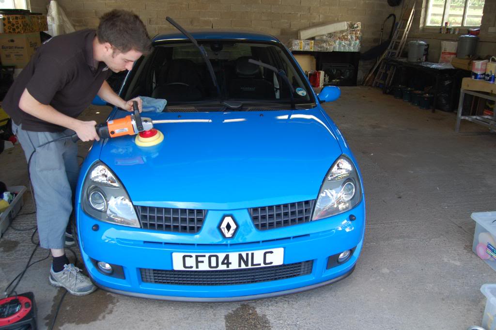

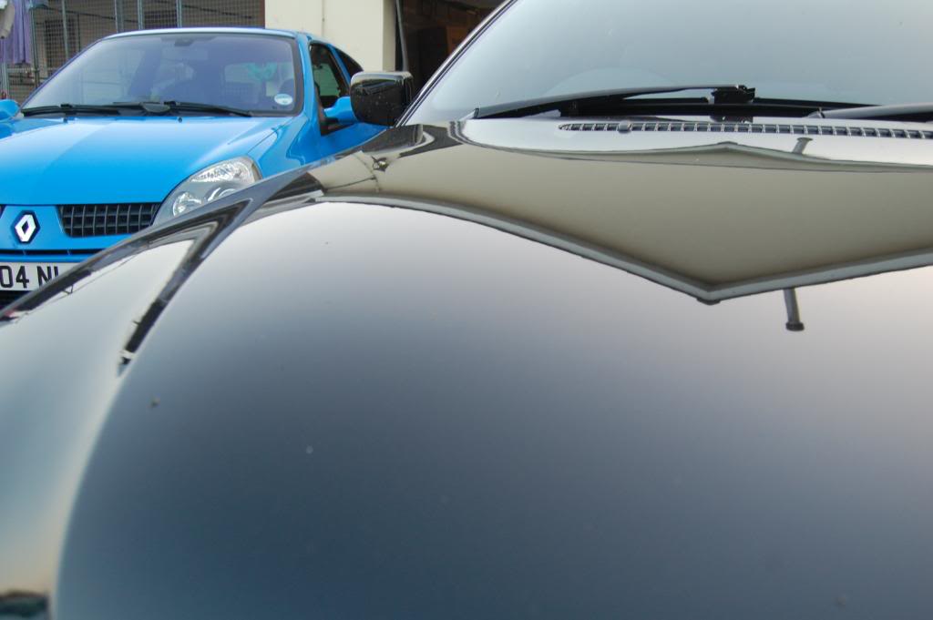

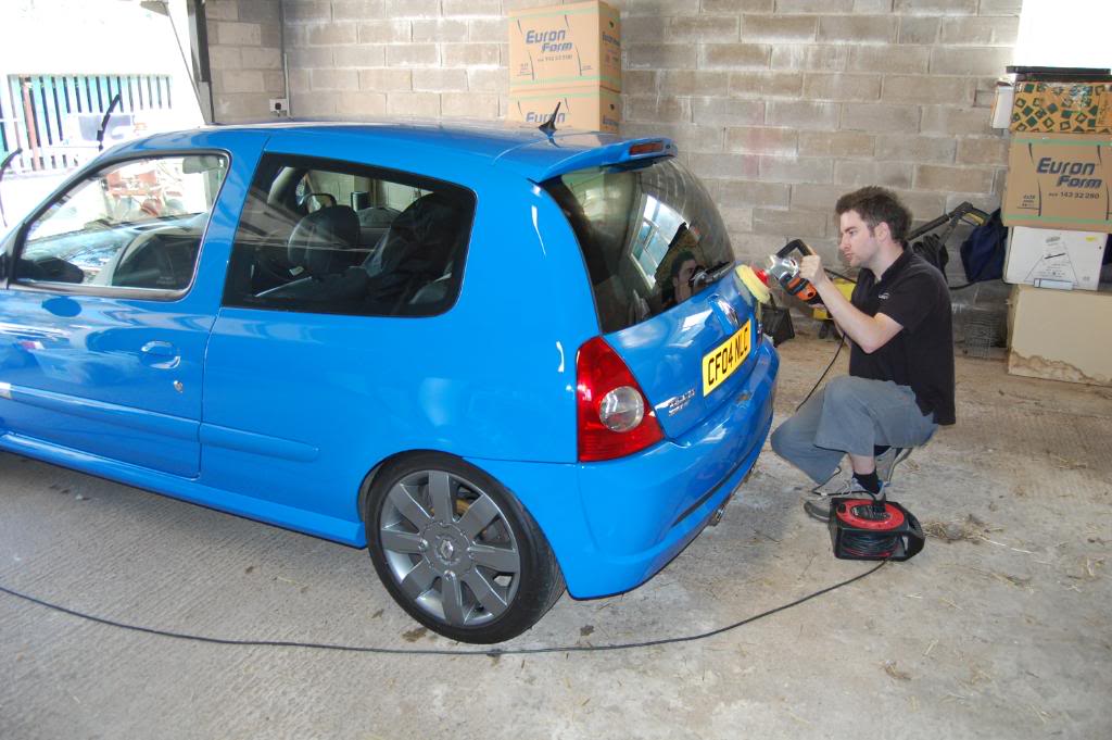

I believe it was polished using a Rotary with a yellow 6.5" CCS pad/PC with a yellow Sonus SFX 4" pad and Menzerna Intensive Polish.
Then applied Megs Cleaner Wax, two layers of Jetseal 109 sealant and finally two layers of Collinite 905.
