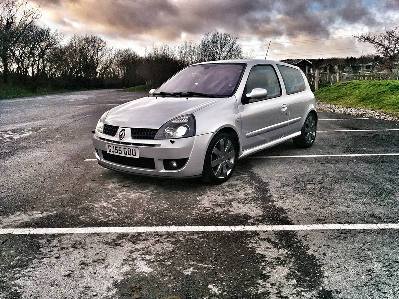

My Iceberg Silver 182FF
Been six months since owning the car, new to the forum so thought I would start a project thread to share what I've done and what I will be doing to the car!
Its a 55 full fat and just covered 70k miles and is very clean!

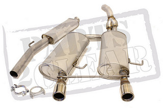

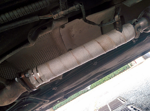

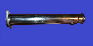

So far I've replaced the exhaust mounts and standard exhaust for a stainless non branded one off eBay as the original one had rusted through in multiple places, looks OEM but is of a much higher quality and sounds a fair bit louder and deeper than stock. I also yesterday fitted the cheapest de-cat pipe I could find on eBay (40 quid) not sure if I like the sound or not yet, at medium revs sounds kind of 'hollow' so will try heat wrapping it soon to see if that changes anything. Also fitted cheap eBay chrome indicators front and back and replaced gear knob insert for an engraved one as it had worn.

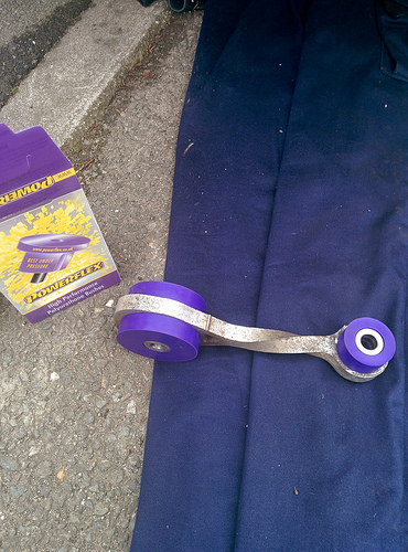

Powerflex dogbone bushes and a 200 steering wheel! Will post about them here once fitted and will record the process of changing the wheel over.

Looks really nice mate very clean! Also it's titanium not iceberg silver :)
Some xenon washer blanks and a 3/4 number plate would really finish off the front end
Looks really nice mate very clean! Also it's titanium not iceberg silver :smile:
Oh! thanks for letting me know haha, just looked it up, didn't realise iceberg was for 172s and titanium was 182s! Any way I can change the thread title? :smile:

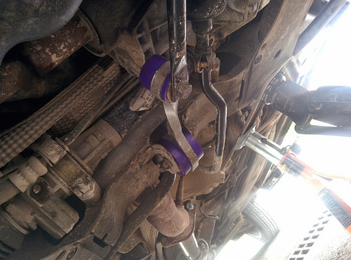

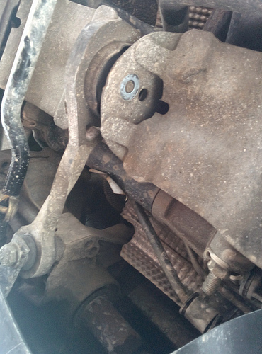

Powerflex bushes came this morning and have just fitted them, took just over an hour, not too difficult a job!
Before:

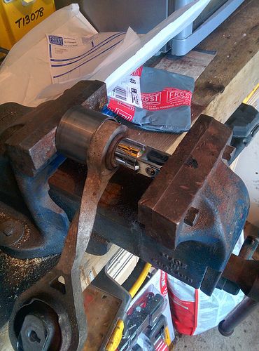

Pushing small side out with a vice and got the big end out with a hammer. Fitting new bushes was easy, took the metal out first, put in the plastic bits then pushed metal part in last with a vice:
Fitting was harder than taking out, used the grease supplied to help it go back in and had to take off skid pan and loosen the black rod underneath the small bush to fit:
Very pleased with it, was expecting more vibrations from reading up on peoples experience with this but its hardly noticeable, gear stick is lovely now, hardly wobbles at all anymore and makes the car feel tighter!

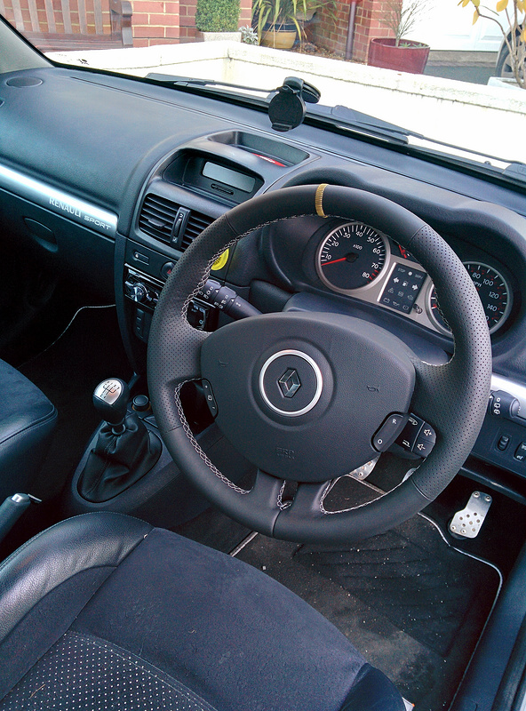

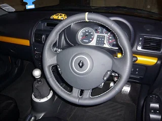

Wheel came this morning, took my time and it took around 3 hours and am very pleased with it on the whole! much nicer as the old had lots of melting and looks crap. Thicker than the old one and I would say a much more comfortable wheel to hold, sits closer than the old one which I think is a plus although reaching the stalks with your thumbs still on the wheel is a bit of a reach.
Installing is quite easy, the horn is the exact same connector so that didn't need any modifying, cruise control ends had different connectors but they work the same so quick solder job. One of the airbag connectors plugged straight in and the other needed a small bit of plastic cutting off to make it fit.
So here it is, a 200 wheel, previously in a V6, now in my 182! :smile:

Very nice mate, the 200 wheel looks slightly smaller than 1*2 wheel. I bet it's much better to drive with.
