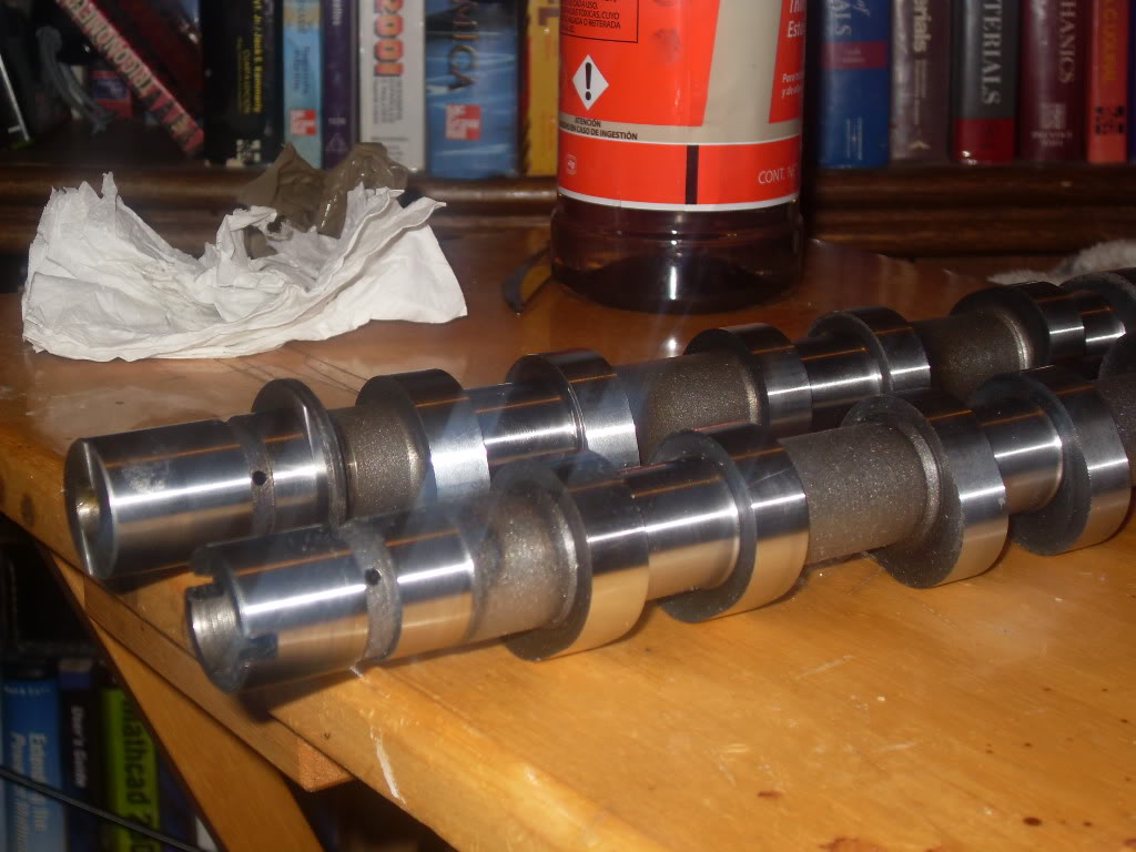

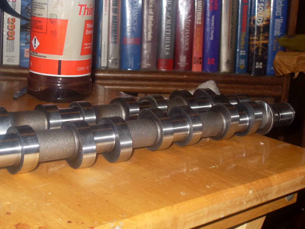

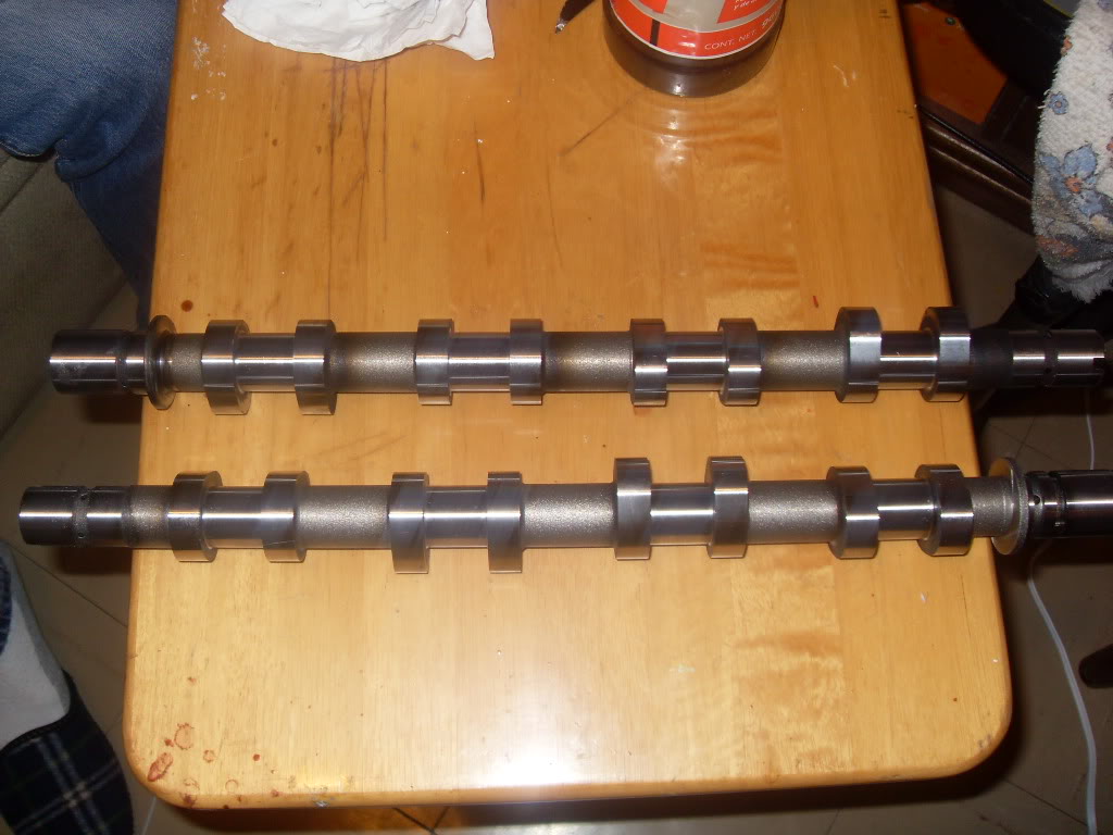

Well, I have recieved the engine dynamics cams today, they look very well made, finish quality is really good. Will take pics and post them here. Next is the installation bue I still have another 10,000 miles to go.
  Renaultsport Clio 172

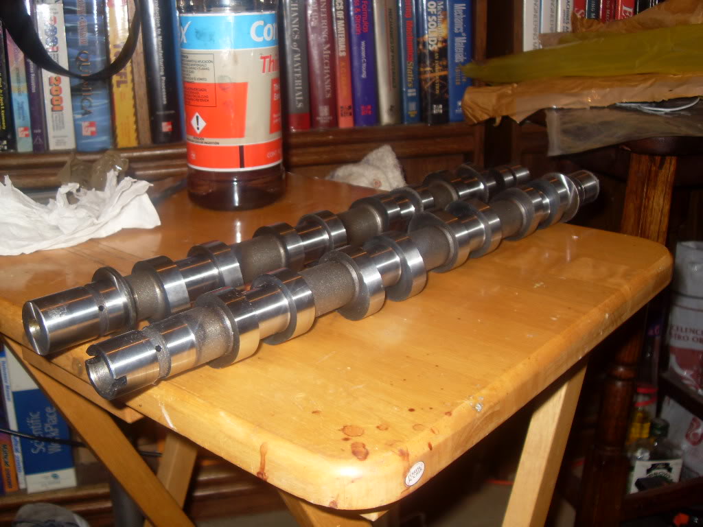

Here the photos

Will be intresting to see how good the castings are.
And explains the price difference between these and Catcams, which are billet.
As for the work required, if you are capable and wouldnt find it too much trouble, id see it as an oppurtunity to whip the head of have the seats re-cut and the valves refaced, and definately check the guides for wear.
Thanks for the advice stan, I will check those while it is in bits to see the engines condition.
Any way to check castings? I know what you mean as they have been only machined at contact surfaces so there is a chance they aren't balanced? But if the castings are well done should not have issues, should I?

its not so much the balance I was specifically reffering to, more the quality of the casting in terms of materials used etc which lead to the overall longevity of the part.
im sure they are fine, i was more just rationalising the price difference to myself outloud!

I'd want to fast idle those on first start as they're cast, just to be confident in the surface hardening, they'll wear very quickly if they're not correctly hardened and you dont treat them the right way. You dont have to worry about that with Billet
What you mean by fast idle? like leaving the car just sitting there at 2,000 for a while and then check?
I was doing some reading and found that hardness should be from 52 - 58 Rockwell C. I work in a Ford Assembly Plant and we can check the hardness. We will see.

Stan, Dany
They are not castings, this is what I was answered about material and manufacturing method.
Hi Mauricio,
They are Forged steel, this means they are forged to shape then machined to finish, not cast.
I have now asked about hardness, though I should be able to measure tomorrow at the Plant. However, forged steel is pretty strong, isn't it?
  2005 Nissan Navara
They look very much cast to me. You can see the roughness on the non-machined areas.
chill-cast cams are machined from a cast billet, not a drop-forged billet. Thats what they look like.
There is nothing wrong with chill-cast cams at all.
My concern was about "cheap chinese" cams, which will be cast but to a lower standard, greater impurities, higher chance of fail.
Im not for one second suggesting thats what these are, I was just making an observation.

About Hardness ...
Hi Mauricio,
Specification for hardness is 52 - 55 HRC
Andy
So not to have problems going by the specification.
  E36 M3. 182
Irrespective of what hardness they are, surely 20 minutes of your time isnt a big ask to avoid the (as small as it may be) risk of shagging your new camshafts.........

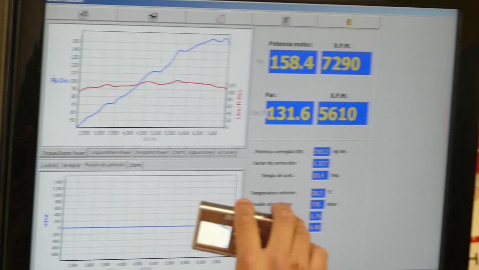

Well, after a few months I manages to install cams and also the mapping is going thur development at the moment with Henk, although the car hasn't been completed yet (mapping wise) I got the car on the rollers and this is the outcome, I am not going by the numbers, but the curves I don't like. Is this maybe because it isn't fully mapped yet? What you think?
I must say I have raced another clios and mine is faster so i don't think there is something wrong with it, or so me thinks.
C&C please!
