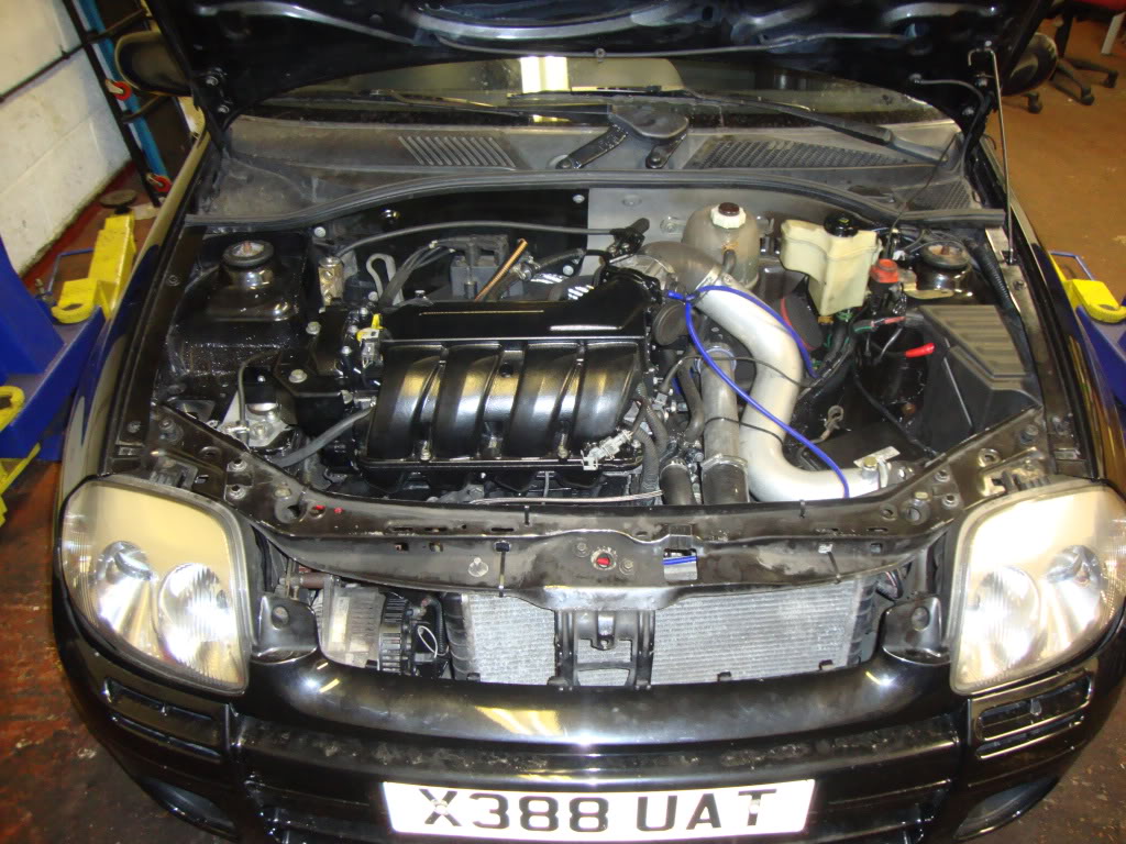

Im after a list of parts for my new engine build. need advice on what parts and best place to source them from.
so far i have (on the list)
Garret gtx3076 turbo
Tial 40something mm wastegate
Mainifold/Exhaust in 3" tube
powertec valves
k tec oil feed
intercooler of some description
Injectors not sure on size
ARP bolts and studs
That leaves me with
Rods/pistons that will allow 8.5:1 compression ration
complete set of bearings
cams
gaskets
And probably other bits needed that i cant think of at the moment. thanks in advance

I am not a fan of these, I would go for a 3071 instead, the 3076 is a bit compressor heavy and a 3071 will still happily do that power output.
If you are running nitrous like you mentioned before then go big on the W/G
Sounds fine, if you go much past 600bhp you will need 3.5 though.
powertec valves
Never heard of them so cant comment, but ideally you want one piece inlets which can be in something simple like 214N and then you want inconel on the exhaust, ideally one piece but a 2 piece cheap welded futher up the stem than normal like supertechs would be ok.
k tec oil feed
I'd just get something made up to suit once its all bolted onto the engine rather than buying off the shelf stuff that might not suit where you mount the turbo.
I would go for a custom one made from the latest garrett cores, they are super efficient so it doesnt need to be massive that way
You will want 750cc or bigger really, I wouldnt generally go 1000cc for 600bhp just to be on the safe side
ARP bolts and studs
The bolts should come with the rods, but yes I would buy the stud kit for the head, in fact I even used them on my mrs daily I like ARP products so much, plus the standard renault ones are junk that like to fracture the head off when undoing.
That leaves me with
cams
gaskets
8.5:1 sounds ok to me.
I personally would avoid the standard inlet, I dont like the join in the middle that has to keep be broken for getting to the plugs (you will want to get to your plugs often on a 600 horse motor!), it will be a pain keeping it sealing properly with a couple of bar of boost up it.
What gearbox are you using?
  182/RS2/ Turbo/Mk1
ring Paul@ RSTuning
Scoff would be another good person to call who has done it specifically with this engine, although TBH its not really rocket science getting a blown motor to do 250-300bhp per litre anyway really, just a case of having some deep pockets!
  big boost cup
I have had an email back off scoff about the turbo and he recommends that one for that power as it wont struggle to make that power.
supertechs where what i was thinking off lol. Will look into intercoolers a bit more not researched them yet.
so 750cc upwards on injectors. I have been looking at the 197 inlet and retro fitting it seems to be a reasonable amount of work. but seeing as im going all out then wont be to much of an issue i guess.
Gearbox is an O2M 6speed with an unsprung clutch and associated parts. So should be up to the job
  182/RS2/ Turbo/Mk1
If fitting the 197 inlet, just use a 197 head as well, dont try and fit it to the 172 head.
Interesting that me and Scoff disagree on the GTX3071 vs GTX3076 as from what I have seen we tend to normally agree on most things, but the difference is fairly minimal and both will do the job at the end of the day, I just find the 3076 slightly more laggy without really any gains in power that would be relevant to your build, but its still a good turbo.
172 bottom end 197 head and inlet will this not change the compression ratio? was also thinking that because of where the TB comes with the silicone hose its going to be right next to the turbo as im mounting it over the gear box ecu area
  182/RS2/ Turbo/Mk1
Yes of course, but you havent bought the pistons yet have you? So just buy them to suit.
Yes that might be an issue, although its very high up so might be alright.
  big boost cup
i guess i could ditch the silicone hose until its clear of the turbo and use some heat shielding on a metal tube. with some flexi joiner type thing to join between tube and TB. this is going to be one epic learning curve :eek:
  182/RS2/ Turbo/Mk1
TBH mate, worrying about where the pipework goes isnt really the place to concentrate at the moment, you can always get the manifold altered if you have to, but I think you'll be fine anyway.
  182/RS2/ Turbo/Mk1
Would be a piece of cake to put a 90 degree bend on that and keep it running up high next to the bonnet then not drop it down till its over where the battery normally sits.

why don't you just make a custom mani? when using a 197 the CR will be even lower so you'll get stuck with finding pistons...
If he wants to be about 8.5:1 he wont have a problem, as he will be about right using a 197 head and a set of aftermarket 9:1 F4RT pistons, with a bit of skimming or careful selection of gasket fitness he should have no problem getting to where he wants to be.
I will pull mine apart soon though and CC the head just to get the actual figures though rather than having to say "about" etc.

I do agree that a custom inlet would make a lot of sense though, something along the lines of an RS2 would be ideal.

Those were 8.5:1 when used with a 172 head, they will be far lower when used with a 197 head, you need to pick pistons for a higher CR than you want to end up with if using a bigger chamber head.

His engine is forged, turbo is a different compression ratio so will need to be done again.
Shame you are not selling your engine now tom, I would off had that. What time are running with the nitrous at the moment mate, you know it still won't be quick enough with 600, once you get power crazed no amount of power is enough.

its ran a 12.2 with no nitrous should go mid to high 11s with a 50hp shot

im in two minds regarding the head situation. it all comes down to being as cost effective as possible really. i think i will end up with 197 head and the jenvey plenum or something similar.
Would be good to find out the cc from you chip.
  182/RS2/ Turbo/Mk1
If you have the 197 head you may as well use the 197 inlet surely? If you are going jenvey plenum you could use the 172 head anyway.

correct but its not a daily so it be fine only going to be used on track
Do you mean a track or a drag strip?
Cause TBH even on track you wont use that power very usefully.
Drag strip is about the only place for it, and even then you probably need to be on drag tyres to make it work well.
  182/RS2/ Turbo/Mk1
Jenvey plenum won’t fit on the 197 head will it?
The plenum arrangement is modular, so any head you can get a base manifold for, you can get the plenum to fit, so just a case of finding out if they do a base manifold for that head.
