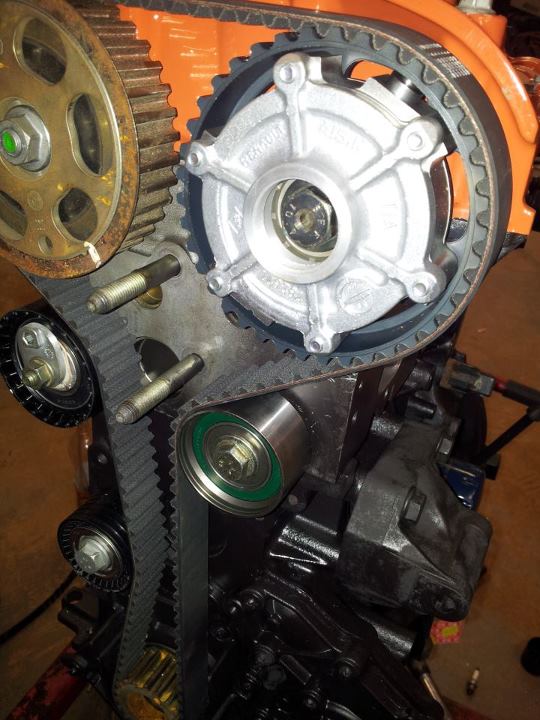

why if Ilmor yada yada yada were involved with it is the cambelt tensioner still fitted wrong?
Wrong as in non standard?
If its tensioning the belt properly its not wrong IMHO, its just modified to suit their purpose.
Like for example when running a very thicker head gasket to decompress the F4R I know that Mike from MWM alters the belt wrap so he can still us the same standard belt, but it doesnt cause any issues to do that.
So potentially if they are on a taller block, or a skimmed head, or a different thickness gasket, they be doing a similar thing.
  Lionel Richie
look at it again, looks like its been tensioned wrong, i see it all the time! people think the hex is supposed to line up with the marks LOL
oh and chip, i do it this way ;)
  Lionel Richie
well it is when the tensioner is boucing off its stops, which it will if its not perfectly centred on its markings! Check the ratio of movement between the front side markings and the rear stops, you'll be surprised ;)
  182/RS2/ Turbo/Mk1
Maybe that actually want to limit its movement though?
Plenty of high revving engines out there that swap over to non auto tensioners, maybe thats specifically be done as a halfway house?

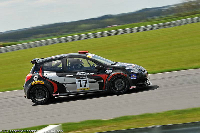

Been doing some research (thanks google) and it seems Tony Skelton runs a clio in Britcar production cup with ashford motorsport stickers up the side, if that car has that engine its not 280bhp judging by his laptimes!

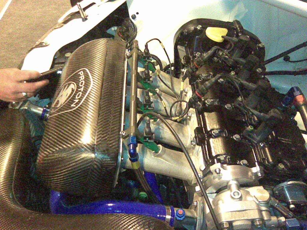

Should think if you want to see good laptimes from an Ashford F4R the best place to look is the proton touring car which uses it IIRC?
  Lionel Richie
na the Proton uses a Swindon Engine of some description i believe, Proton did use a Renault lump in their rally cars but i think that was a Sodemo effort
