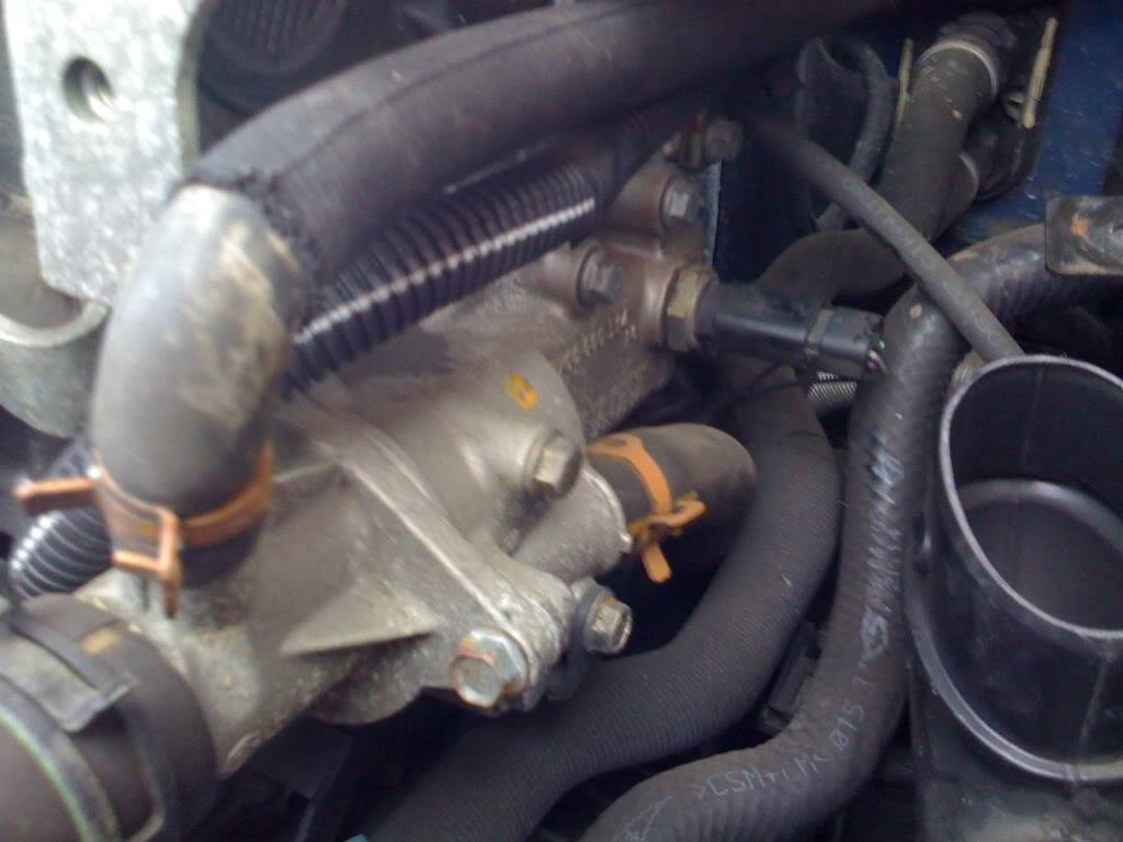

Do you know rough whereabouts of the temp sensor? Might be worth giving that a look at too
  1.2 16v Clio Mk2 2dr
Cant remember exactly , should be on passenger side of the engine just follow the radiator piping and should lead you to 2 sensors , one is thermostat and other one is coolant temp
No worries , managed to find a picture on another forum post that you might find useful. The sensor is where you can see the wires hanging out.
