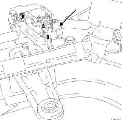

  anything i get
hope this helps , its a left hand drive pic but its in the same place.
  BMW 320d M-Sport
Thanks very much. Is it possible I've smashed this off when I damaged the wheel arch lining? It's on the drivers side (RHD). When I looked with Mark Fish today there was no sign of a box or anything on the front? Been out in the car tonight and must've been flashed by 70% of drivers. Will have to jack it up and take the wheels off tomorrow I guess for another proper look. Sad times. Thank you so much for help so far.
