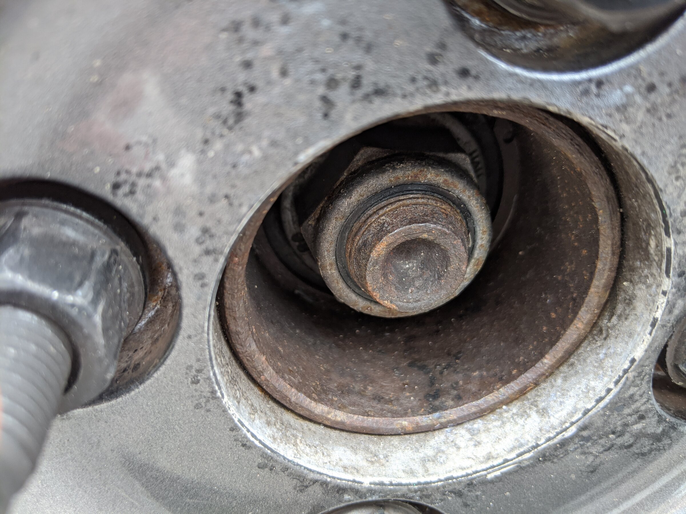

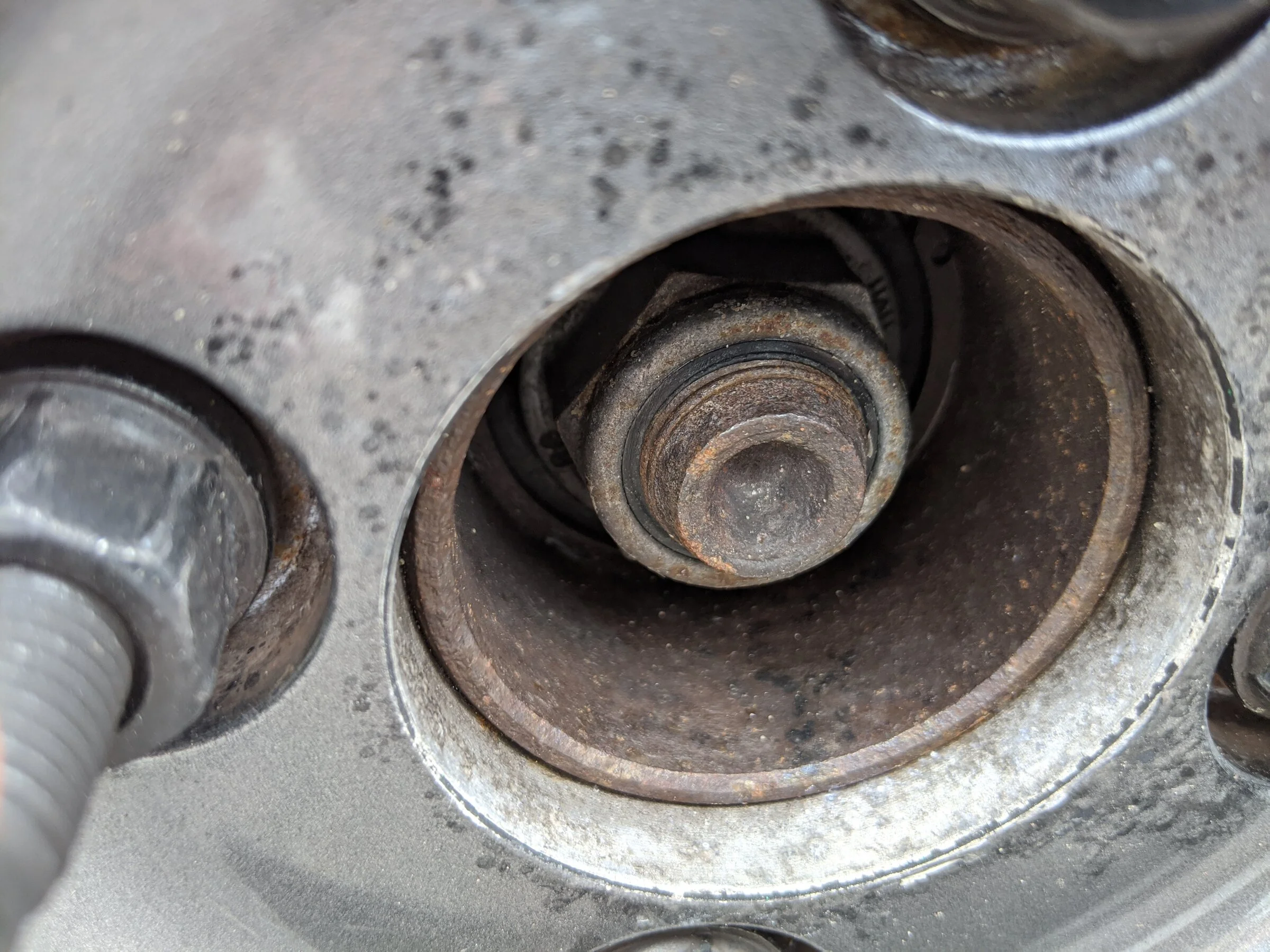

Just coming back to this. I've just checked the hub nut and it was loose and right on the end of the threads. I didn't realise this until I took the cap off and got hold of a 30mm bit
Here's a pic to show how far I've wound it on the threads does this look about right or do you think it's missing the spacer?
Thanks

Ol’ Tarby
  Clio 220 Trophy
Thanks
Just whip the disk off and check for the spacer. You're already 99% there

Yeah it's alot further in than yours. For the life of me couldn't get the caliper off and managed to brake my ratchet trying so I've given up. Now I can drive it though I'm taking it back tomorrow for the garage to sort it.
It seems to drive OK but I've noticed when taking bends and theirs weight on the wheel it's grinding a bit.
