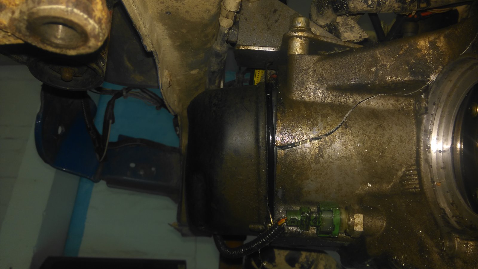

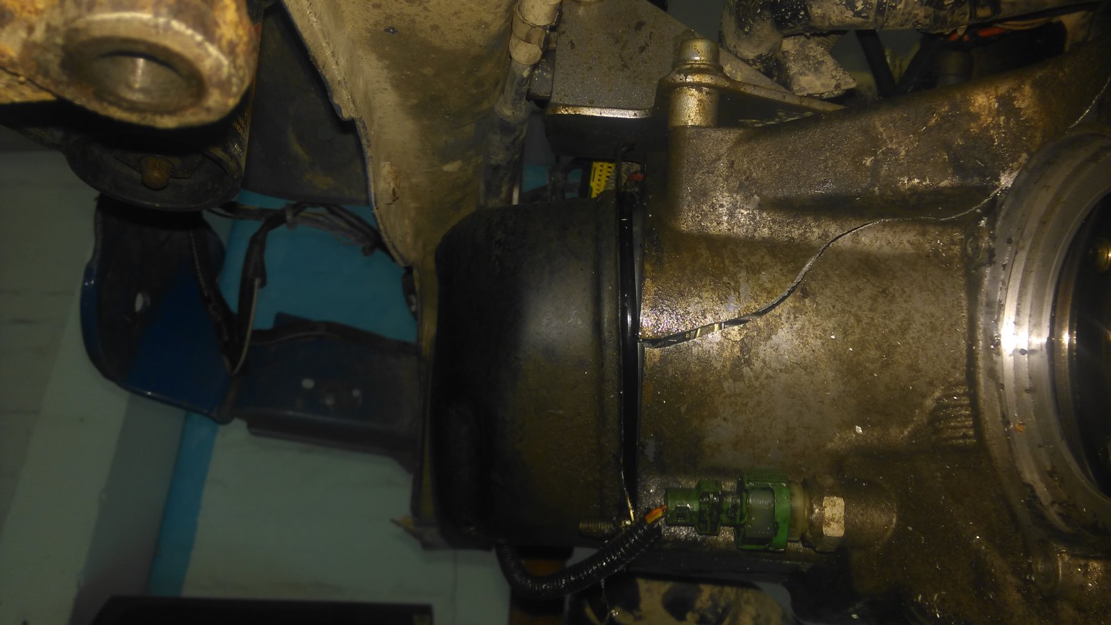

unfortunately done a bit with the jc5
we looked at machining the end of the casing off to bolt a billet end on but the case is crap on them, it's so thin in places it's a joke.
not done anything with the vag box yet, spoken to chris about the conversion and the boxes a few times. you can go for the o2j (?) 5 speed so you can keep the cable clutch but sqs do a 6 speed conversion kit. gear sets and diffs are a lot cheaper for the vag box as well.
