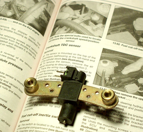

The TDC sensor plus a load of cables are prone to get wet/dirty down there. I'd get the airbox off and have a look.
Check for anything loose/poorly connecting
Is this the one that sticks horizontally out the side of the engine below the air filter?
yep
