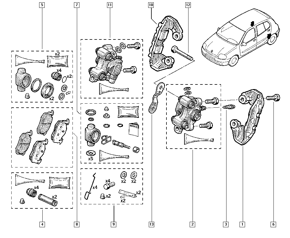

Struggling to find these listed anywhere, can anyone point me in the right direction?
Front ones are no issue to find but I'm told the pins in the rear of mine are worn.
To the point the rear brakes can make a bit of a racket if you pulse the pedal when coming to a standstill.
  Clio Trophy
I've also got a reply on the cliotrophy forum I posted on saying all the mk.2's had the same calipers regardless of being a 182 etc.
In which case there are options on ebay, assuming that is correct?
MarcB
  Too Many
As said mate its item number 4 on that image that looks like the sliding pins and rubber seals.
R/KIT CALLIPER
77 01 201 837 - RRP £51 +Vat (Each)
  dan's cast offs.
might be a bit corroded but it's normally the calliper that oxidises and that pushes the rubbers against the pins and stops the calliper moving.
