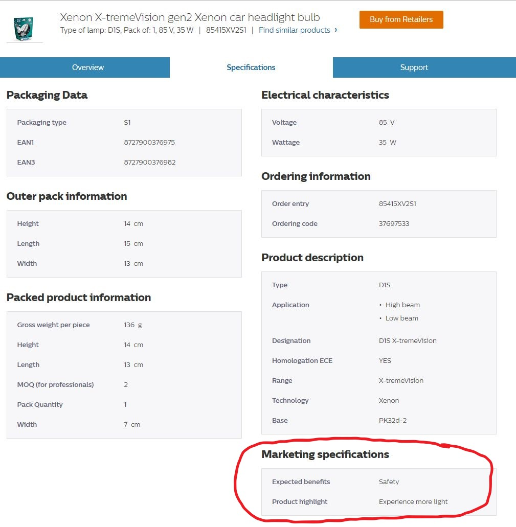

Does the D2S type refer to the connector type or rating or something? I was randomly looking through Philip's website at xenon bulbs earlier to see if they had any supported car specs. I didn't see any car make & model filters, however I appreciated the marketing specifications at the bottom... ?

Phone Renault and ask how much for 1 bulb. Make sure you're sitting down at the time lol . I think they wanted about 90 quid a bulb ? Not sure if the D2S refers to the fitting , but like @mossyv6 said that's what you need and 4300k is oem . I went for 5000k , they're a bit whiter. Once you start to go over 6000k and upwards they become more blue.
