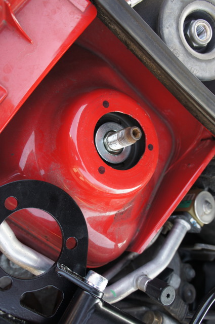

I removed the first nut and rubber washer and loosened the larger nut. I turned the steering wheel whilst the car was on the ground and when I re-tightened the nut and could no longer make the rattling happen. I checked everything again and went for a drive. The car seemed to be ok for half a mile and then the rattling came back. The nuts are all tight when I returned. The pictures show the position of everything now, and it looks right to me. The order of refitting of the parts is spring,spring cup,bearing (flat side down),rubber top,27mm nut (spacer built in).Once on the car the rubber washer is fitted and then the 21mm nut.

The top mount doesn't fit right and rattles because you mix-matched new style integrated spacer/nut with old style top. The old style configuration had a spacer then a small 17mm nut, the old style top rubber stop has a metal cup insert underneath that covers that 17mm hex nut. Using the new style (only one available now) integrated spacer/21mm nut you need to use the new style rubber stop which deletes the cup insert (which is too small to cover this bigger nut) and replace the captive top nut with a regular nylstop nut
Hope everything above makes sense...
Here is an extract from dialogys, hope it clears things up (parts 5,6,7 is old configuration, you have item 9 from new conf, you need items 10 and 11).
