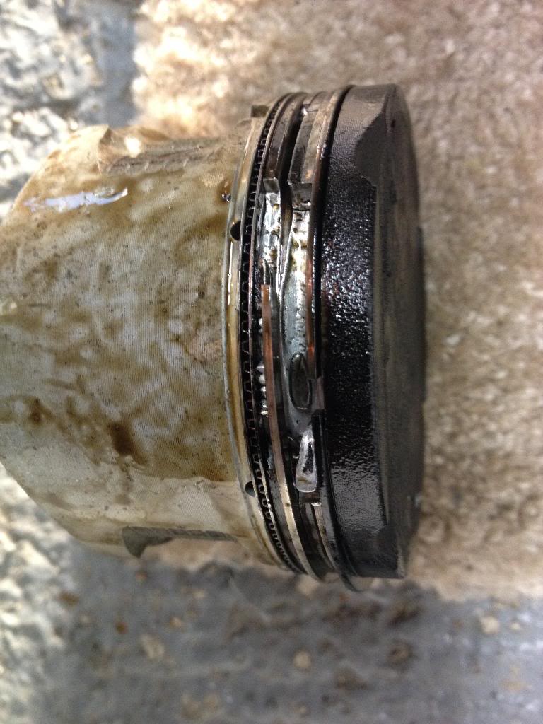

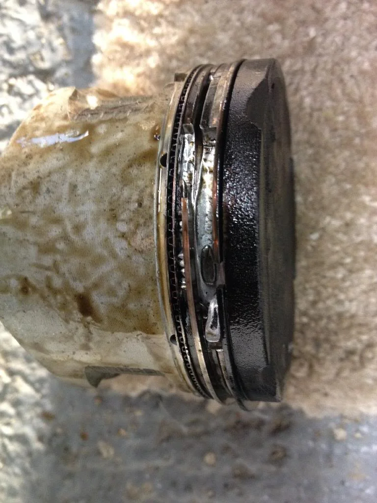

So long time coming but this is the reason for the heavy breathing lol! Prizes etc for those that got it right! Knew it had to be ring area related. The ring land area would seem to becoming a weak area on higher mileage engines.

We knew it wasn't going to be valve guides mate.
So now you can sleep tonight. :D
  182/RS2/ Turbo/Mk1
Well it's certainly done a good job of destroying that piston.
Would pretend to be surprised but obviously anyone in the thread with much of a clue about engines had already nailed what it was going to be anyway.
Choice now is how to fix it. If you just put another engine in it and fit those cams then for goodness sake get it to whoever is closer out of Mwm or rs tuning as ridiculous though it sounds they seem to be about the only people able to map these engines with cams and not kill them.
Good excuse for a more fruity engine build and aftermarket if it's a trackday car rather than a daily.
Or for a cheap option. Lob in a standard engine and put an rs tuner map on it. The cams don't make a huge difference anyway so wouldn't be a big loss.
