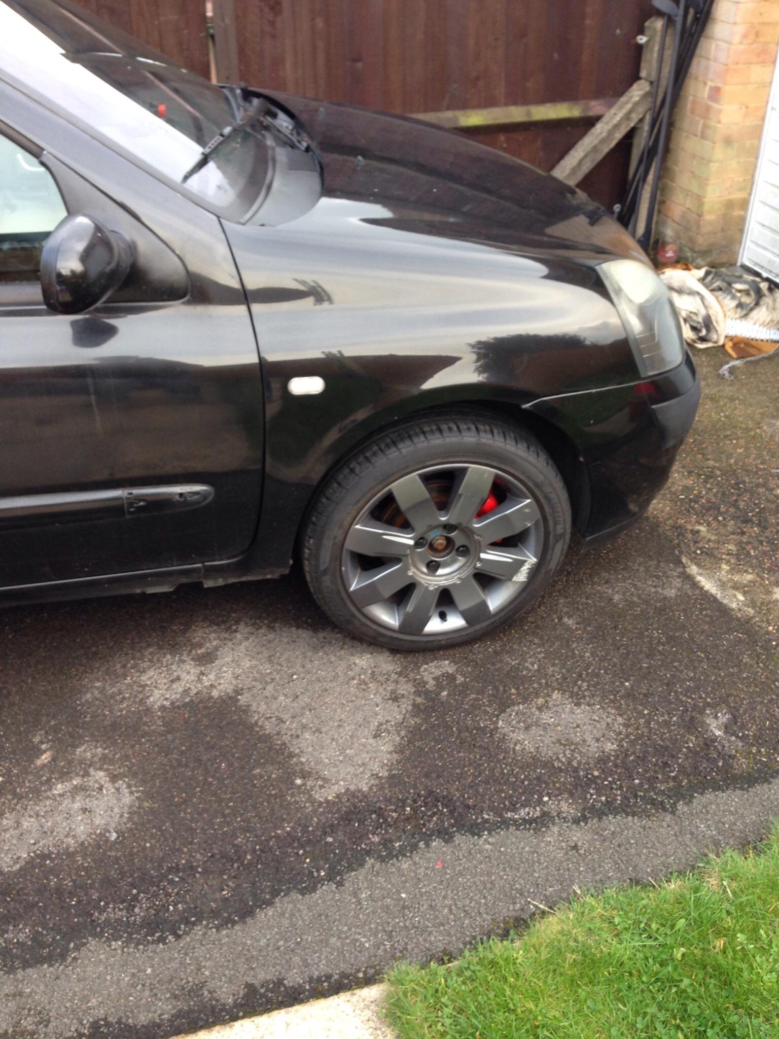

Here are my 182 cup alloys,
I've run 195 and 205. Personally 205 is better
I always thought there might be problems with full locking as they're bigger wheels?
Golly, I do like the darker colour, but the kerb marks really do show :O
