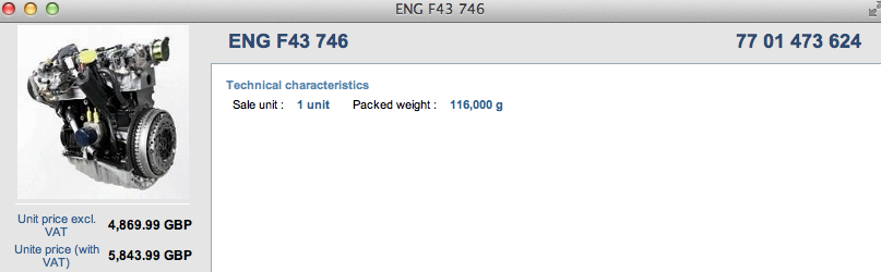

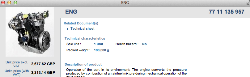

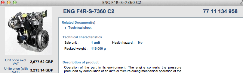

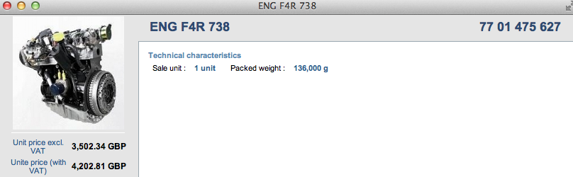

Whats the retail on a new engine? @BIGASH
MarcB
  Too Many
A 172 Cup none exchange is -
A 172 Cup Exchange Unit is -
A 182 Non-Exchange Unit Is -
A 182 Exchange Unit Is -
