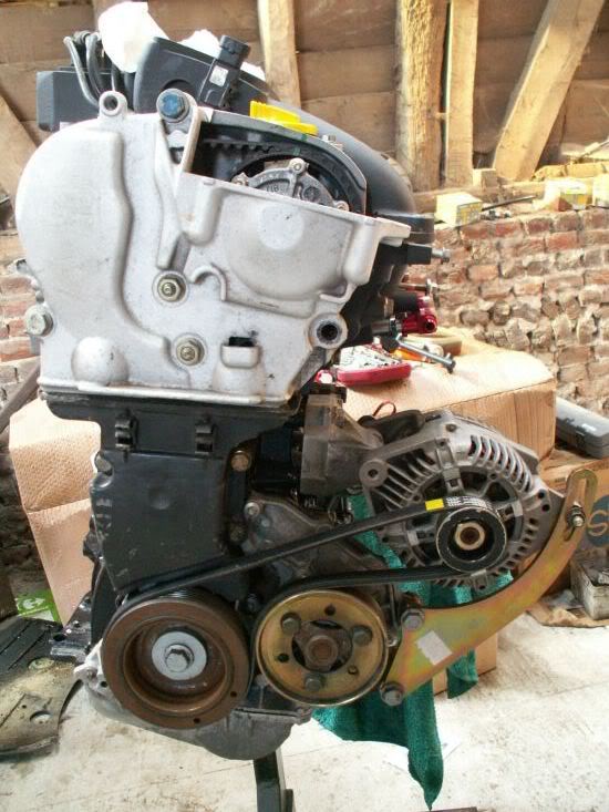

I am after yet more advice with regards to the 172, I have removed the A/c and the power steering so am left with just the Alt, Water pump and crank giving me alot shorter belt run. Now has anybody else done this and what belt have you used?

You want to route it like this, you can get the belt from Renault. I think the part number for the belt is 7700114730. Any problems with the part # let me know.

Perfect what Renault car is the belt off ?
IS the zinc bracket to the alternator standard?? whats the part number for that?

i struggled getting a 6pk 850 im running a 5pk850 and its fine
that pictured is not a cup setup thats from a volvo if i remember correct cup setup is all cast ali

The one in the pic i posted isnt from a 480. Id like to find out too what its from. I researched the subject when i was going to turn my car into a trackday car and cannot even remember where I got that pic. As above the one from the 480 turbo will do, it looks similar to the one in my pic. Ive got a pic of the 480 mount somewhere....
You can still leave the pas pump in as dead weight as the way the shorter belt runs completly bypasses it and doesnt foul it at all

For the GTX bracket - 7700718613 £20+ VAT from Renault

The PK6850 is off the 92-94 Renault Trafic 1.7, cost me £9.50.

i know it's old, but in case anyone is reading, you need a 5pk belt for this. a 6pk will rub on the cambelt cover. i used a 5pk830 i think. tight fit, but i imagine anything between an 835-850 will work

Sorry to open up this old thread but what volvo does that bracket come off been looking for ages and can't find if anyone could give me the exact car would be great :) many thanks
