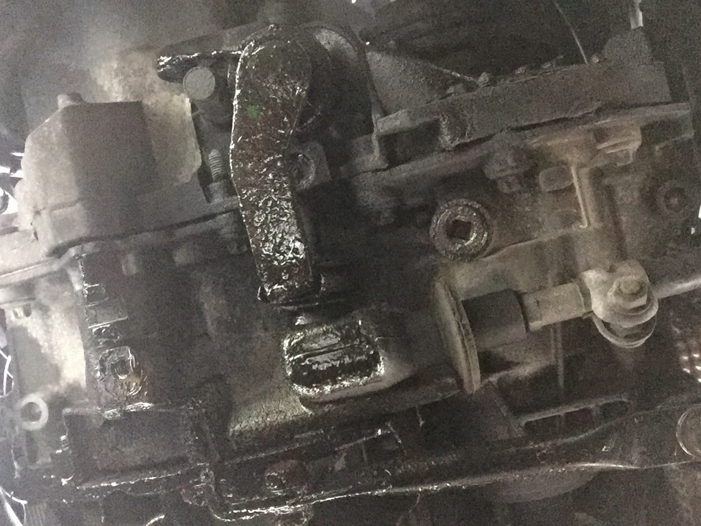

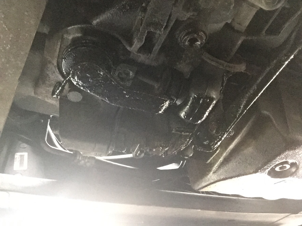

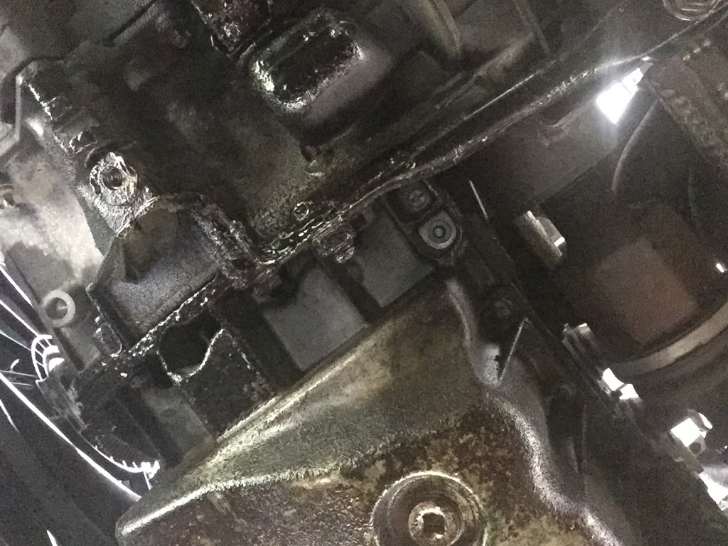

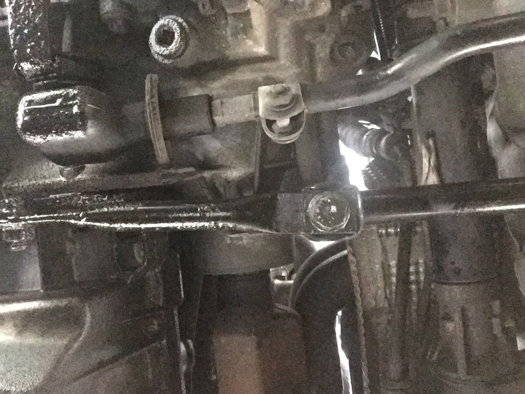

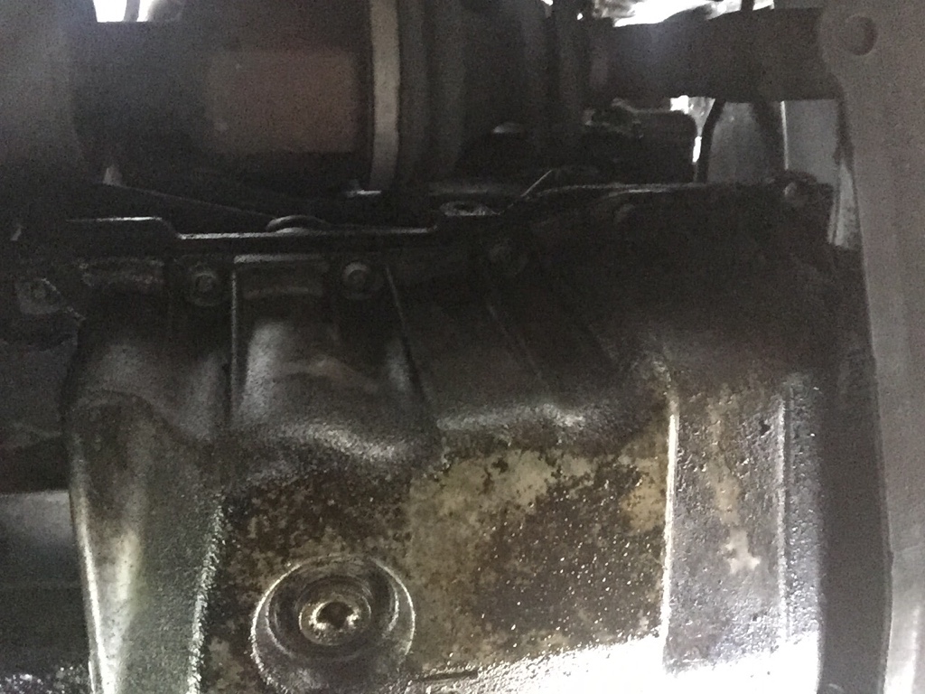

Ahh right, well I've just looked over the car today and looked underneath, the bottom of the gearbox has quite a bit of oil but no real signs of a leak from the engine ?
Left me a bit clueless has this one ? Think I'm gunna drain the excess oil out and then keep my eye on it, also keep the lower undershield off and look for any oil

Gearbox will be leaking from the selector shaft. It's a common issue. No harm in giving it a good clean and keeping an eye on it to be sure.
