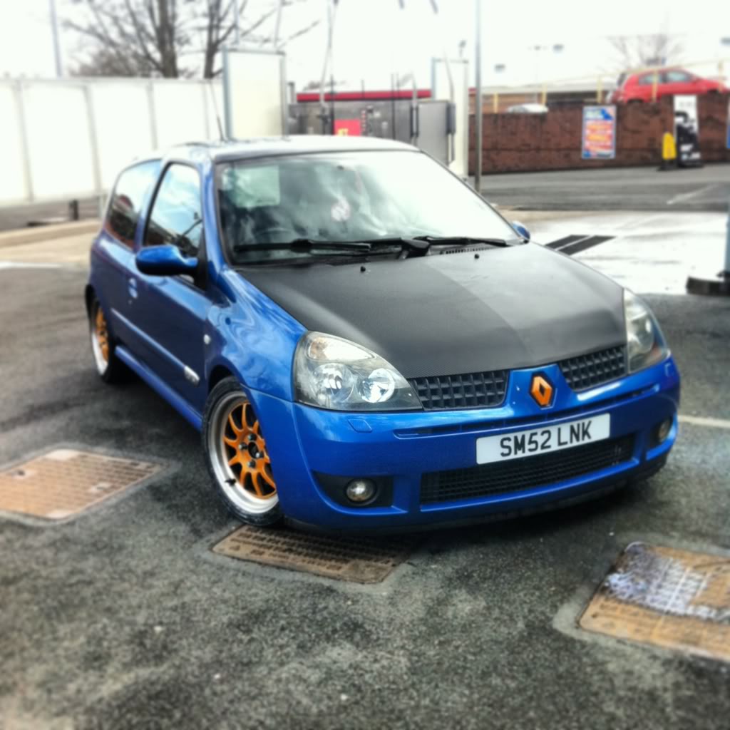

Thought I would start a thread for the new addition, mainly so I can look back and see what I've done to it over time.
Now most of you have seen this around before, it was for sale for a while on here.
Anyway here she is when I bought it
I know it's been through a few peoples hands and after a quick look over I could see it needed a fair bit of work doing, but I've always fancied a cup and this one came with a few extra goodies.
First of all I knew it wasn't 200bhp before I bought it and after driving it, it certainly doesn't feel 200bhp, tbf it doesn't feel any quicker than my 182.
But I didn't buy it for the power I bought it because I seen potential.
Anyway here's what's on the list of things to do:
Important bits:
Get the belts and dephaser pulley sorted.
Sort the problem with the uch (wasnt aware of this when I bought it)
Sort the warm idling issue out.
Get the thrust bearing looked at.
Not so important bits:
Change plugs and leads.
Get rid of the orange theme
Get a different bonnet
Fit new side skirt.
Repaint the roof and spoiler (paint job is poor and full of scratches now)
That's about all I got planned for now.
I've already changed the oil and filter, the temp sender, the thermostat and sorted the knocking noise when pulling off (ball joint bolts were loose).
Comment and criticism welcome.
