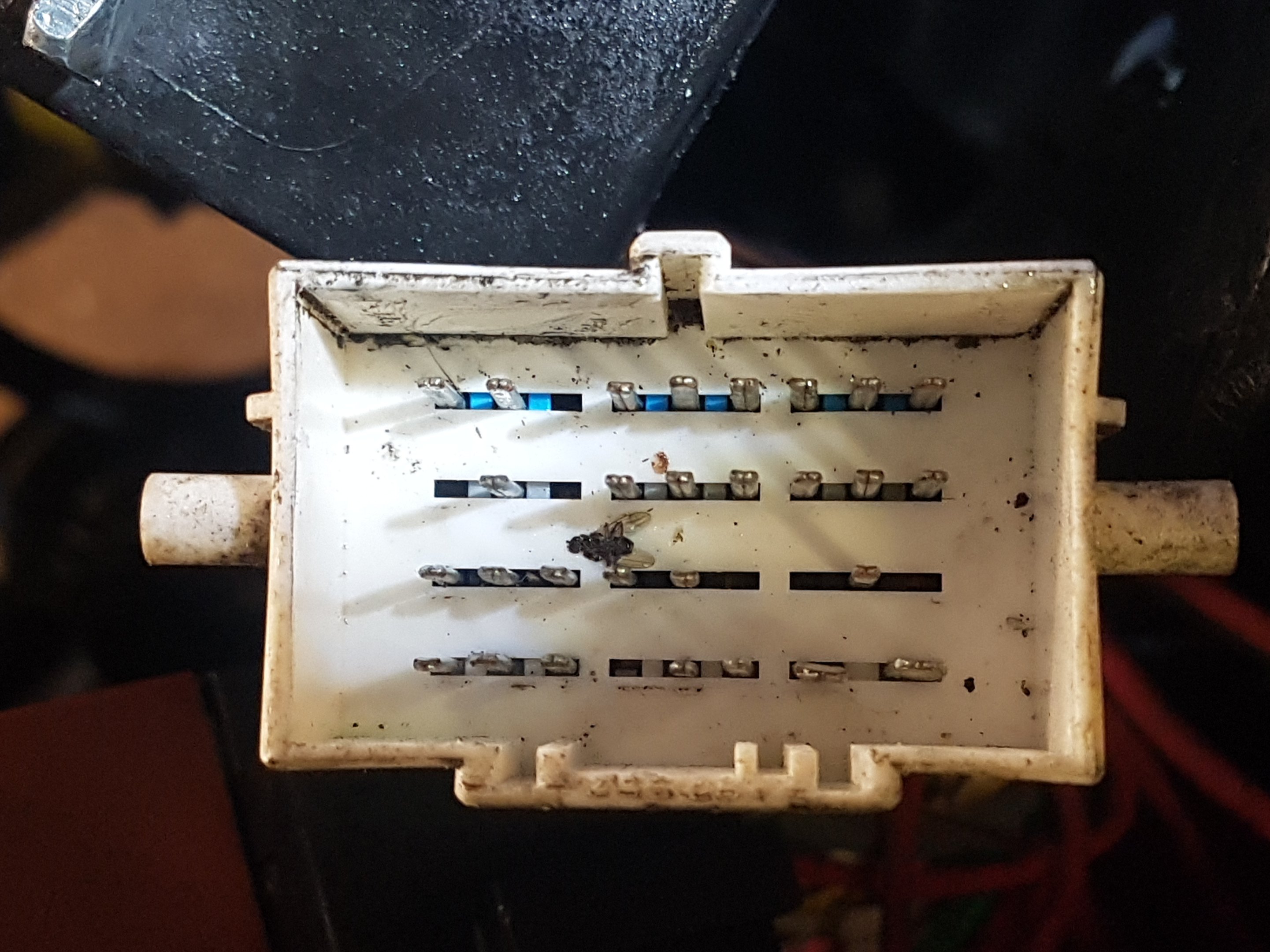

60% of the time the cause is corrosion in the loom to pin connection (not pin to pin ) of the large white multi plug at the bottom of the engine bay fuse box.
Servisol super 10 from Maplins has been previously been recommended as a weapons grade switch cleaner.

The cause in the majority of cases is corrosion of the loom/pin connections in the large white plug in the engine bay fuse box.
Cleaning it up works for a while, but as rainwater running down the loom is a design fault, it comes back again in time.

Also had a look at the big white connector,seemed pretty clean inside no corrosion,also gave that a spray with electrical cleaner,very tight and fiddle down there so didn't want to piss about to much incase i pulled a wire or something out.
So time will tell now,if it comes up again i will look at another throttle body.
