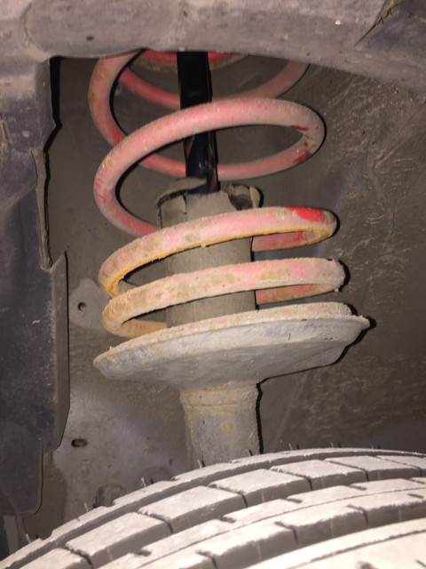

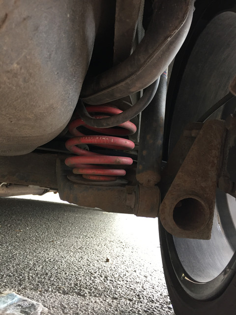

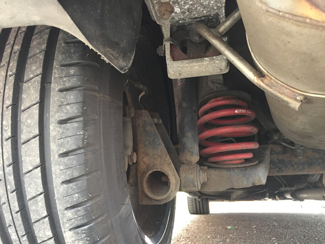

Some pics of my current set up.

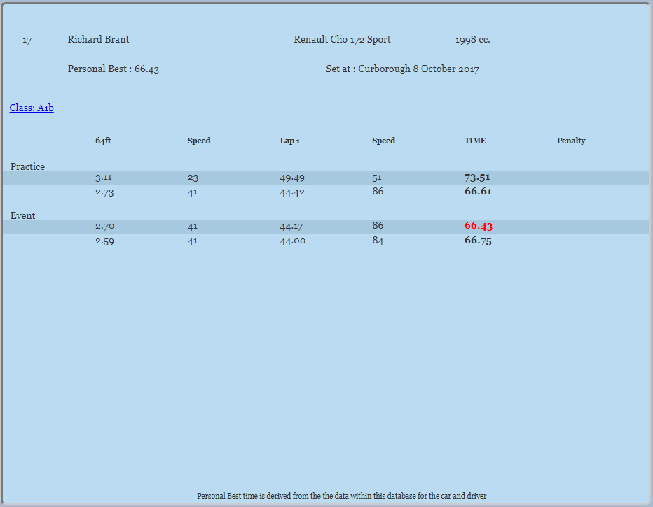

Very tidy run, I have only done 1 practice day and 2 members afternoons so far. Will be doing my first chempionship next year.
What sort of speeds do you normally get crossing the line? I managed a couple of 85-88 mph on the last run. Not sure how that compares to other similar cars though.
Cheers mate, what Championship are you going to do?
86mph over the line is my best.
Rich
Mine was only done on a GPS phone app so could in reality be lower, speedo was reading over 90 though.
