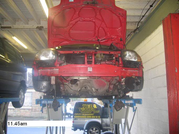

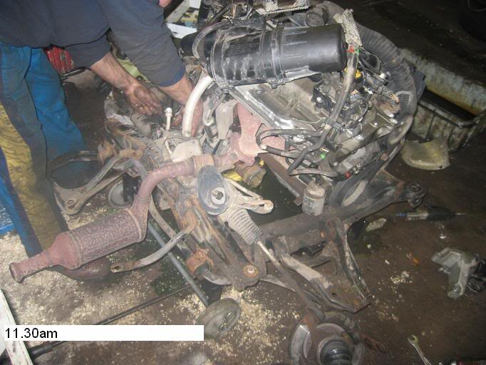

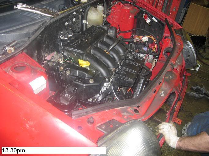

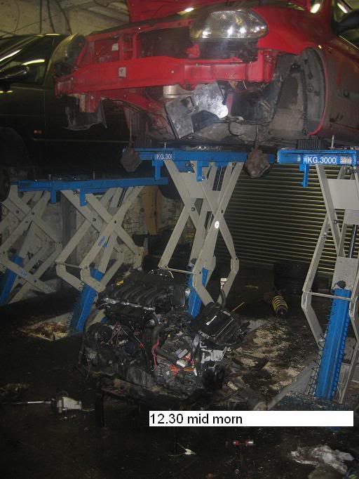

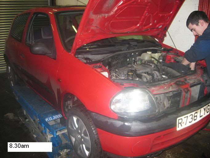

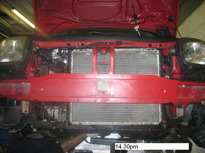

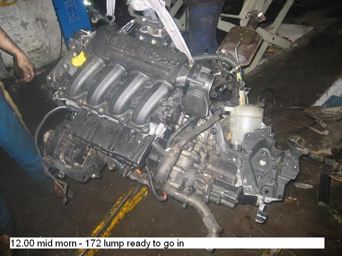

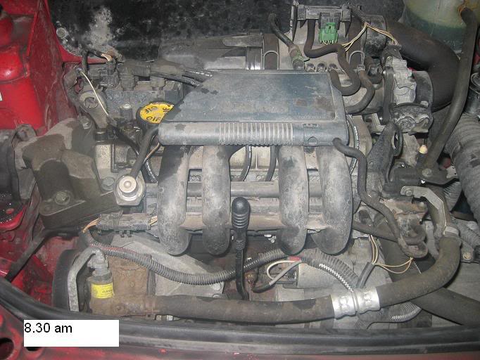

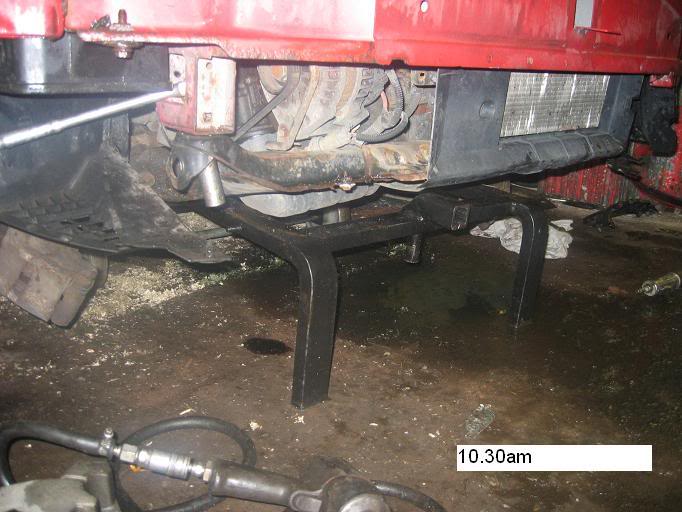

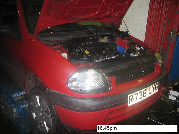

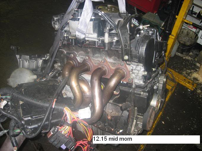

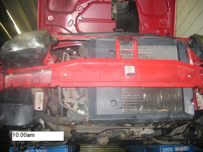

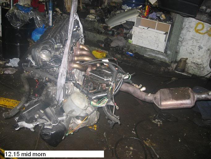

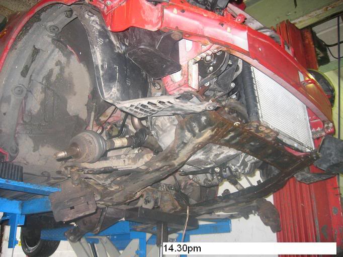

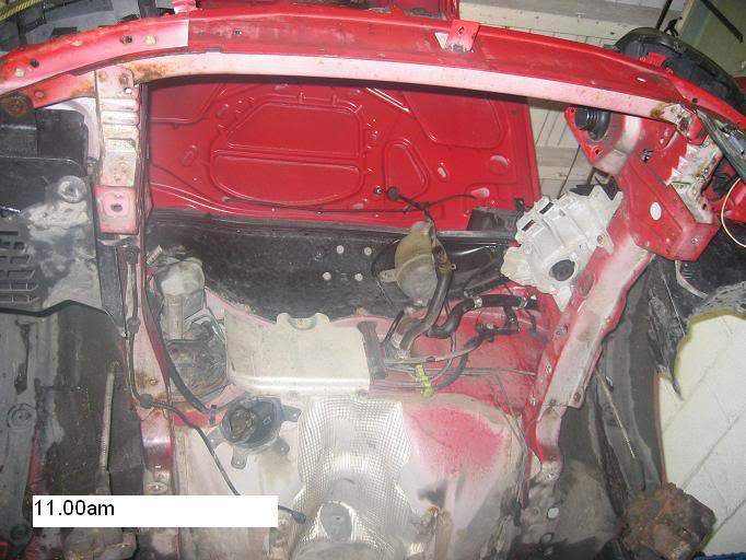

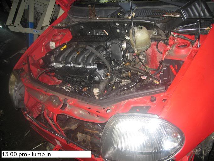

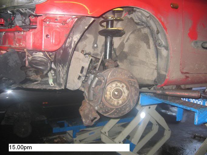

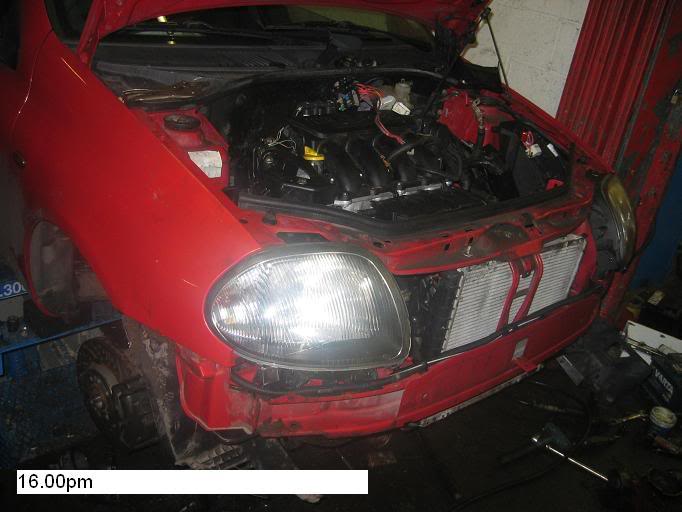

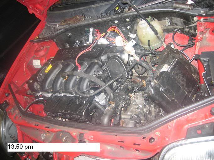

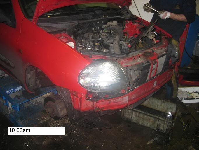

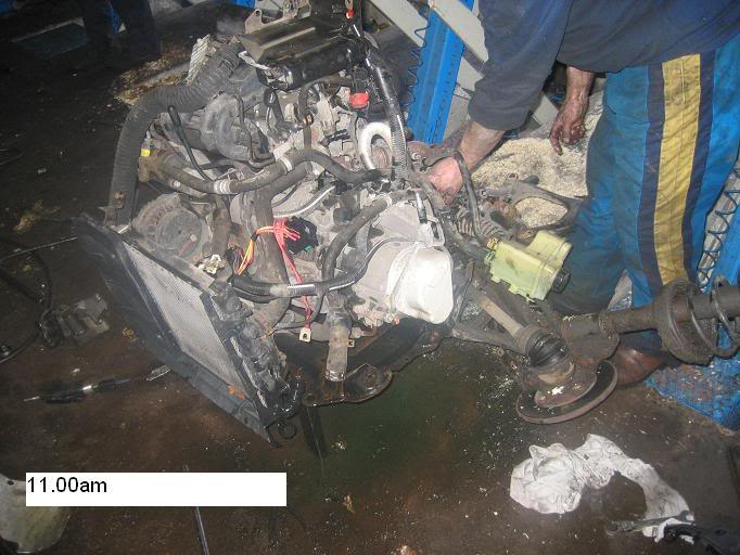

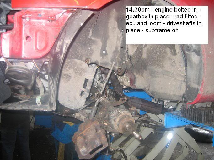

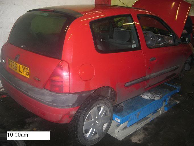

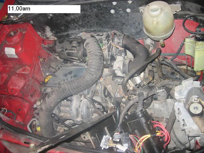

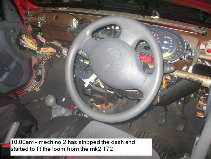

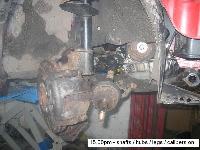

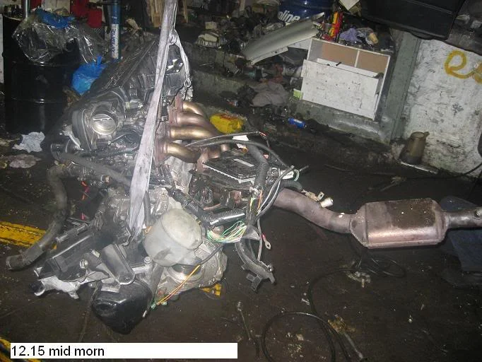

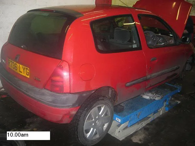

This conversion was done in 1 day by our 20 yr old technician shaun - its his own car and his daily runabout ( sleeper )

thanks for the pics I remeber the original thread "172 conversion in 8hrs" but the pics have dissapeared from that thread only the first portion worked.
Glad you posted them as they are a real help.

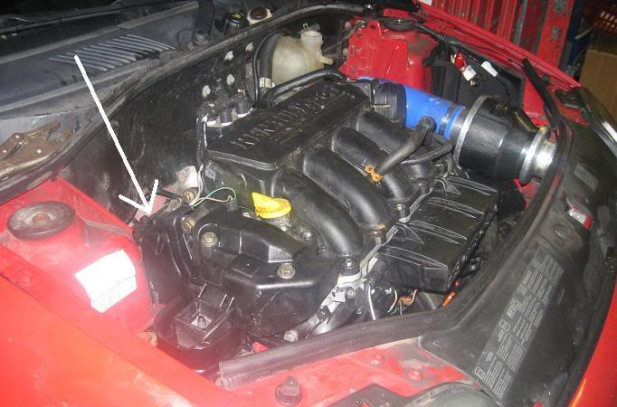

Subframe is seperate its held together on the proper 172 as there a 4th engine mount on the subframe to gearbox.

ok so using a engine crane/hoist and jack's/axle stands what would be the best method of getting the engine in/old engine out.
Also why does it appear that people always use seatbelts to hoist the engine up? is this not dangerous, obviously I realise seatbelts are designed to withstand immense ammounts of pressure and force from an impact but hoisting a very heavy engine over a long period of time does this not strain the belt?
You said it belts can hold massive weights so there no real issue. The pictures are tken at a breakers yard so they'll have loads lying round to use.
If you think about it engine weight what 200kg with box at worst a seatbelt is designed to stop a fat guy moving in there seat in a big crash so its got load sod strenght in it.
If you've not got a 4 post lift engine out and in the top is the popular way to do it. You could use the crane to lift the car etc over but its not worth it.

buying a used engine is all well and good but ensure you see it running before you fit it. Make sure the drive shafts are good and the gearbox is ok... most cars have been in a crash and the boxes dont survive.
if you get a subframe with your kit make sure it isnt bent.
if the car has an after market alarm fitted when broken ensure that is supplied or you know a good auto electrician who'll be able to fix the loom back up.
ensure that when the loom is removed from the car the upmost care is taken when handling the UCH also if your bits go into storage ensure the UCH is kept dry a new one is over £250 + programming.
as for fitting i prefere over the top but if its all mounted on a good subframe and you have a 4 post, then drop the car over the new built up front end will take you a lot less timewise.

Regarding the Wiring edde has described, here are commented diagrams of what he has descibed in the first post
You can put the engine in from the top if you want. Subframe off easier though just some don't have the facilities to do it that way. If you did drop the engine over the engine can do engine froist them when its up in place then put the subframe on.

When you buy a conversion kit you will need the following parts to make it a nice clean conversion with no messing about - most essential is the DONOR VEHICLE chassis details or reg number.
The reason being when you disconnect these items and re-connect them they sometimes lock up and you need to enter the immobiliser code for the vehicle to unlock them - if you dont have this code it will cost you £££ to get it sorted ( new plip key / UCH and possibly a new ECU ) these parts are all coded ( immobiliser ) and the most common fault of the vehicle not starting up once the conversion has been done.

new circlips for the shafts - were they slot into the gearbox ( essential )
hubs
discs
calipers
radiator
