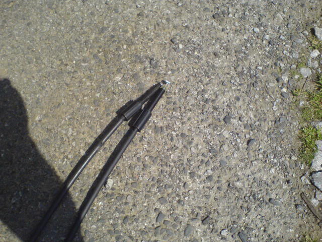

Yeah There are 2 slots 1 on either side of the cable throttle black wheel I am using the closer of the 2 but then that keeps the throttle wide open (Can't even get it on the other as the cable has no slack) I haven't even got the other end attached to the pedal yet.
The routing of the cable is as per really brillant sketch

how far up the 'adjuster' have you got the little circlip
by adjuster i mean the black pecil type thing with grooves on (adjusts how far the butterfly is open)
i'll try and find a pic to show what i'm waffling about lol
  F4R'd ITB'd '92 cup racer
hmm i'm stumped then, unless the cable is wrong
so when you attach it there is no slack at all, and the butterfly is fully open, so the cable is pulled right through the sleeve until it gets stopped by the pedal connector on the end?
edit: sorry if this is maybe a bit patronising as i dont know what mechanical ability you have :eek: but you are fully opening the butterfly and then attaching the cable arent you? ie use the furthest away slot on the 'wheel', then when it springs back you will have slack in the cable

No offense taken matey, I am fairly techincal minded I have re-built many a R5 GTT but my knowledge of 172 is novice but handy with spanner LOL.
Yes when putting the cable on I am fully opening the throttle butterfly so but it is getting stopped by the pedal attachment. And it does not spring back so there is no slack at all in it. The part number on the cable is correct for the 172.
Looks like I need to see if anyone has got a spare cable that has been on a car available for me to compare mine to.
