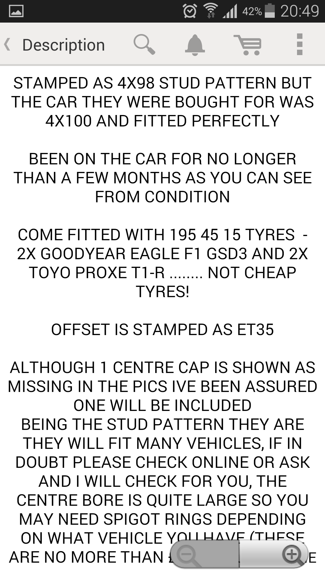

Hi, I'm looking at buying a set of 15" turini wheels but I'm a little unsure on the wheel sizes and if they'll fit my 182. Can any1 help?

Thanks for the replies. The wheels haven't arrived yet. I was just more worried about weather they will fit as it says they off a 4x100 car but 4x98 is printed on the wheel. But iv been assured they fit the 4x100 car perfectly. Just hope they fit!
