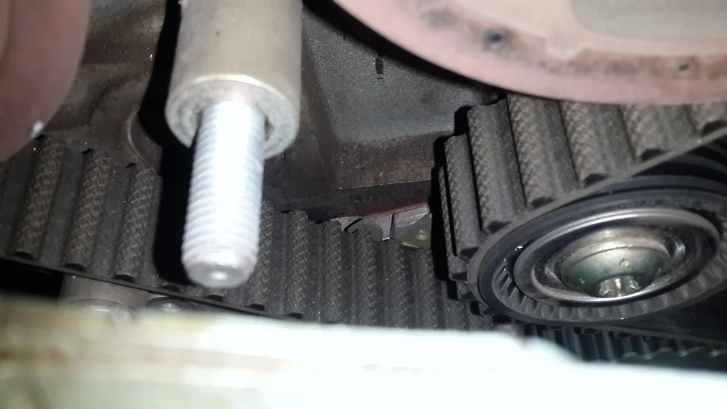

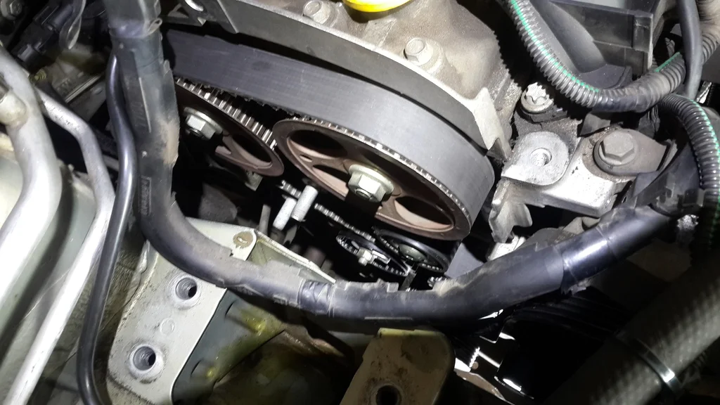

had a aux belt pulley fail 20000km after that and found that the pullies had not been replaced, even though i paid for the whole kit, a few weeks ago the normal clunking rattle changed its tune to the one i posted a clip of, so yesterday decided to check the cam belt... this is what i was greeted with once the covers were off.

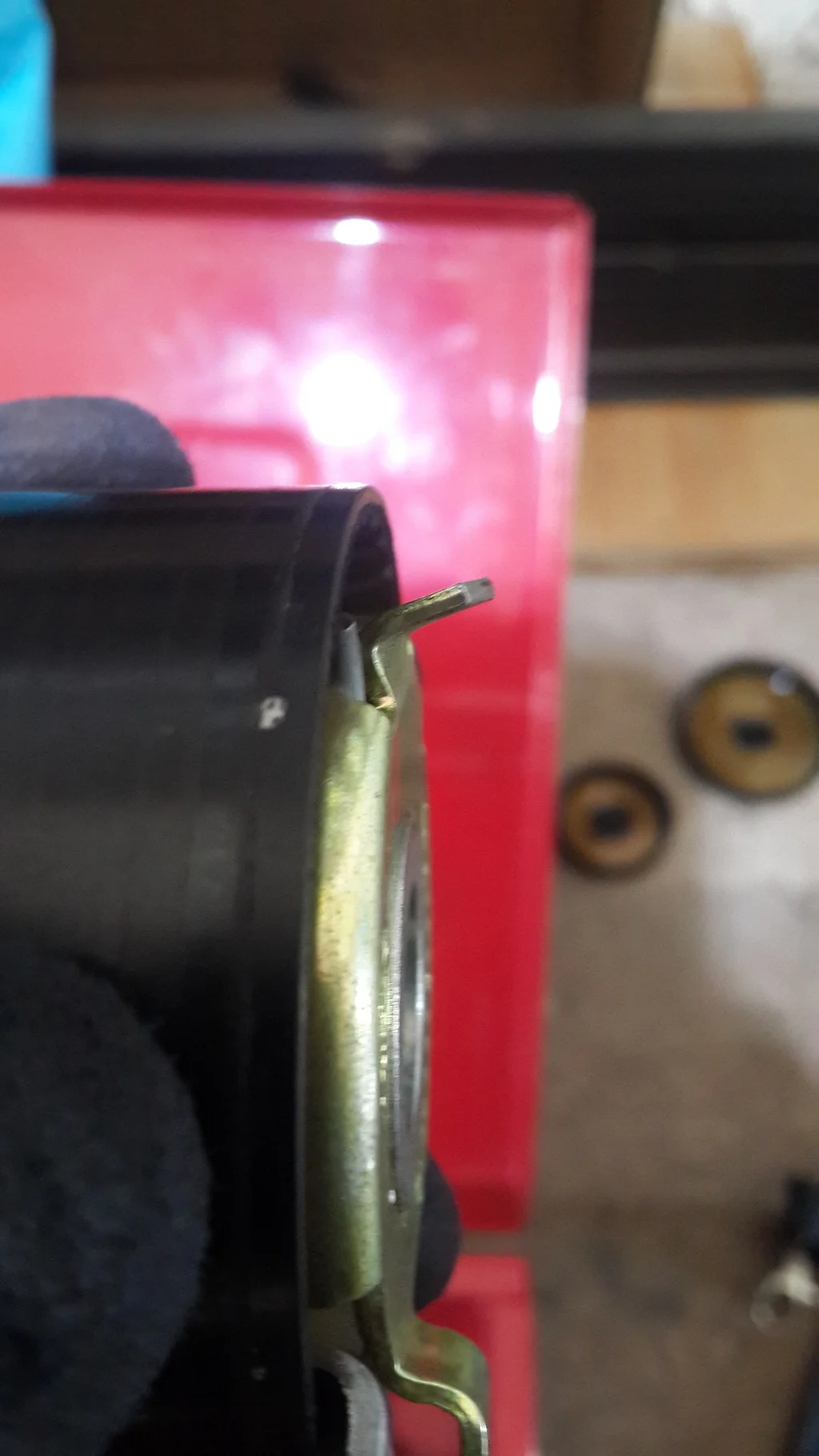

clearly not tensioned and in the wrong position, took the tensioner out to find it was not located in the slot in the water pump
the locating flag had been bent where it was forced against the water pump casting, also found that 2 bolts were missing off the covers and the timing was a tooth out which may have resulted from the crank bolt beeing lose...
so re set the timing and gave her a swing
