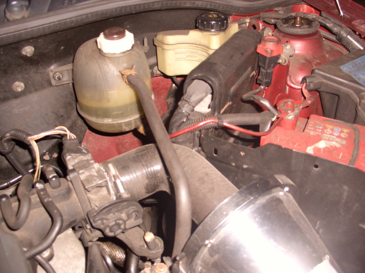

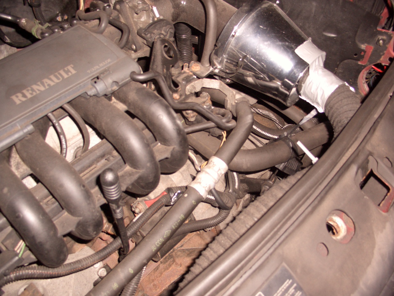

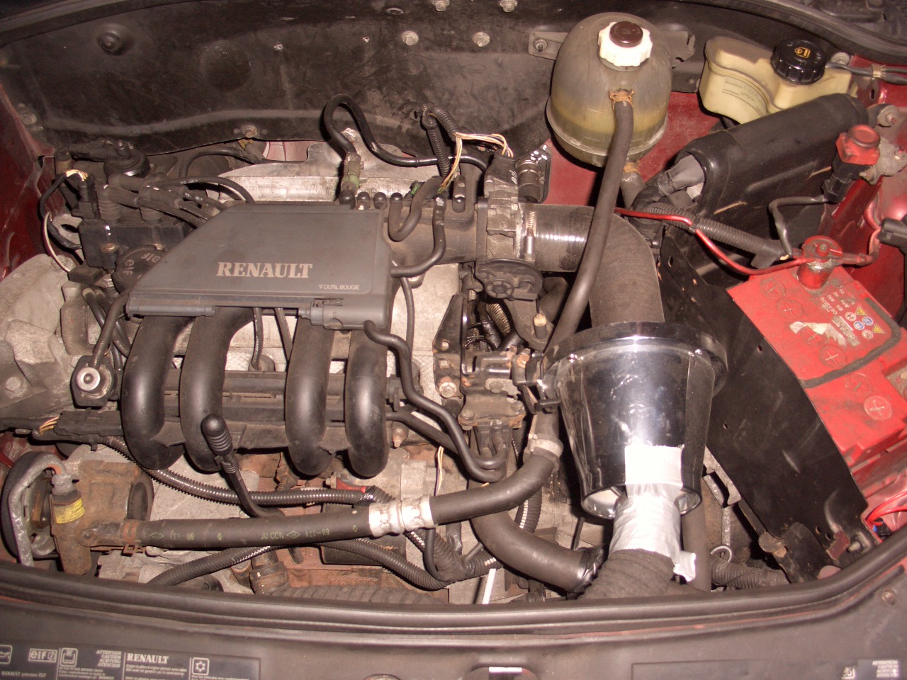

Ok.. pics... but first things to ignore
  1. The silver max power, look at me, bling bling cone. (I was a student, free when brand new is epic when a student (and i've only had a job for 3 weeks))
  2. The gaffa tape holding the cold air intake to the filter (student excuse again)
I have also moved the cold air feed so that it feeds from next to the drivers headlight as opposed to the original position. (I can take a pic of this if necessary)
Setup ignoring tape
Silicone bend (yes it needs a clean BAD under here)
Can sort of see where the intake comes from now and where it goes (tape WOO)
Setup ignoring tape

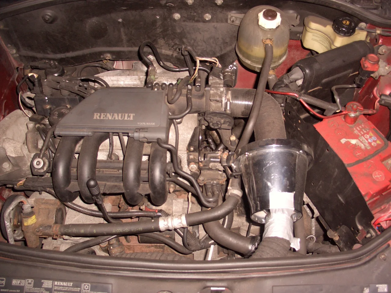

My filter setup was 100% exactly the same as yours is in that picture, i guess its my angle that doesnt show the size of the gap behind the engine where the airbox used to be, (sorry)
My feed ran from the same daft whole in that piece of metal down the bottom below the passenger headlight and my air box was behind the engine.
I have removed EVERYTHING you have highlighted in red and gold
The gold piece is just an air box, the "bumpy" pip is one fed into the airbox and then "smooth" "U" is the feed from the engine to the airbox.
Make sense?
Make sense?

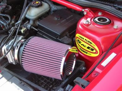

I saw that pic earlier, you just have a standard shaped filter in there like the one you took out though right?
Im changing it completely to a cone filter like the one on ebay linked above.
