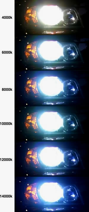

And finally, those auctions offer different "Colour Temperature". what does this mean?

Colour temp basically means what colour light the bulb emits.

Thought that if you got them too purple they could be illegal tbh.
Think the standard colour ones are fine - bright white with a tiny hint of blue at times.

Yes they fit fine. You should be fine legally with any colour 8000k or under. The standard Renault colour is 4300K.

The ones in those ebay ads look fine. I would go for the normal 4300k ones, they are bright enough and have a bit of a blue tint anyway. Do a search on here for it you'll find some older threads that will tell you more.

Yeah thats what I figures, just the Stealer trying it on I reckon. I'm well tempted to go with the 10000k bad boys, but think I may regret it if I get pulled or fail an MOT ? decisions decisions?

The higher the K number, the further from white you are actually going, so that might put a strain on your eyes whilst driving at night. Also, bear in mind, to light up darkness, you need WHITE light, not purple or blue!

Cheers for that, I've done a search and actually been reading a thread that described exactly what you just said. Seems the general opinion is that 600k are the best for extra light and colour? Would you agree steviep ?
It could well be the ballast that has gone. I'd swap over the good bulb with the bad one and check first if it's actually the bulb that has gone. So you know, the higher up the K you go, the less light the bulb actually puts out.
6000K are about the best balance between look/light output, but I've got 8000k more for looks than light.

if you have Projector Headlamps and no higher than 6k youll pass an MOT you could prob pass with 8ks but that be a slim chance!
