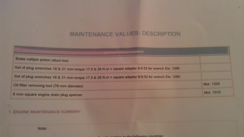

Will have a look at that print off i gave you, look at the rear brakes bit and see what the torque setting is for the nut.

Ali can you let me know the offical torque setting for plugs on the RS cars as Renault birmingham said i was wrong!
NGK state 29nm, renault say 23nm
Will check tomorrow, I use the pre set torque wrenches for plugs, 3 differnt types, proper Renault tool. Saying that, Will. look at your print off for spark plug torque setting, 29nm seems high.
