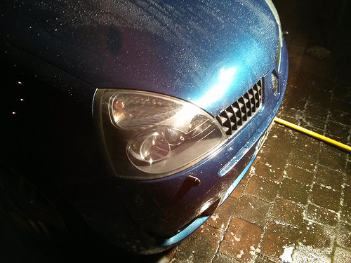

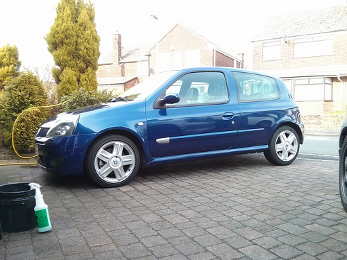

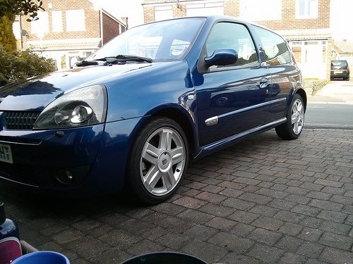

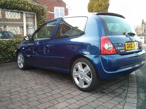

So tomorrow I get to order all my bits and pieces to get the car mechanically at a stage where I'm happy. So thought today I'd double check that it was the brakes that just needed bleeding causing my spongey pedal and nothing too sinister. No pictures of that but then I realised that the weather was pretty awesome so decided to give the car a quick clean.
Products used:
Werkstat Acrylic Prime
Werkstat Acrylic Jett
Zaino Z6 (Used as a drying aid)
Tardis
IronX
No tyre shine (disappeared)
Went to get the camera out but both batteries are dead (sorry) so you'll have to make do with some very poor phone pictures.
I've noticed that the drivers side has 100% seen paint. There are sanding marks on the door and the rear arch. It looks more like it may have been vandal damage as the areas just don't tie in with an accident at all. Also some of the paint is pretty dull. Also as with any old Clio there are stone chips all over and the drivers side headlight REALLY needs correcting. Also there are plenty of RDS and swirls so I'll be giving it a proper going over with a DA at some point (I say I but it'll probably be a mixture of @Christopher @JoeyD @Jon.G and @Eddie. HAI GUISE!)
Also does anyone know how to get the old school format from Flickr for pictures? Can't find it and it's changed my view automatically to the "new" style. b*****ds.

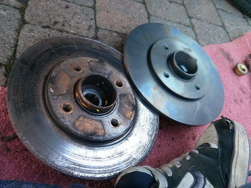

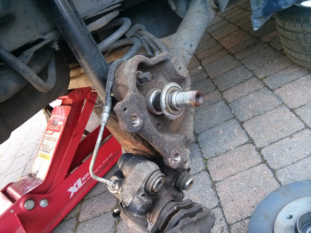

Started with the drivers rear side, couldn't get the carrier off the calliper so decided to just remove the whole thing from the hub and do it that way (didn't matter too much on this side as the handbrake cable is snapped off, which will be replaced this weekend).
Quick inspection of the rear pads shows they're getting rather low.
Quick comparison between new and old discs.
Didn't get a complete picture but we all know what a discs with pads and a calliper look like.

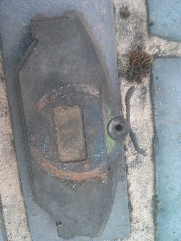

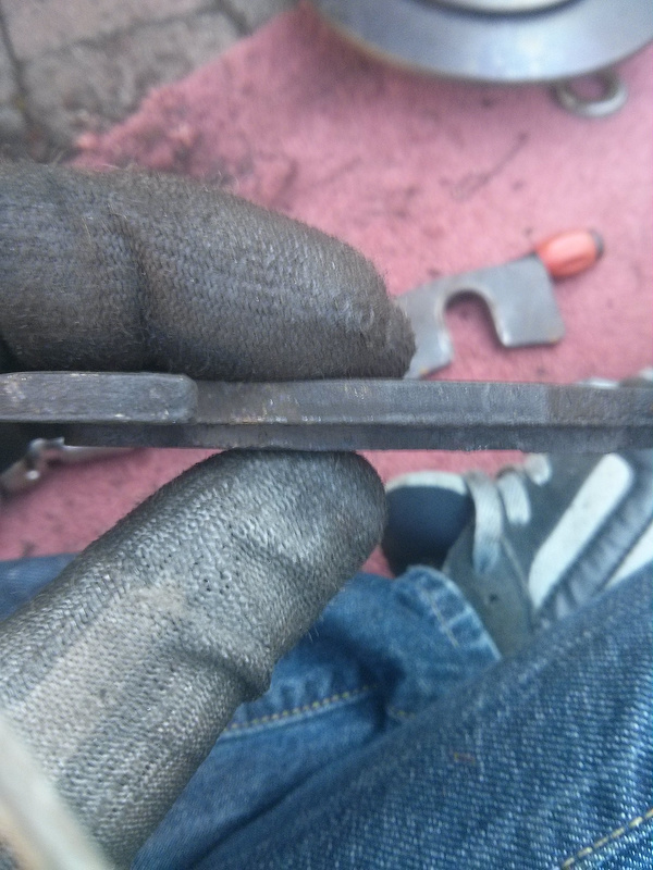

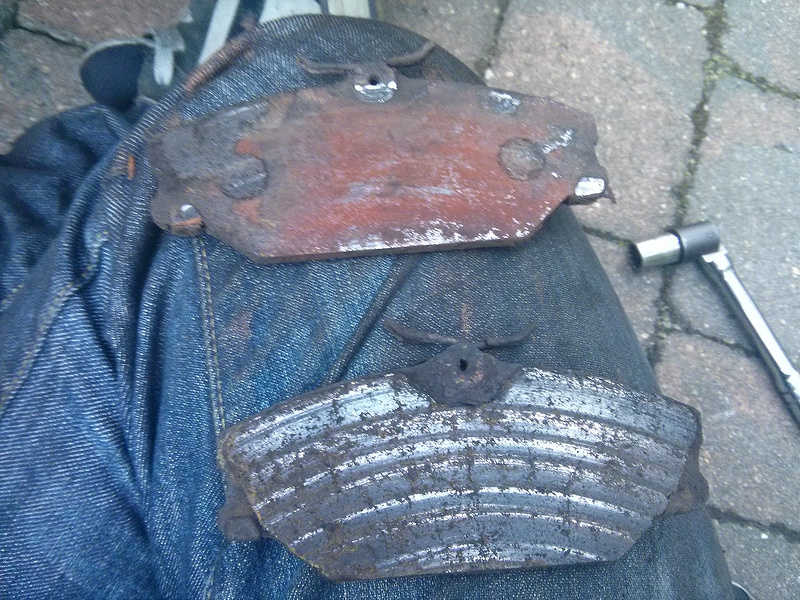

Then got on with the fronts. Had nothing but problems getting the discs off so just got on with it. It does appear that along with the grooved and drilled discs on the front it also had EBC Green Stuff pads (can just see the little bit of green on the backing)
This is the condition of the front pads...
Today I drove to work and thought that a pad had vacated the car en route. But actually you'll see that the top of the two pads is NOT the reverse of it, you can actually see the wear on the backing plate near the clips at the top.
And that's where the battery died. Took it out to bed the pads in properly and it took a while but my God they are great. Not even properly bedded in yet and I've also not changed the fluid either as I didn't have time, can't wait to see what they are like when it's done.

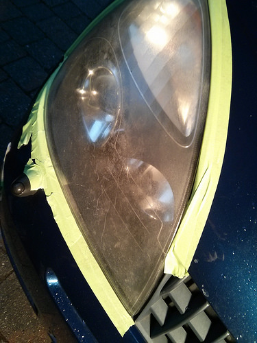

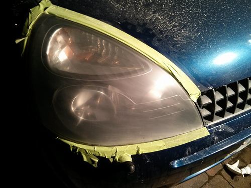

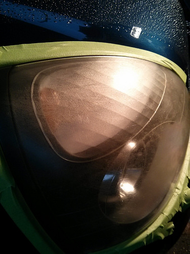

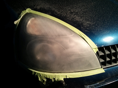

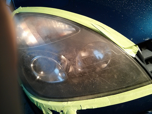

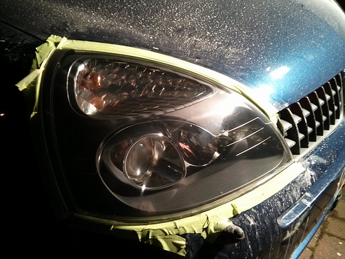

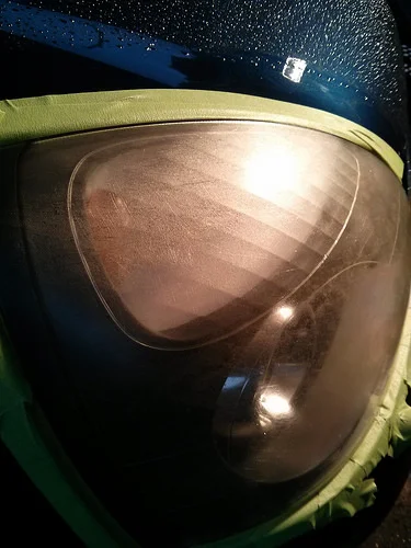

So my 3M kit arrived today so tonight I set about doing whatever I could with the headlights. Now the pictures don't show just how bad it was. eddie Jon.G and JoeyD will vouch for just how minging the drivers side was.
So I masked it all up
Then set about sanding it down
Then polished it up
Still needs some work and I forgot to get pictures of the passenger side but that wasn't too bad in the first place.
Opinion of the 3M kit is that don't bother with the drill for the sanding stages, you get a much better finish/idea of how you're getting on without it, it just generates too much dust and destroys the paper. It also doesn't have good enough steps between the grades (500, 800 and then what basically feels like a sponge). I'll be buying myself some more varied grades and giving it another go. The drill bit and pad is worth the £20 I paid for the kit just because I don't have a DA/Rotary so it was very convenient.
