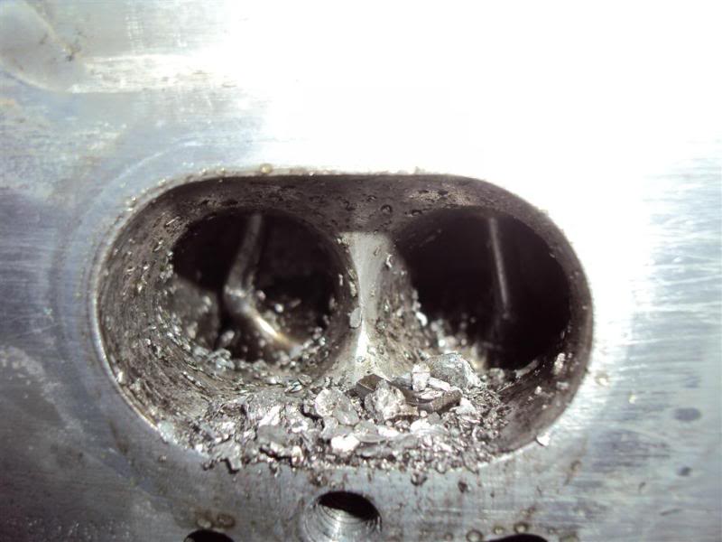

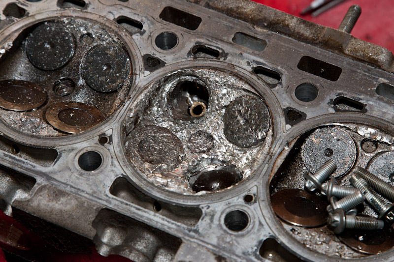

Valve failure at 7500rpm.
  HBT 172 Cup
c**ting crappy F4R's
  HBT 172 Cup
Haha cars always been set to 7350rpm, had the cams put in and thought it pulled a bit better top end, pulled over in a layby few clicks on the laptop and away we go.....less than 5 minutes later im on the side of the road with a dead car :(
  ITB'd MK1
lesson: LEAVE IT THE f**k ALONE!!!!
Adey.
some last and others dont, my other clio used to bounce at 7800 with bodies and 428s all day long and never batted an eye lid, ive not tried to go past stock revs with this one tho
  HBT 172 Cup
I guess the 421's warrant better springs when at 7500rpm? Should be noted the valves are only 5000 miles old tops, but they were "camtec" pattern part ones :S

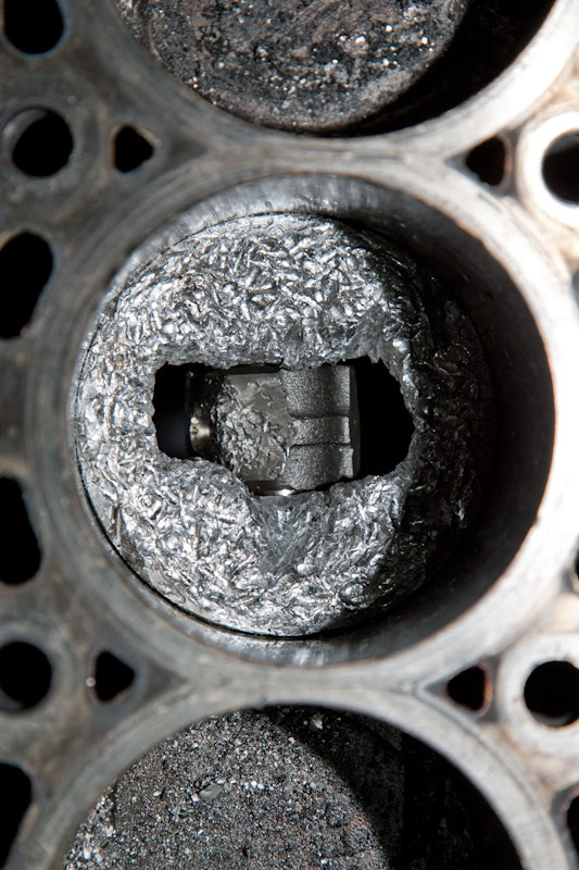

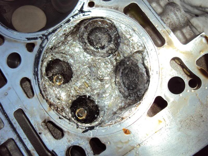

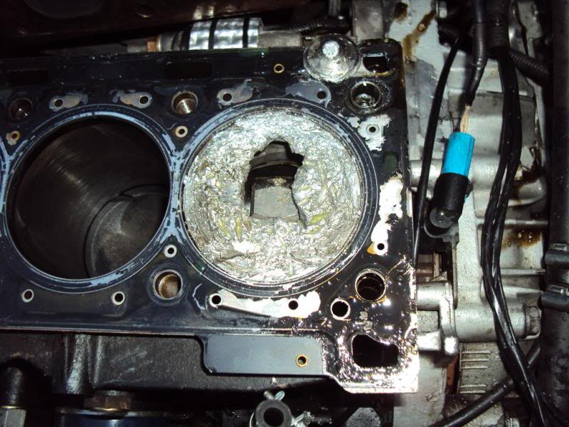

I know your pain... looks identical to my first engine that died... second engine that died wasn't as bad (was going much slower, just bent the valve).
First one:
Needless to say, my car now runs OEM cams...
