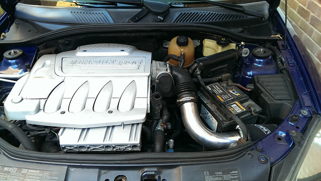

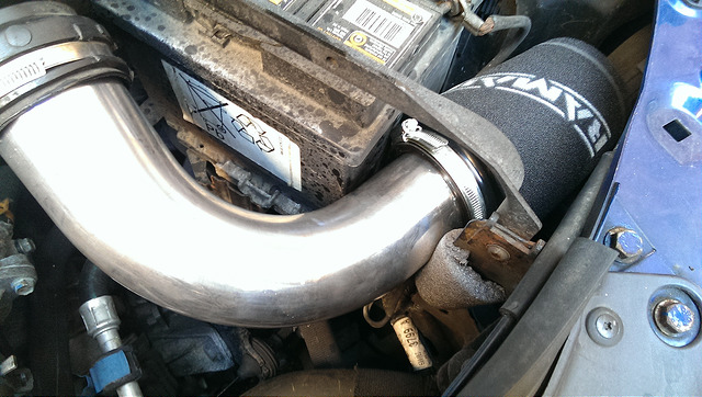

Yeah I've had the clip on & off, up & down, every way. I can't force it in without bending the mesh inside the filter. Seems ridiculously tight tbh. Just getting defeated at the mo
right firstly you battery is way too far forward! So move that back as far as possible.
if the pipe is being a pain to get into the filter, put some oil / grease on the inside of the rubber collar. It should then just slide in nice and easy. Also make sure the rubber on the filter isn't stone cold! Check you havent bend / damaged the cage inside the filter as it looks bent to hell on one of those pictures! Also the jubilee clip looks too tight!
A note to all of you that haven't fitted it yet: MAKE SURE you DO NOT squeeze the filter on the foam area! You have to grip it around the rubber base only!! If you try and force it on the pipe by doing this you will damage the mesh cage inside, which then might end up in your engine!!
  Arctic 182
Right guys; first off apologies for that terrible swearing post earlier, I had the hump & it wasn't going well. As mentioned my battery was the main issue, I undone the bracket, pushed it back a bit & hey presto enough space.
That filter neck fitting in that pipe though, Jesus it's tight. Must have been an odd one. Hope others fit on ok. I didn't try lube, I tried shaving some rubber off the edge to no avail.
I eventually cut a split in the neck & forced the pipe in. The jubilee clip was pants & kept popping off so used cable ties on the neck & also to hold it in position.
Everything that could have gone wrong went wrong! A 15 min job turned into 2 hours, I've got multiple cuts on my hands, my new pipe is scratched to f**k, filter is bent & my iPhone is damaged too! But it's on! Taking it for a drive soon.

Yeah it is quite bent inside mate, do you think it will be ok? Nothing looked like it snapped off & I tried to push it back to how it was. Jubilee clip didn't seem to work in the end, just used cable ties.

Your filter will be fine as long as it is still held snuggly enough by the clip/hose, that it won't fall out the hose. I've got the Ktec kit and the previous owner overtightened the jubilee and squashed the 'neck' of the filter in a bit. I just bent it back into shape as much as I could. The only problem is if the filter falls out the hose and given the tight space and assuming everything else is secured reasonably well enough that's not going to happen. As long as there's no rips/tears in the filter material that covers the cage, then you're good to go.

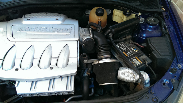

Old setup that was on the car when I bought it...lol

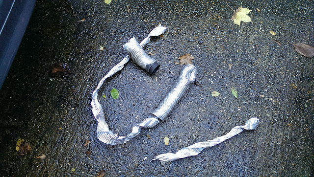

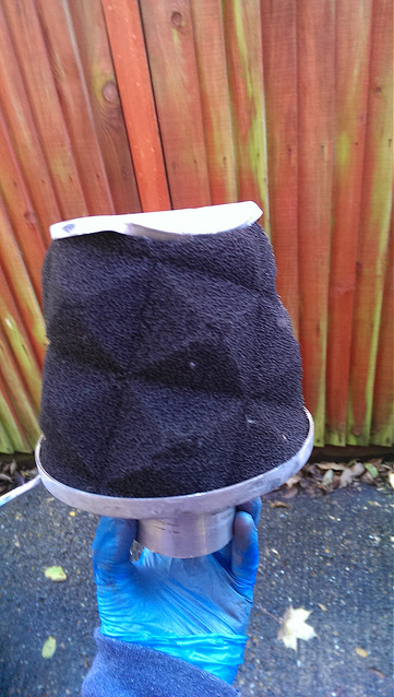

Mahoosive sponge cake like filter removed along with the never ending cold air feed

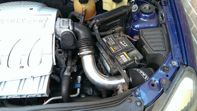

New filter and pipe in place
IMAG1108 by terryclarke13, on Flickr
Tight squeeze! Instead of using cable ties to pull it into place I cut down a piece of pipe insulation and wedged it down there for now. No rattles on the short test drive around the block.
