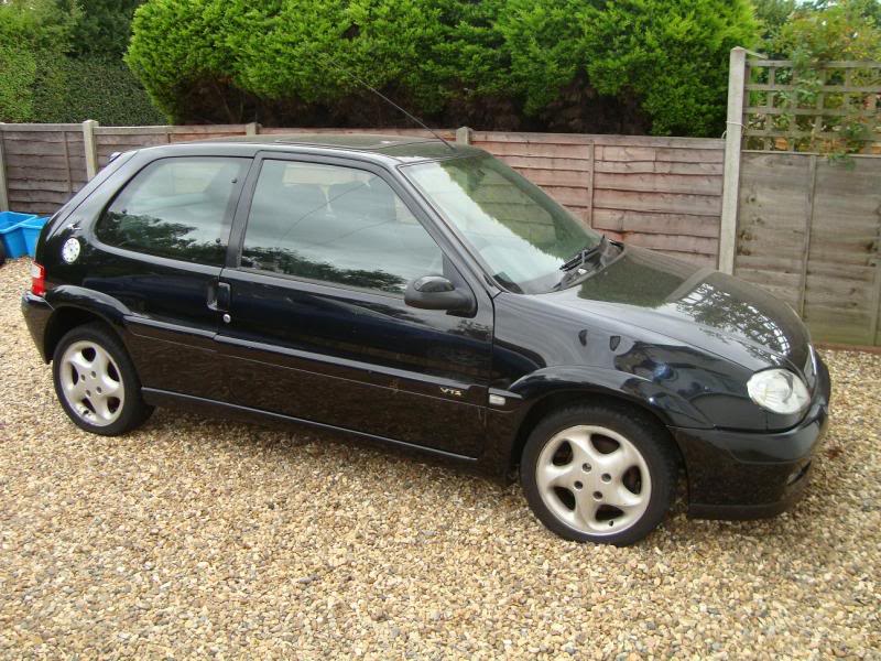

Beautiful isnt it

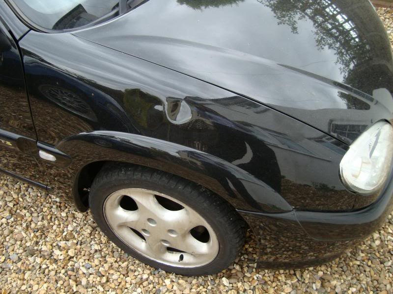

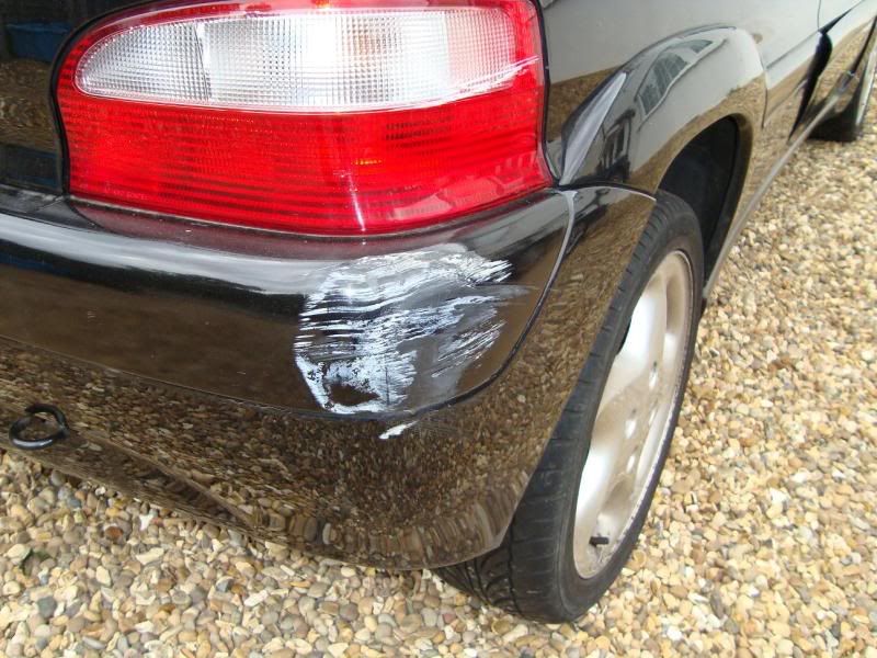

Mmmm dents

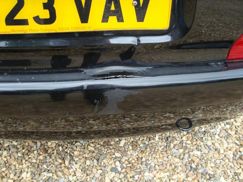

Cracks
Lampposts
& Walls

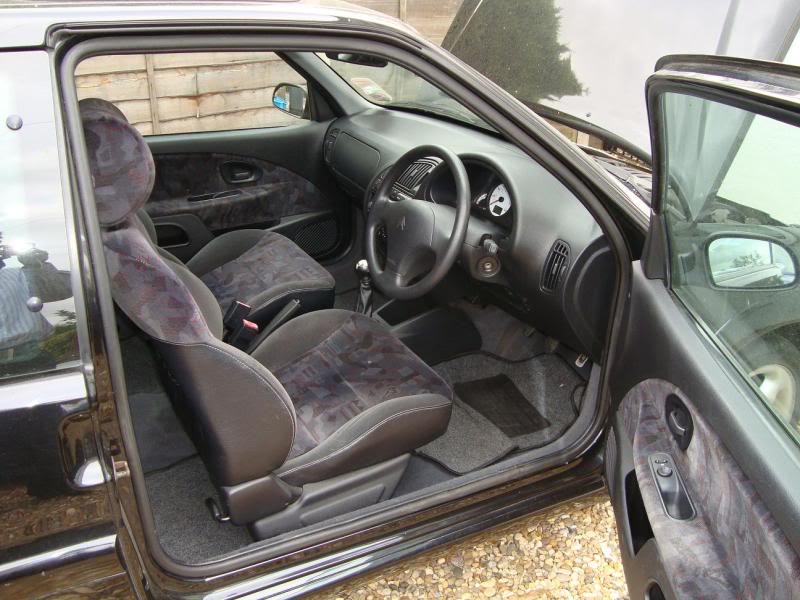

It even has an interior (for the time being)

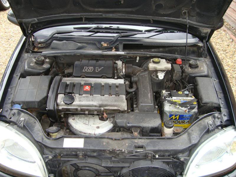

And an engine

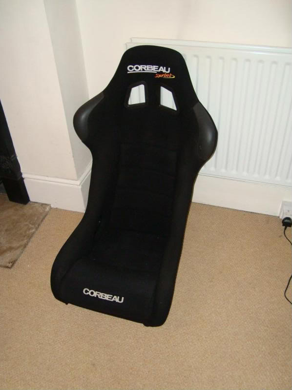

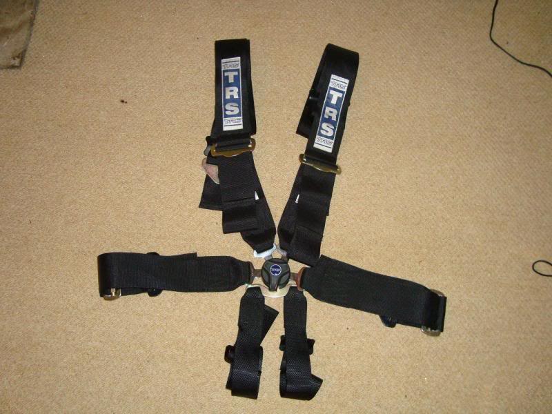

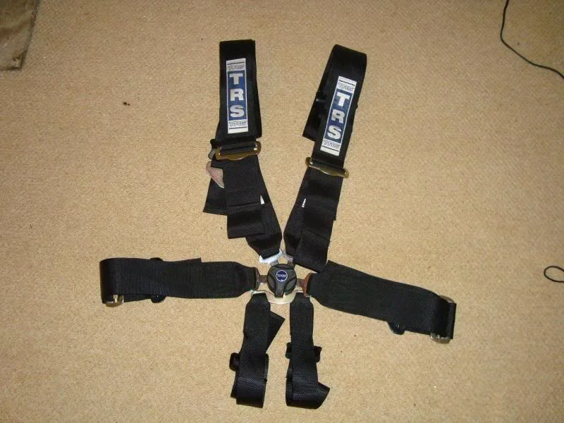

Wont be standard for long lol, picked up more bargains tonight :D its seems that a Corbeau Sprint Bucket, mount & TRS 6 point harness have found there way into the garage ...

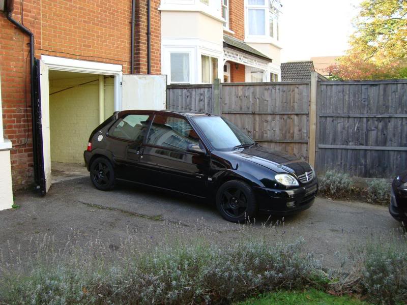

Heres the little sod in the garage, where it'll stay until its ready for MOTing again.

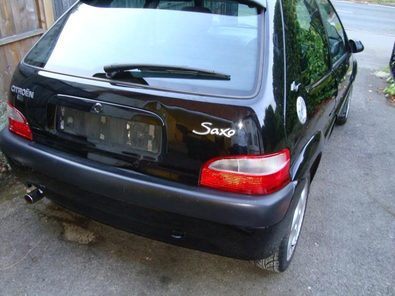

Little bit of an update actually, will post pictures later if i can find my camera. Have now fitted the rear bumper & realised that the previous owner had colour coded the bumpers/side strips :eek: my new rear bumper hasnt had this done so it looks a little odd. Ah well. Bothered!!
On Sunday afternoon i stipped out the rear so no more carpets, seats, plastics, belts, fixings, etc. Needs a good clean though :dead:
Also sold my TRS harness for £85, seeing as i bought the seat & harness for £90, my brand new Corbeau Sprint & side mounts have cost a grand total of 5 quid :D

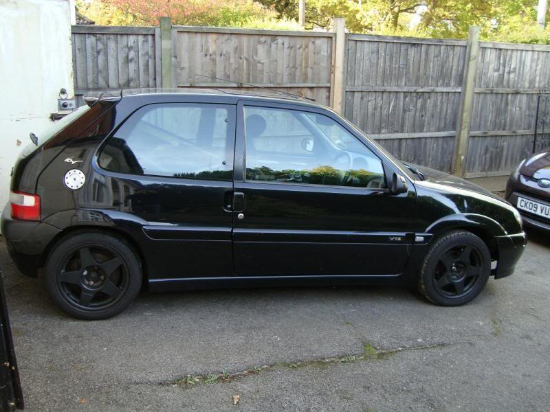

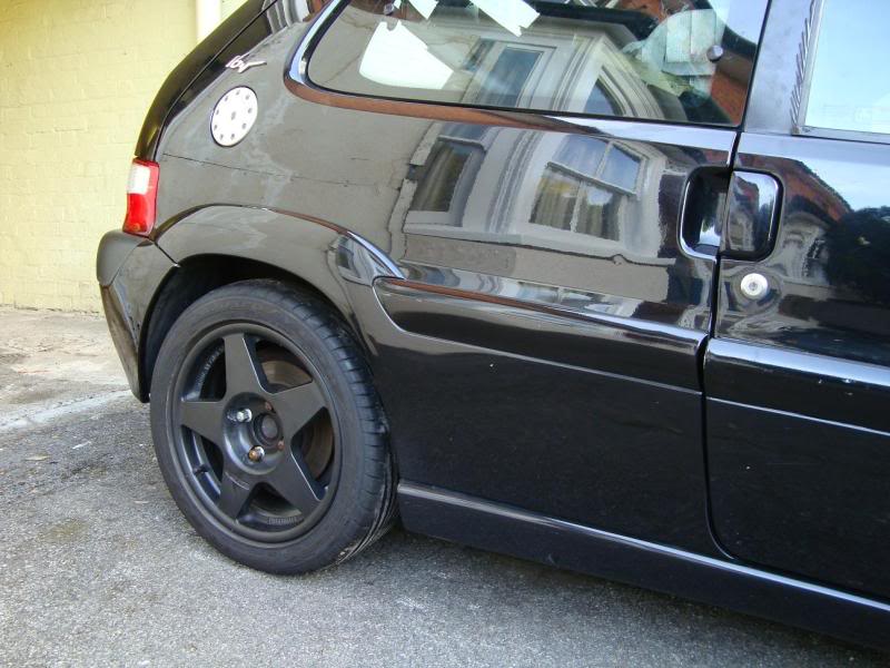

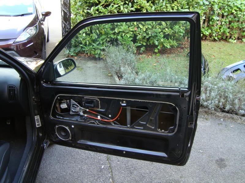

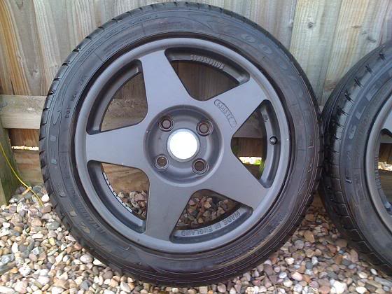

Been playing with the car a little more this week, now stripped the rear out completely, revealed a little rust & fitted the new wheels - although why do people do the nuts up so tightly? Had to literally jump up & down on my wheel brace after soaking them all in WD40 for 3 days :S

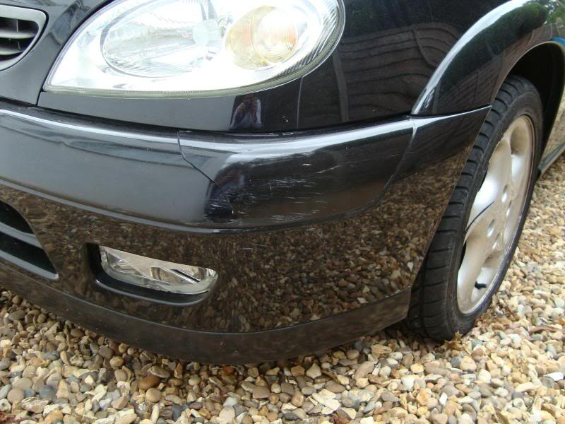

Its getting there now. New bumper:
Stripped

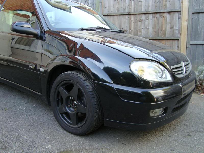

And wheels :evil:
