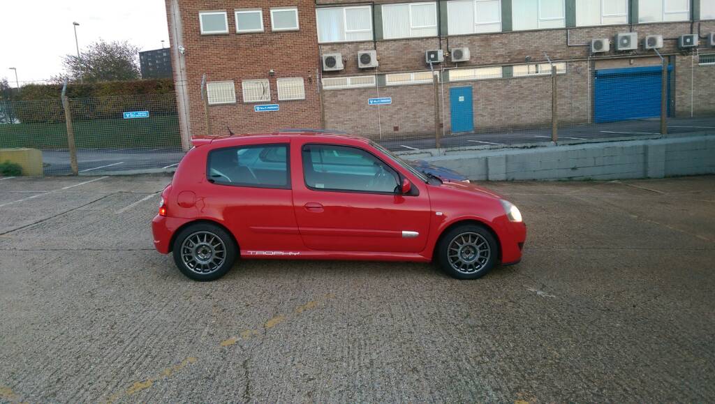

One of the listing photo's

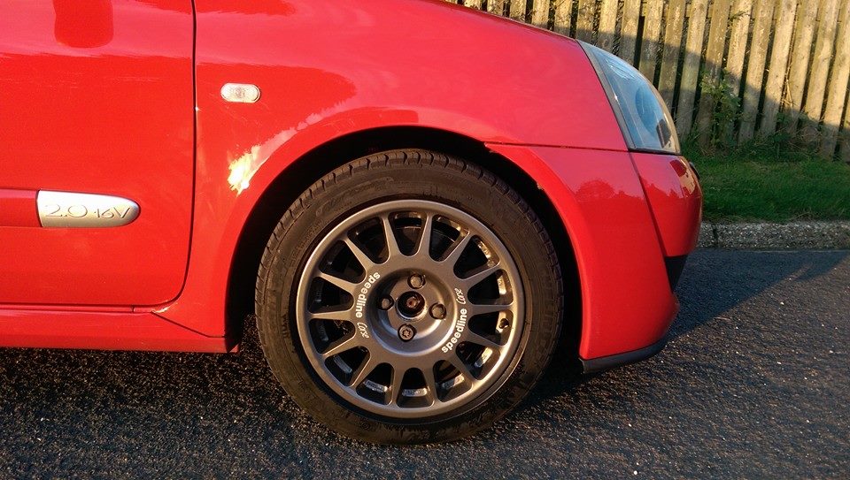

The first mod! Managed to swap my five Turini's (was given one as a spare) to a fella that had five 2118's!

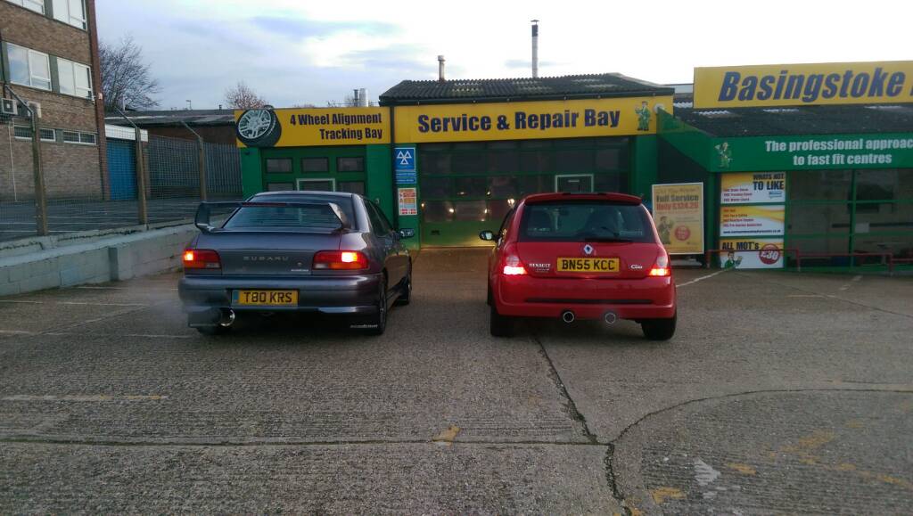

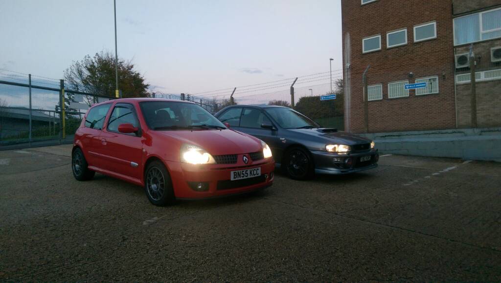

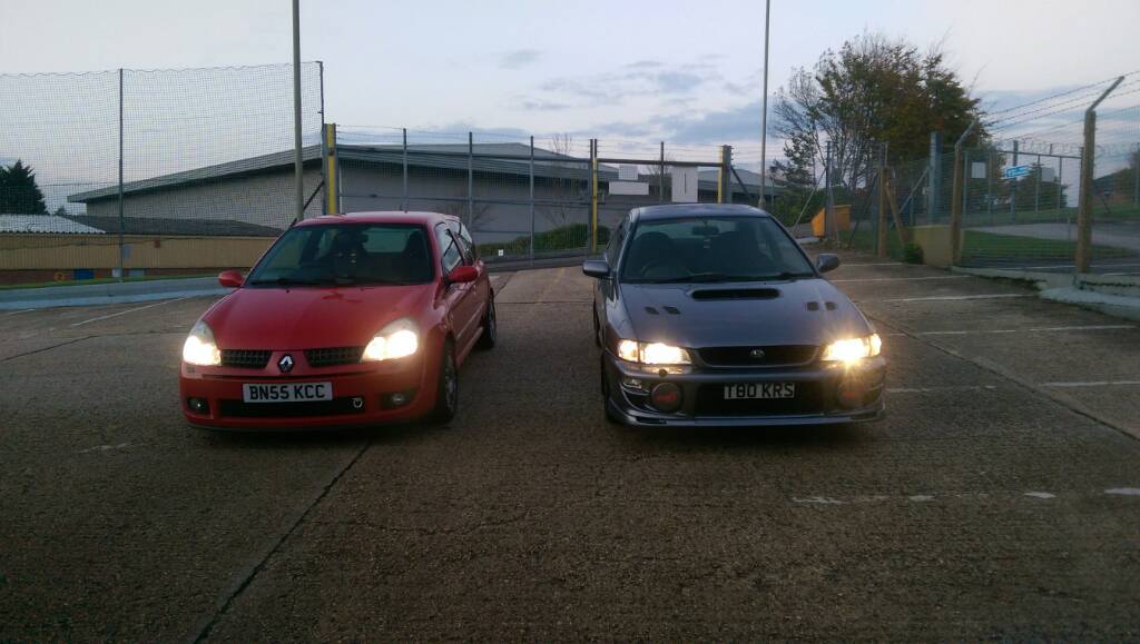

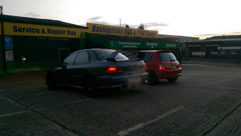

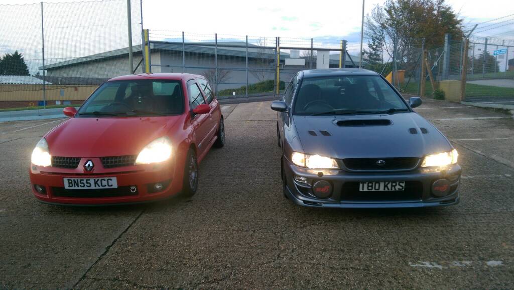

Mine and Kris's car at work after a tinkering session.

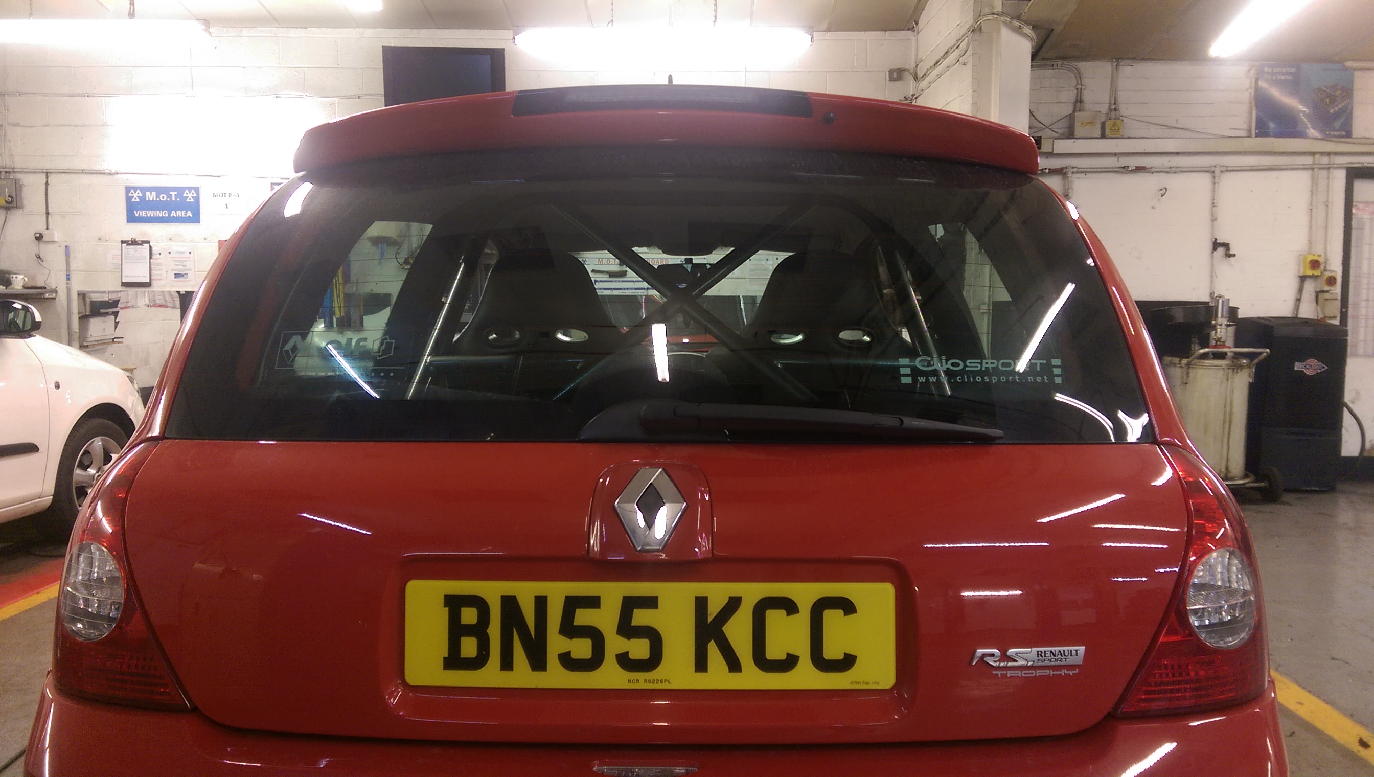

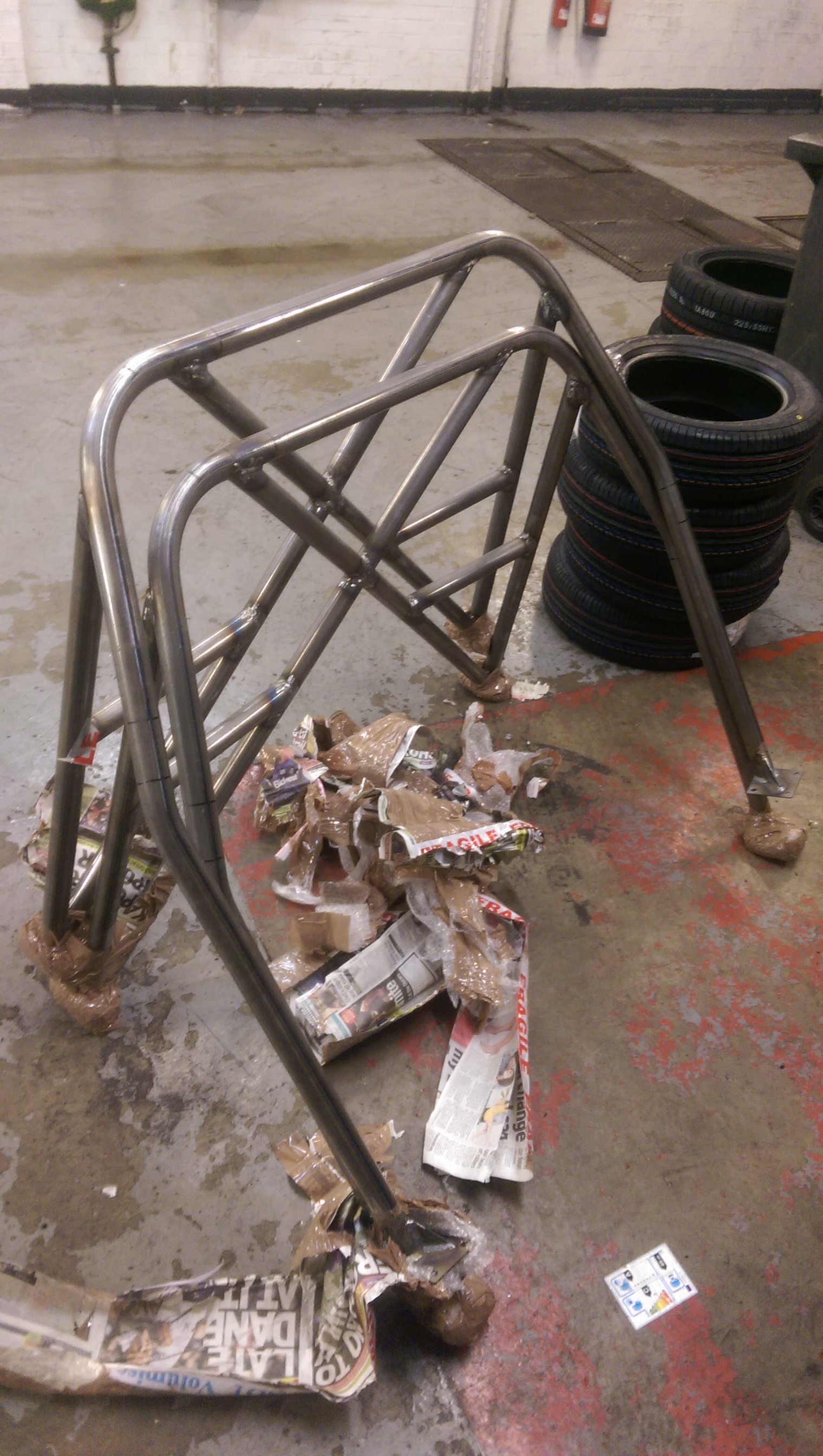

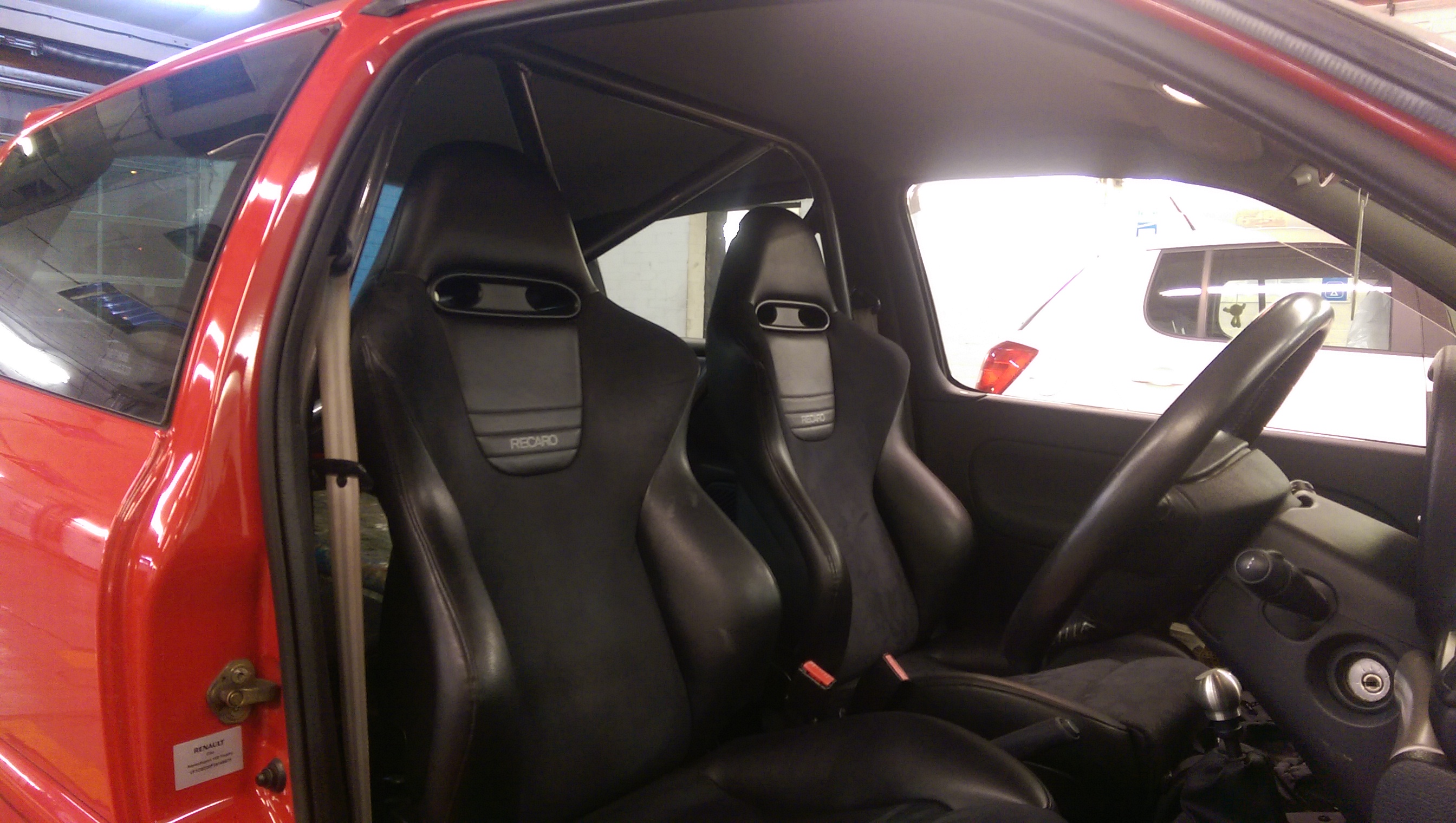

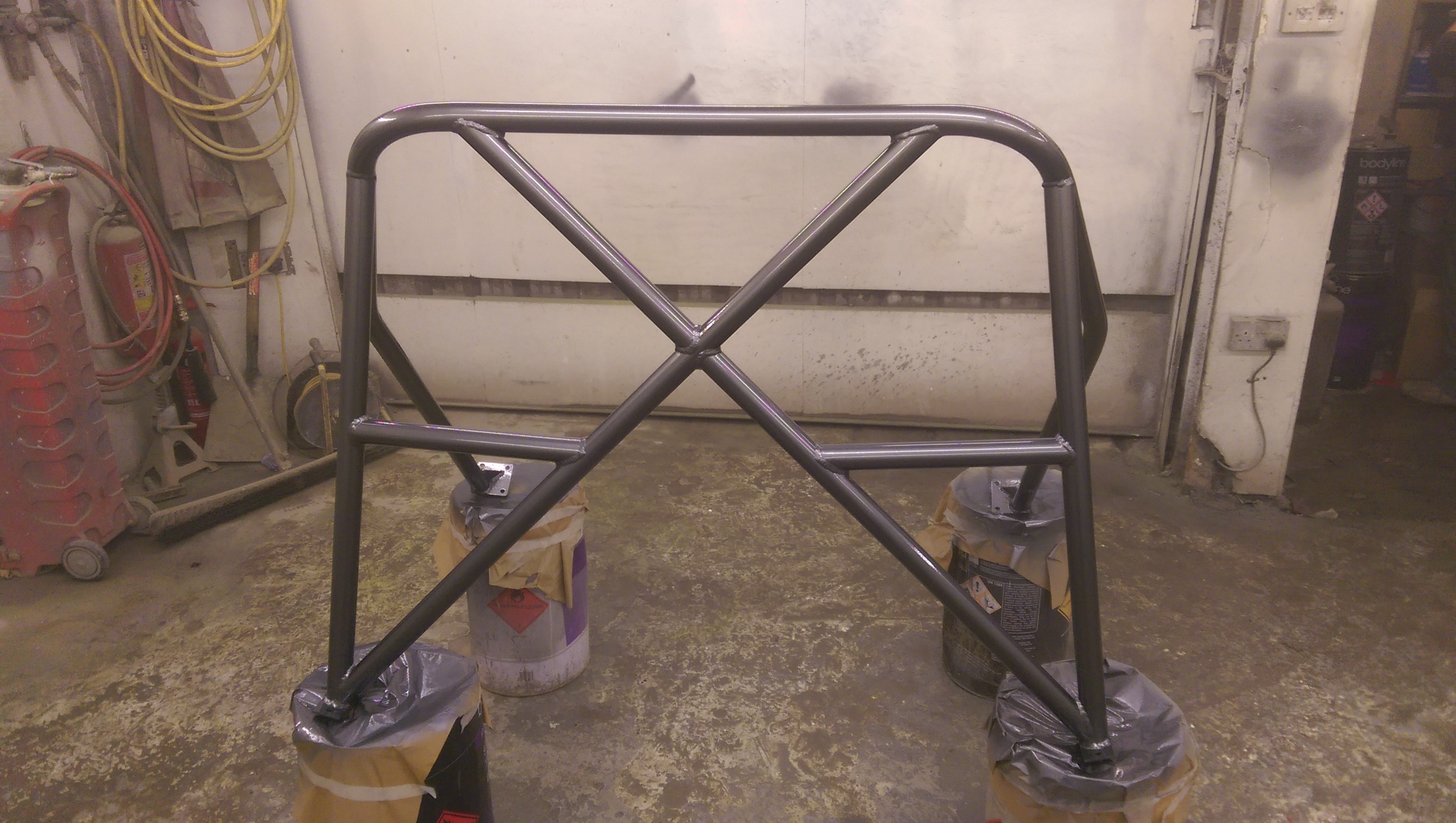

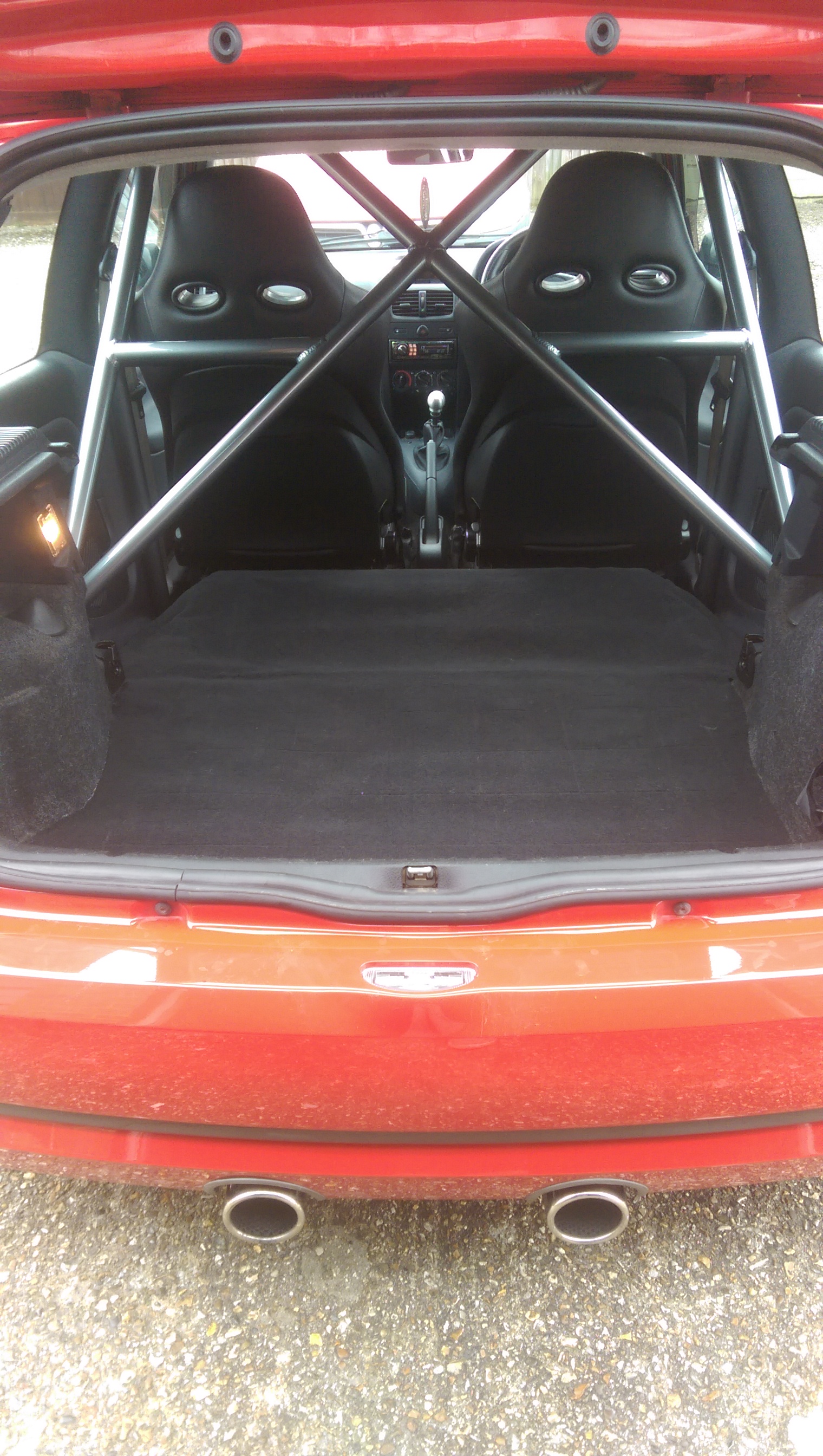

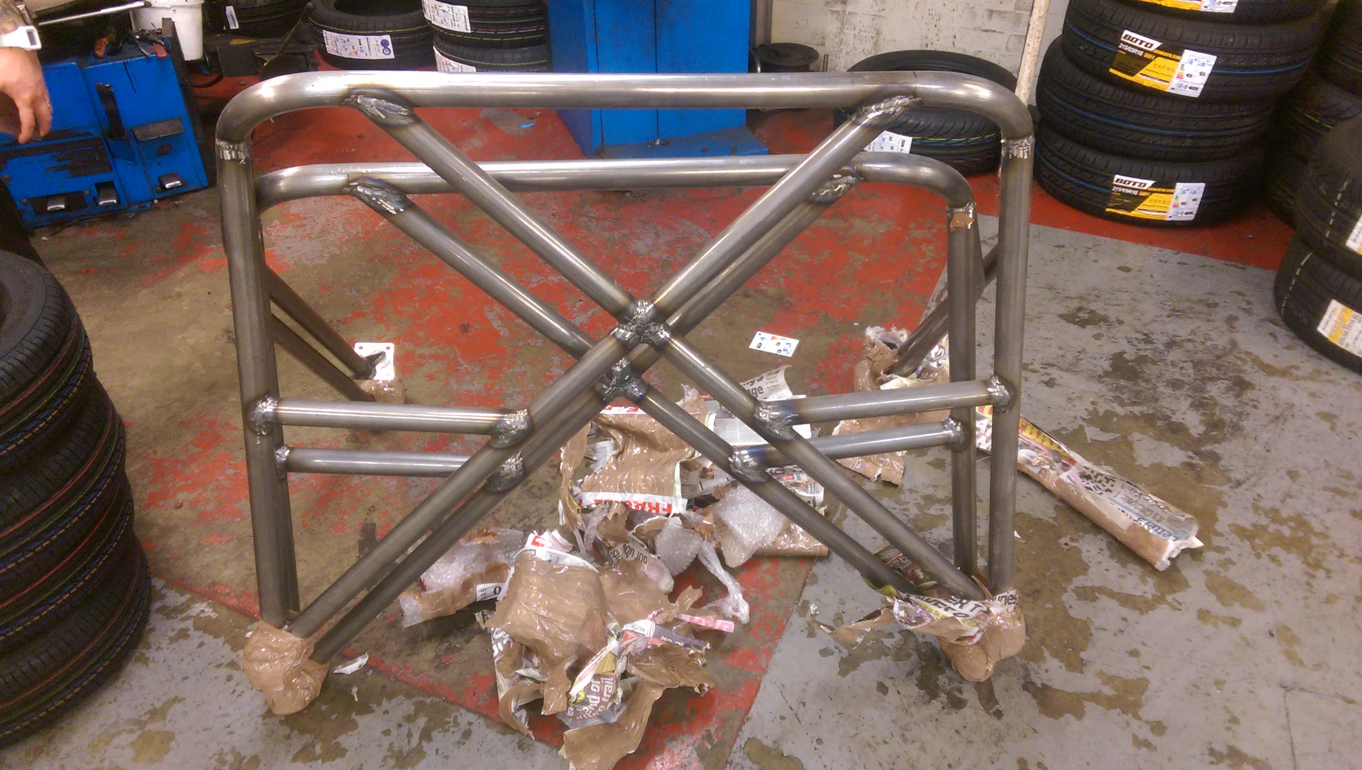

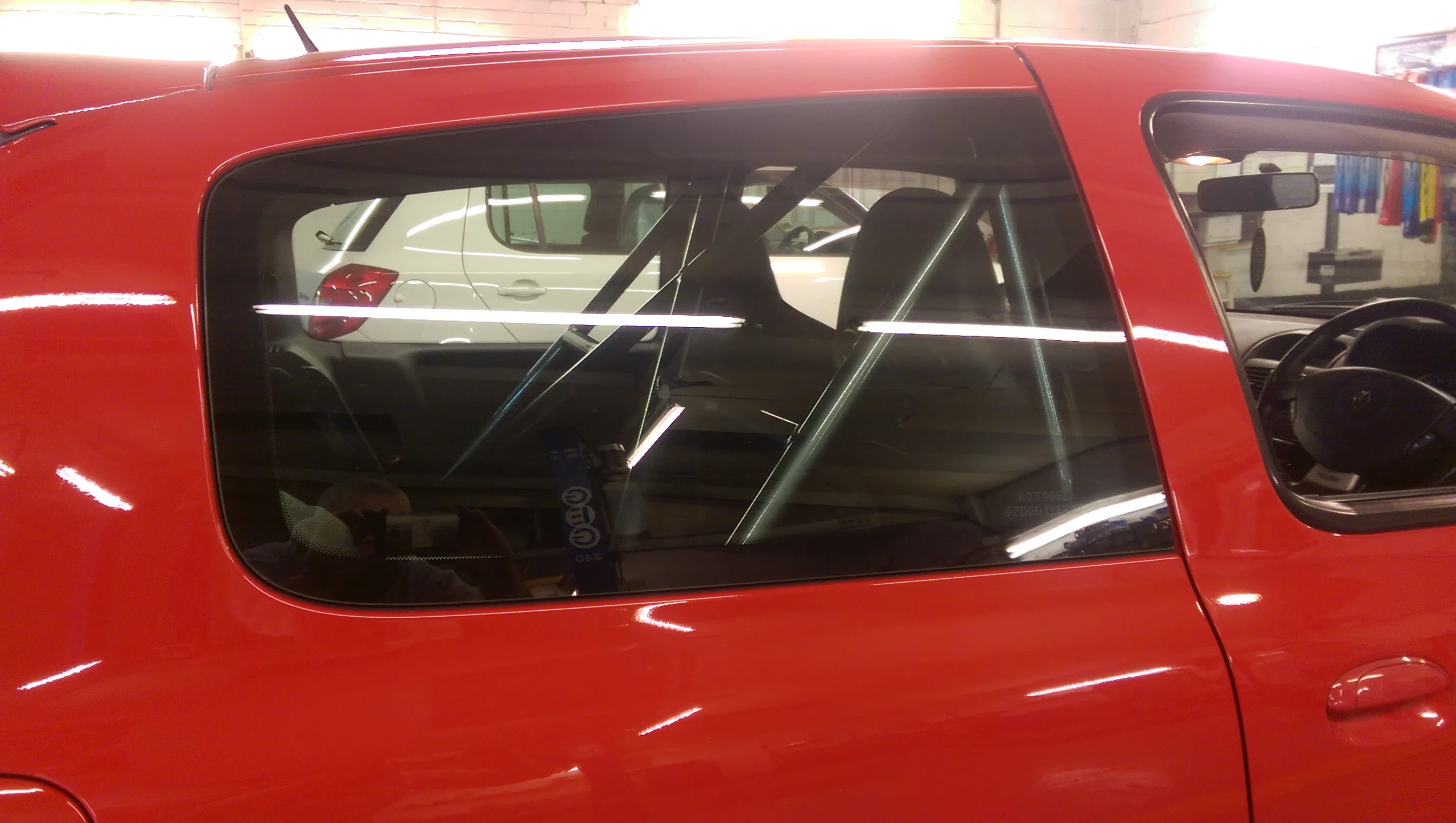

Ebay cage?
Thanks Jon,
Yeah its an eBay jobby, it's the same one that's currently on the group buy. But me and my mate bought ours before that had started. I can confirm they are really rather good for the money. Needed a little bit of cleaning up, and fitted them with 3mm spreader plates. Jobs a goodun!

Cars looking great John I've just ordered one of these cages for my trophy haha
how did you find fitting? did you go with the fitting kit alan supplied or make up your own? any chance of a few pics on the rear and how you've mounted it etc?
RMDavis
Thanks mate,
I will get some more photos up for you later. Fitting isn't too bad, definitely a two man job lol! Take both the front seats out and go in through the drivers door with the front plates as far forward as possible. Then once in pull the whole cage backwards! We didn't use Alan's fitting kit just bought some good quality bolts, washers and nyloc nuts. The spreader plates we bought on eBay ready cut plates 3mm thick. Once drilled the front plates went underneath the car and bolted through the rear footwells and then the rear plates we used two as a sandwich between the rear wheel arch. Then finally given a good coating of stonechip. It's a very snug fit and overall very good quality.

Ye pics would be great mate appreciate it! Any links to the eBay spreader plates and bolts etc?
