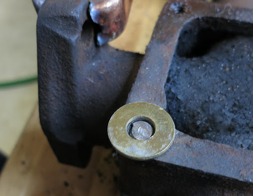

Hold a nut up to it and weld the centre. You'll be able to get a socket on it too
Make sure you put a washer in between the beam and the nut though
Like this
