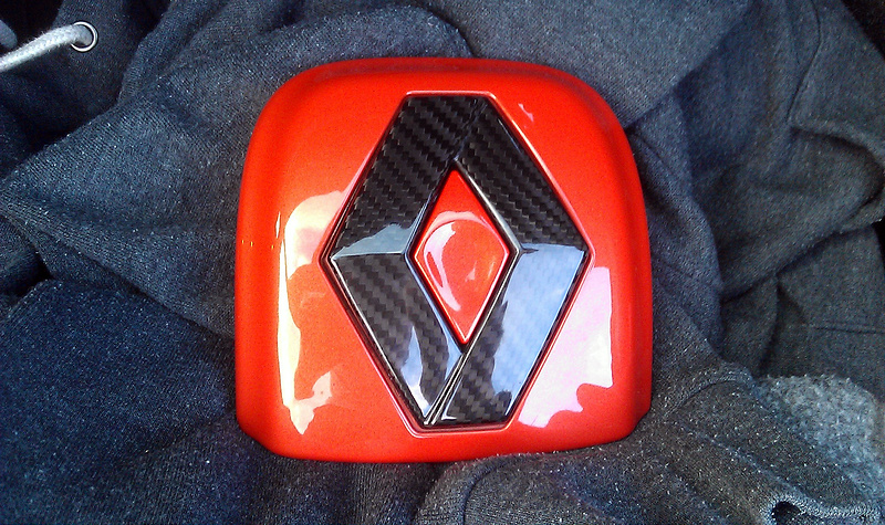

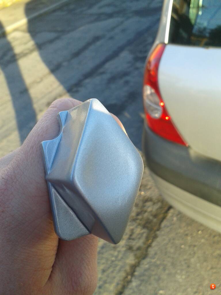

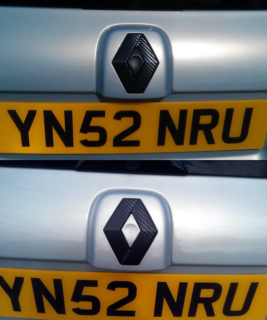

Have done it on both my Clio's. It makes a massive difference and should come like that standard IMO! :p
