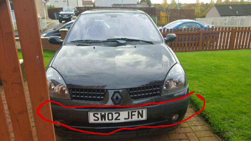

Hi there.
I'm looking to spray the front bumper inserts on my 1.2 clio dynamique to pearl black. Almost done a full color code and this is the only thing left to do. Any tips on how to do so? Any help or will be appreciated. Thanks!
Tomo_Rep.97
They just pop out with a bit of pursuasion! I did mine mate, have a look in my project thread <--- take the edge ones out first twist the plastic so it makes the clips easier to pop out and then the same with the Middle part just work your way through the clips. They shouldn't break if you do it right. Saves taking the whole bumper off.
