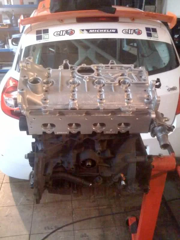

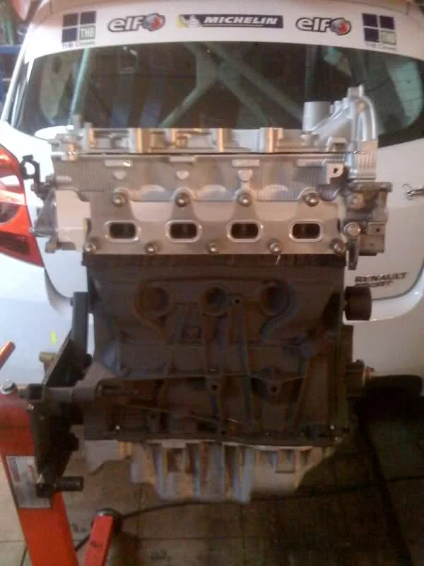

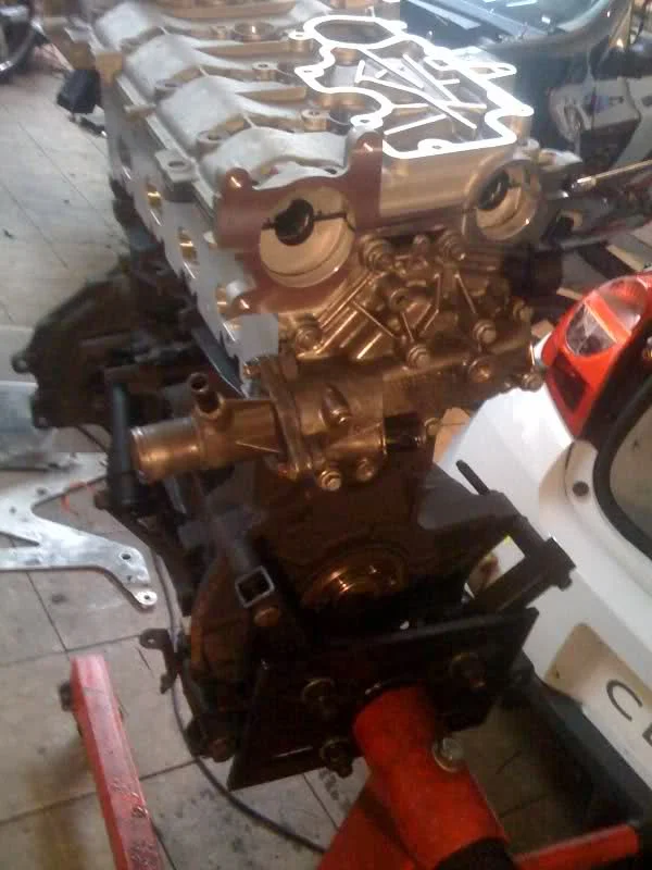

Built this over the weekend for the Super Cup and for Super-2000 inlet manifold testing:
Not a bad weekends work.
Spec is fairly boggo F4R 736 but with a bit of safety added for sustained high RPM use.
- Brand new F4R 736 Cylinder head incl valves, seats, guides, springs, seals etc. etc.

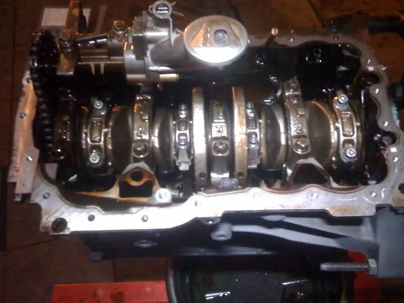

- Standard bottom end bar ARP 2000 big end fasteners
- Cometic MLM head gasket
- New roller rockers and lifters
- Few other bits.
It will get the CAT428's from my current engine along with new timing gear, clutch etc. etc.
Just need to find the time to get it into the car now!

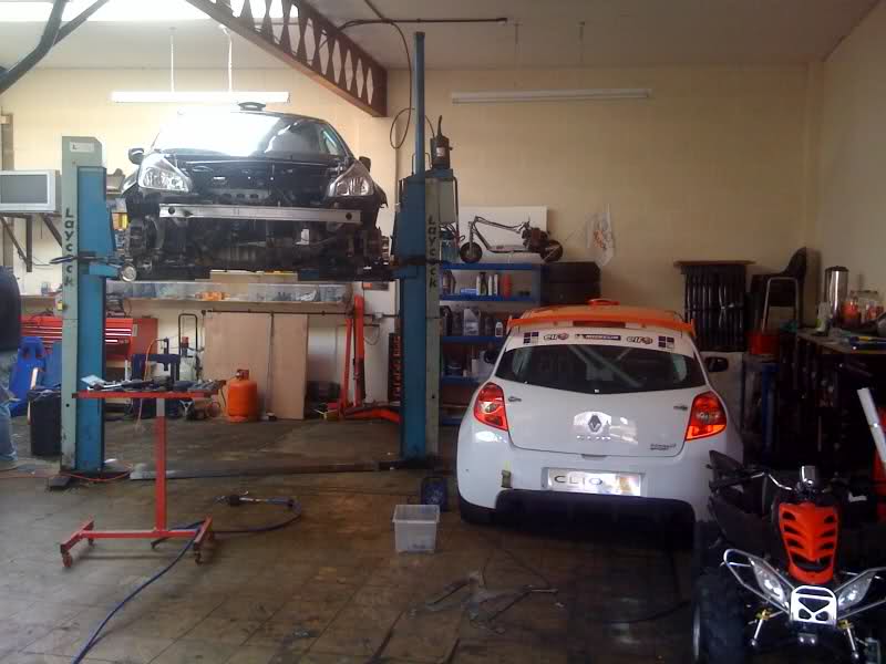

Pop down and have a butchers mini. Few interesting things in the workshop at the moment - including the two X85's for this seasons Britcar Production Championship!

Will do mate! Be interesting to have a look round the x85's and compare to the 3 Amery run!
That quad looks like fun TBH :D

The BPM Racing Quad ;-) Use it to tow the track support trailer with for fetching tyres etc. etc.
Quality made in China "Oh s**t the brakes don't work" quad LOL
Pretty sure Amery's X85's don't need 120L of fuel to fill the tanks ;-)
Cheers
M
BPM X85's = standard tank + ATL saver cell + ATL Dry Break Fueling and 25 litre dump churns ;-)
25 litres into the car in 7 seconds so great for splash and dash. If we were allowed to run fueling towers we could tank the car in under 10 seconds!

The quad has a gear pedal............ but the Clutch is on the handle bars........... I'm glad you're better with tyres than you are with pit equipment ;-)
