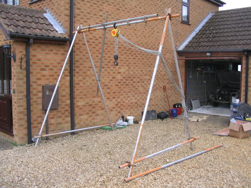

couldn't you knock up a quick a frame from all that "scafolding" you bought and then get a small winch. i know you could rig somehing up
It has been done before lol..
Too much effort though, may aswell just buy a crane lol.

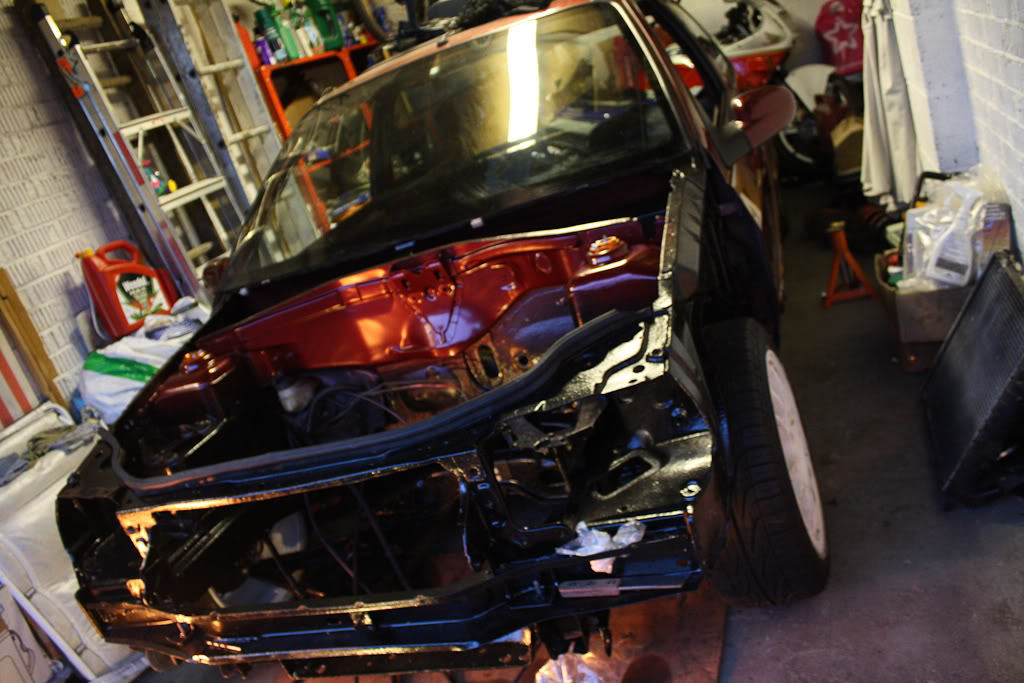

Update on the latst week

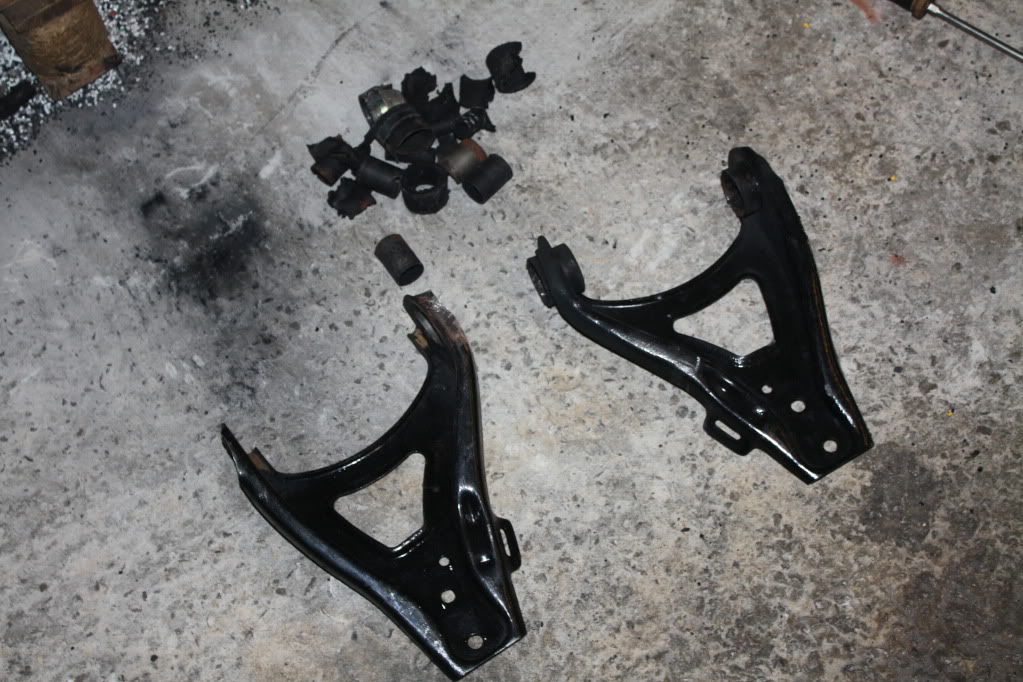

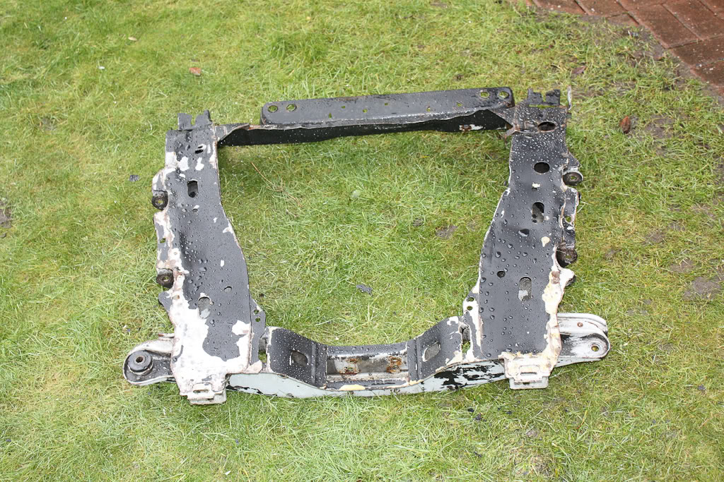

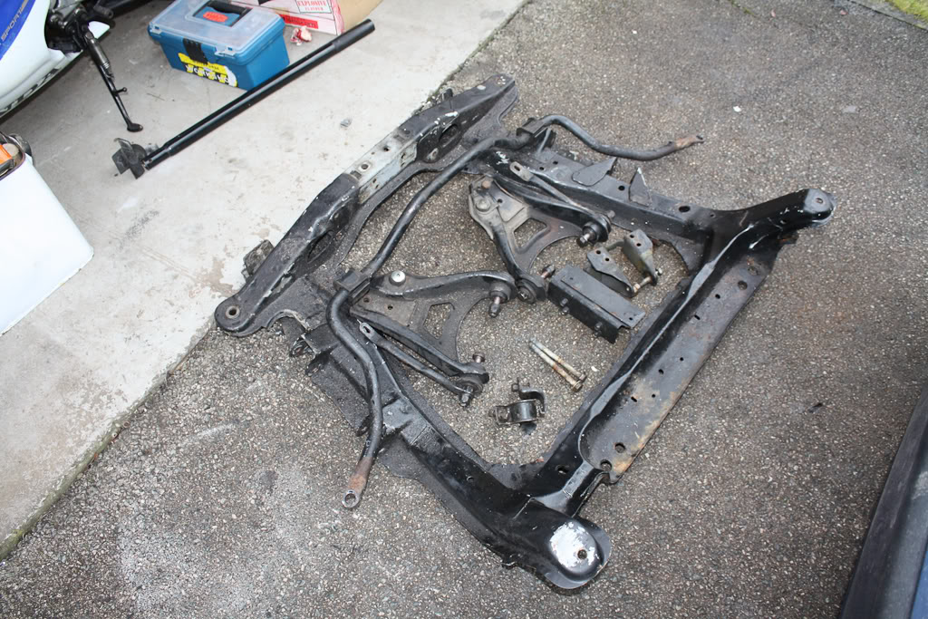

Started off by taking the subframe apart so we could get the wishbones out ready for the 172 ones, replace the valver anti roll bar with a willams one and then all new bolts and new poly bushes for when it finished
All apart, valver parts now forsale
Wot does the williams one look like ive been told its white and triple skinned

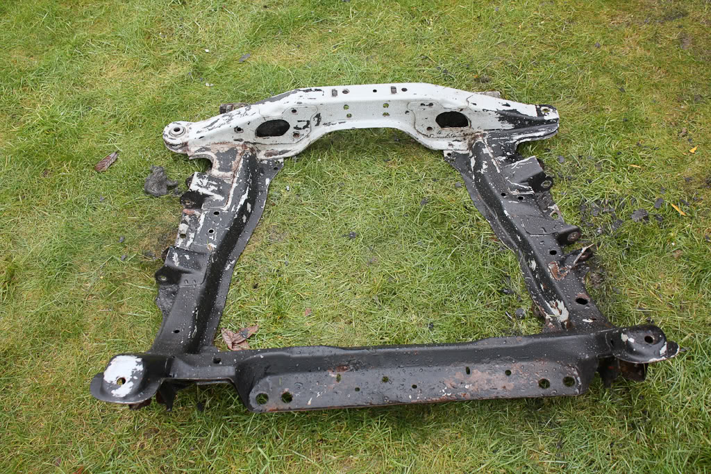

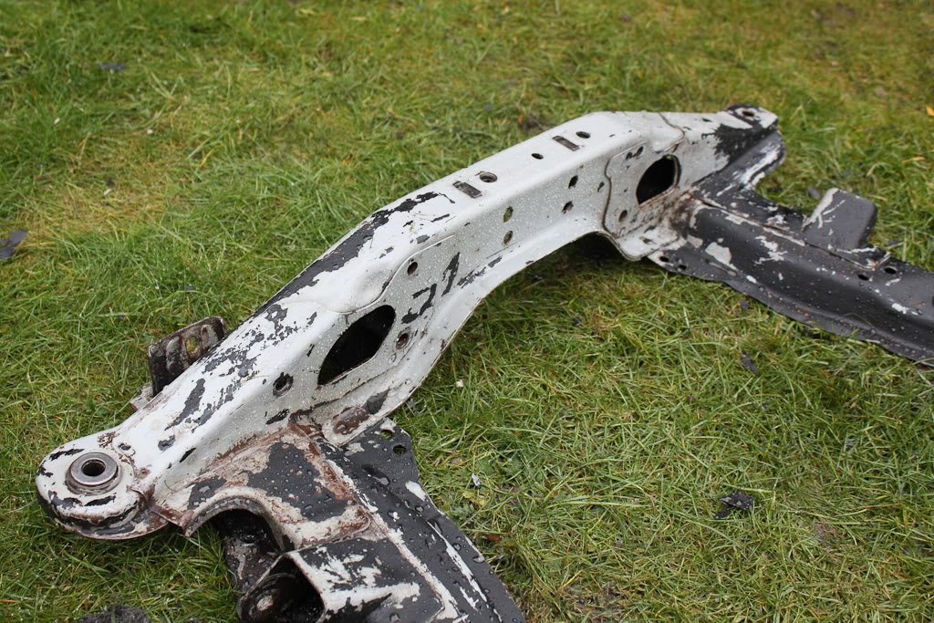

Gave it a good clean with the hosepipe and wire brush

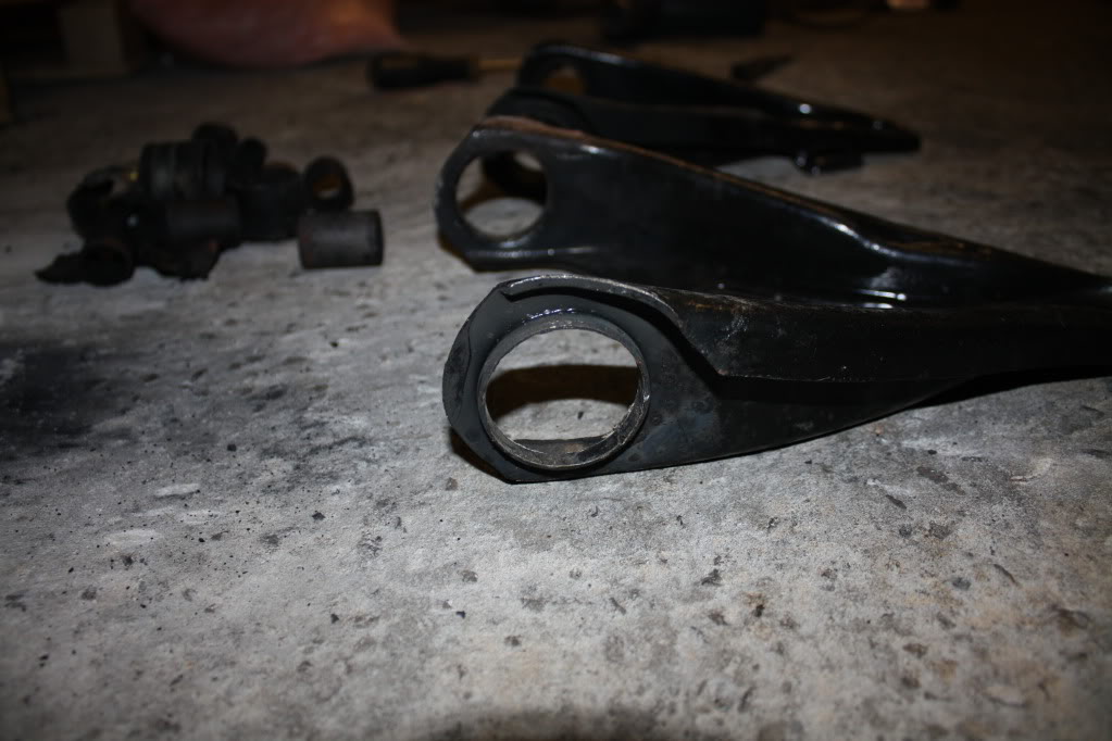

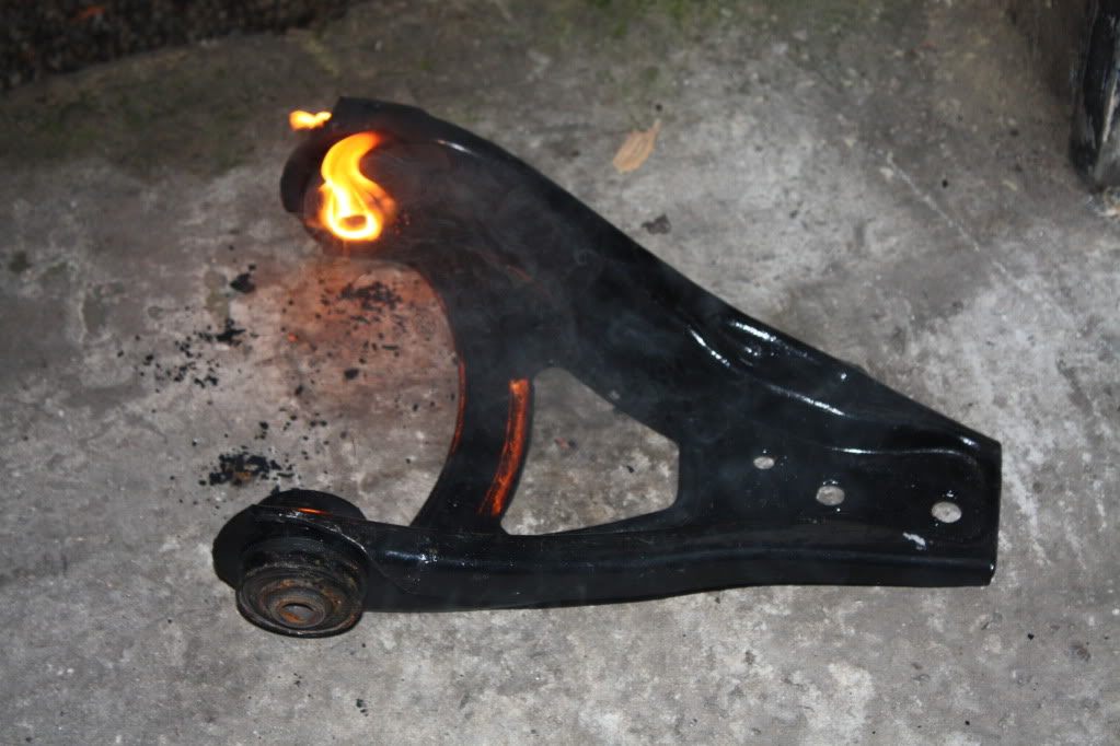

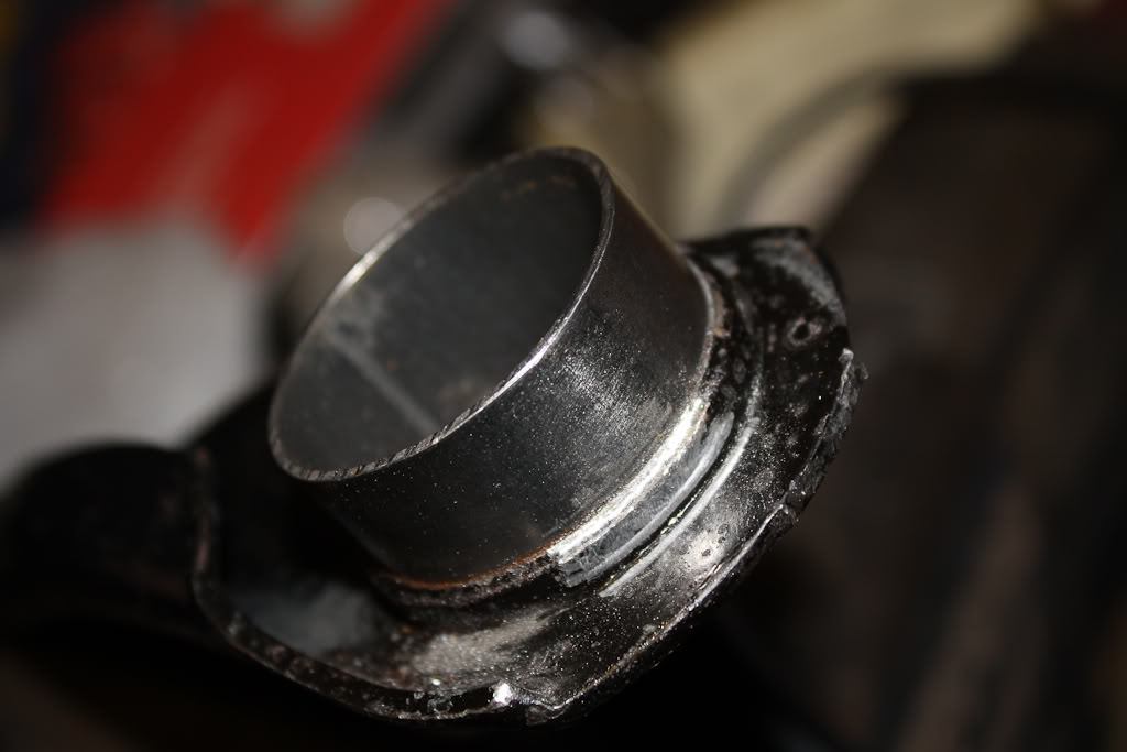

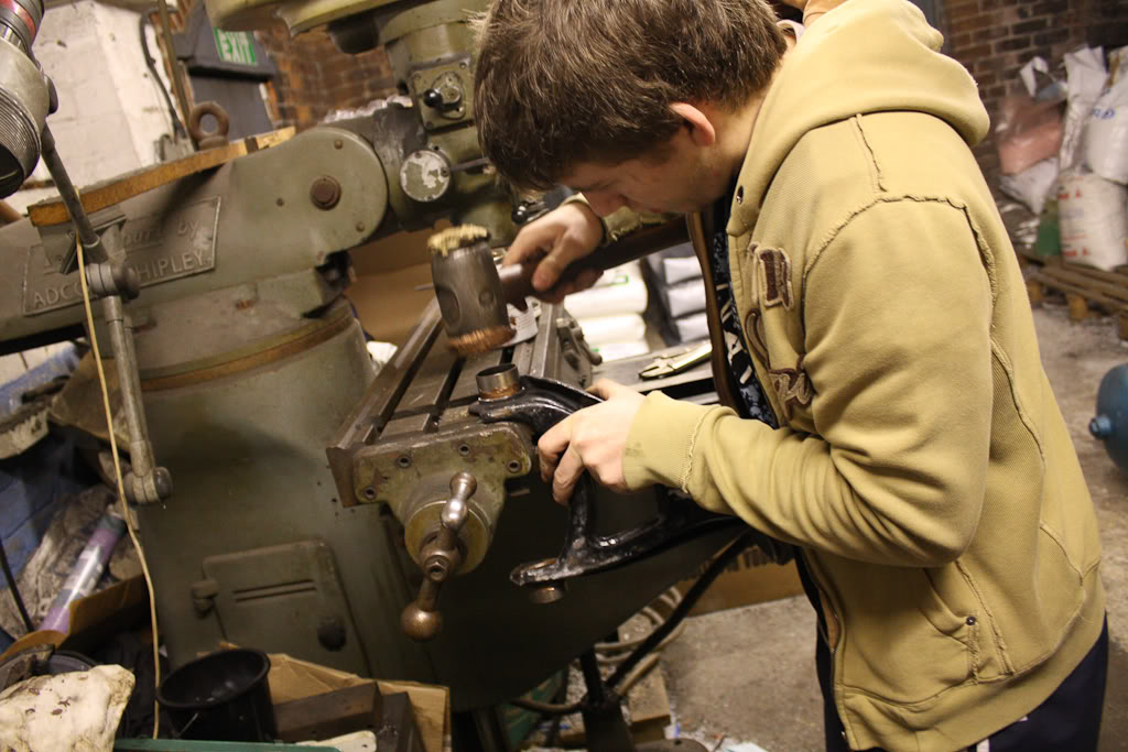

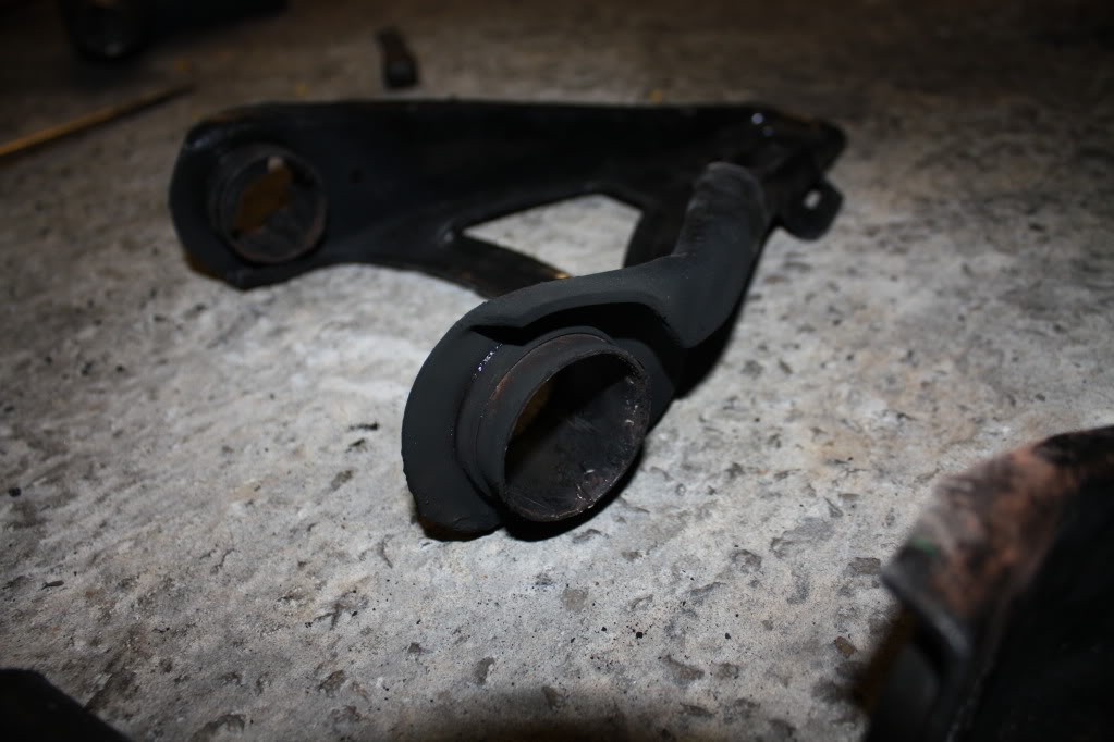

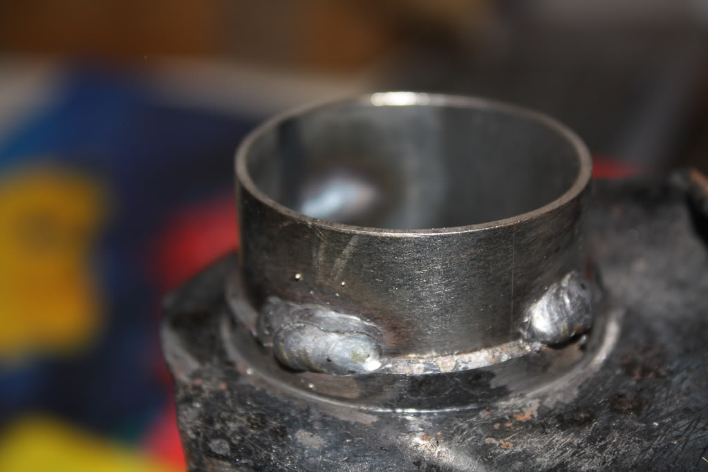

Took the 172 wishbones to the factory to burn the old bushes out and then to cut the old metal sleeves out ready for the new poly bushes and metal sleeve to go in
Both burned out and one with the metal sleeves cut out and all the mess from the both of them
Cut out one
One that still need to be cut out

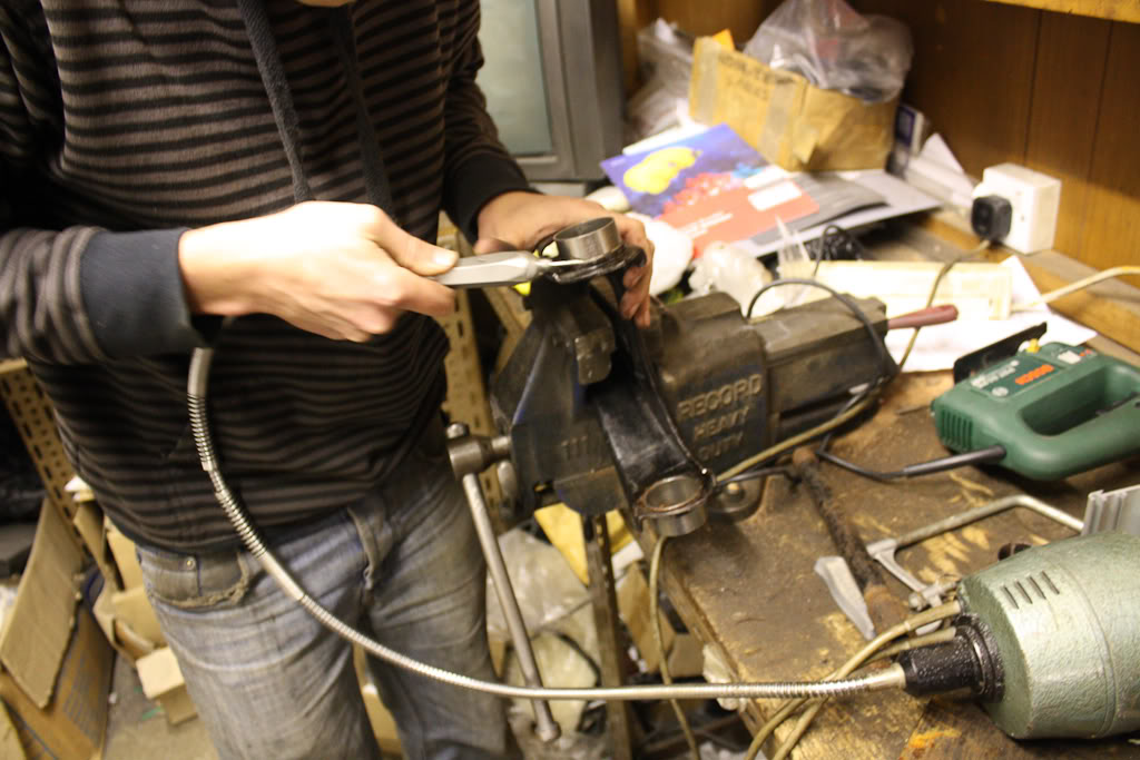

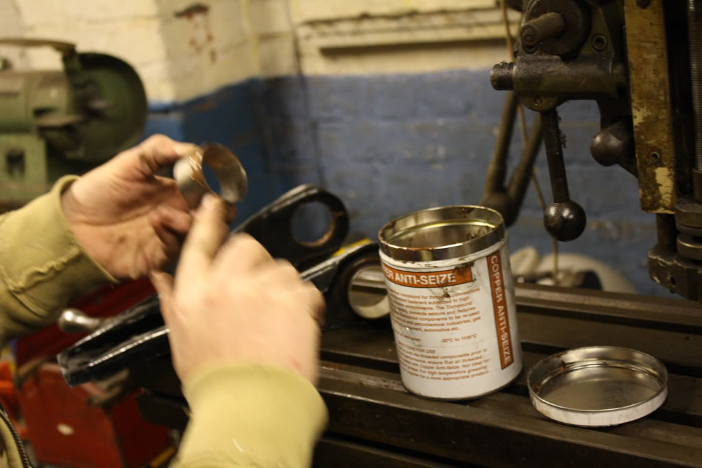

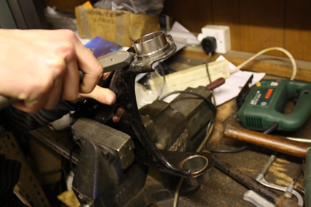

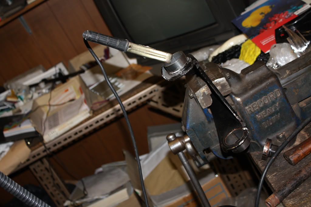

Once all the metal sleeves were out we set about putting the new ones in
Lots of copper grease is the key to hammering them in

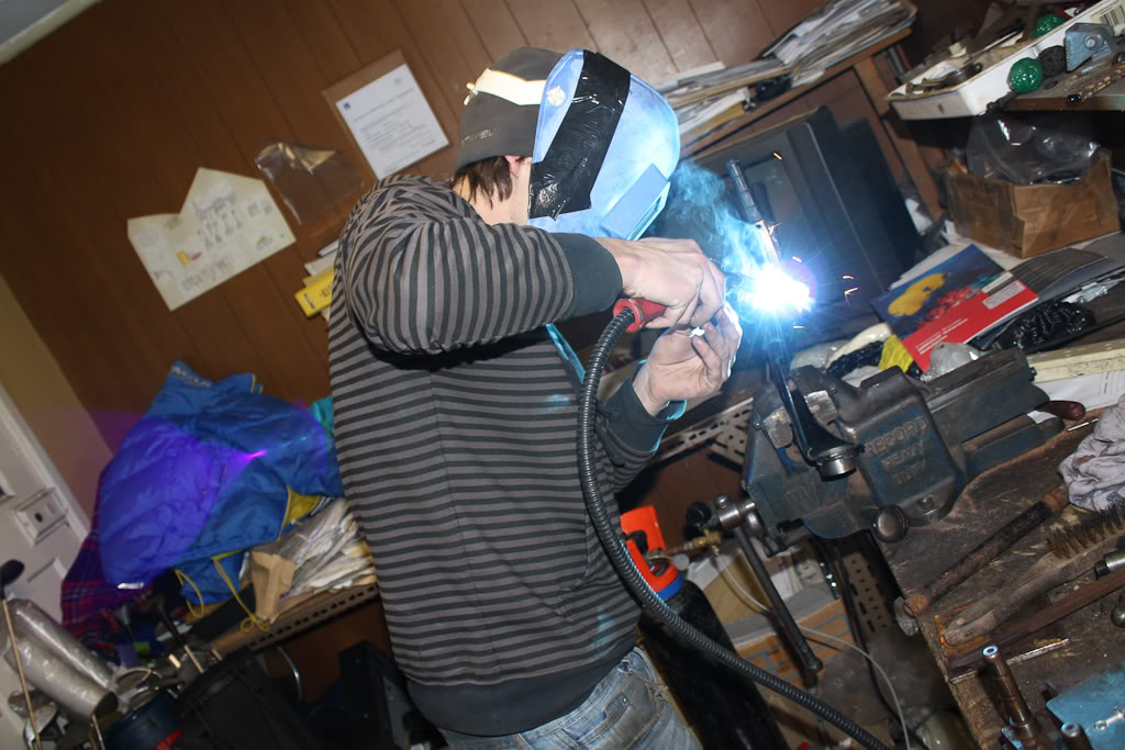

Once all 4 were in f0xy then ground round the sides ready for welding/tacking in place

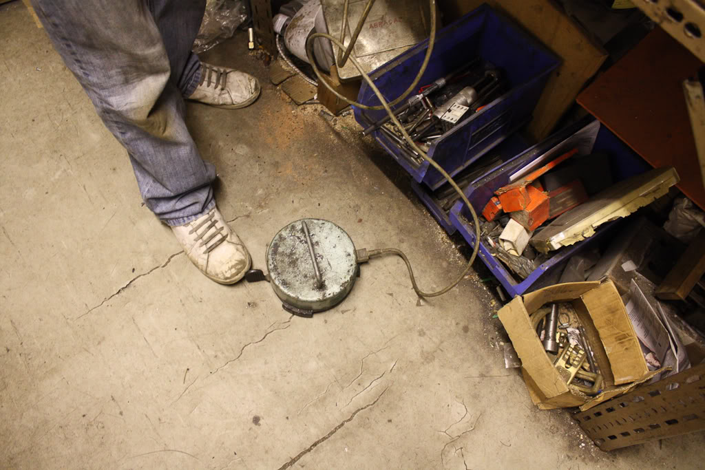

How old is this machine its even got its own foot pedal to work it sounds funny too
All ground down and ready

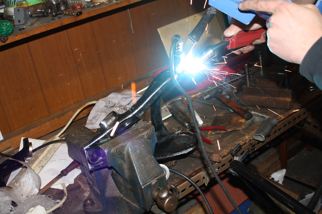

Welding in progress
All tacked and looking good ready for some nice couloured bushes to go in

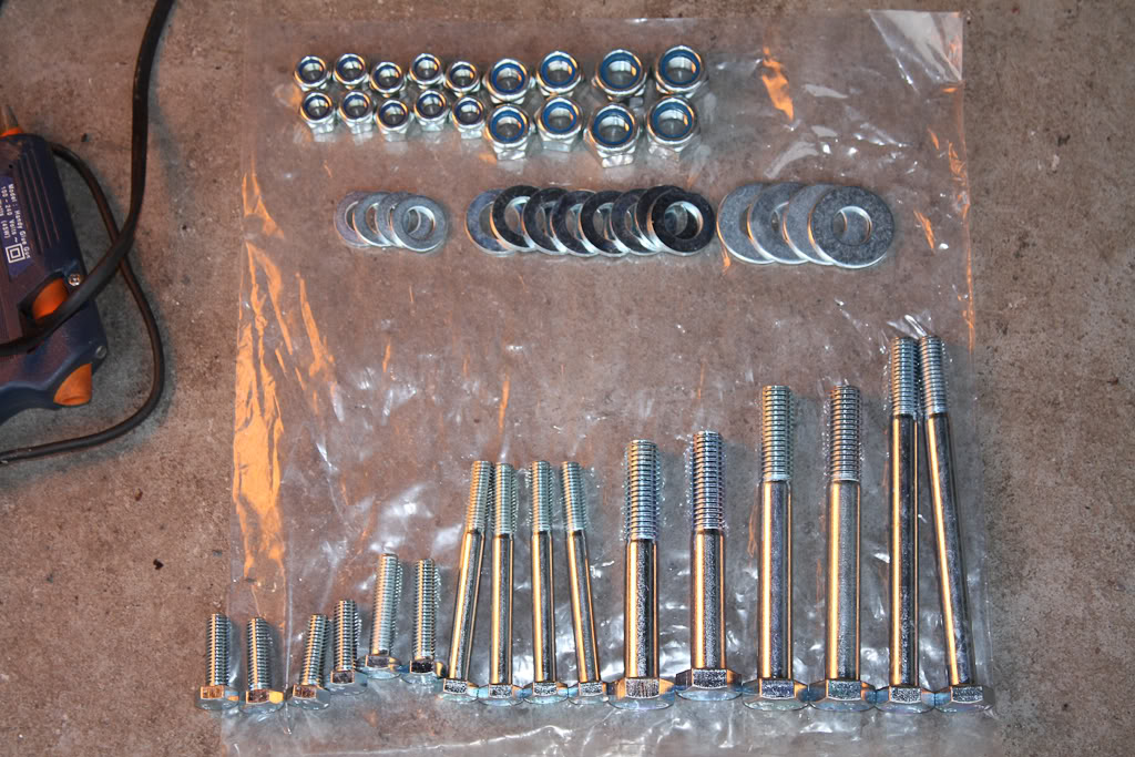

Picked up new bag of bolts and washers to replace the old ones in the subframe

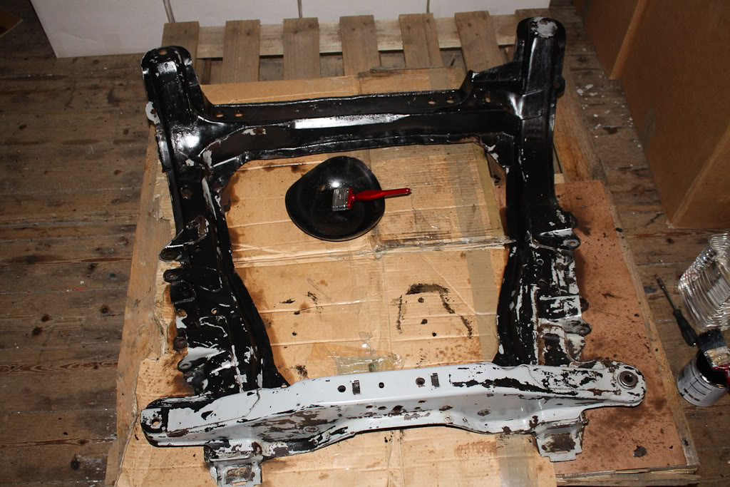

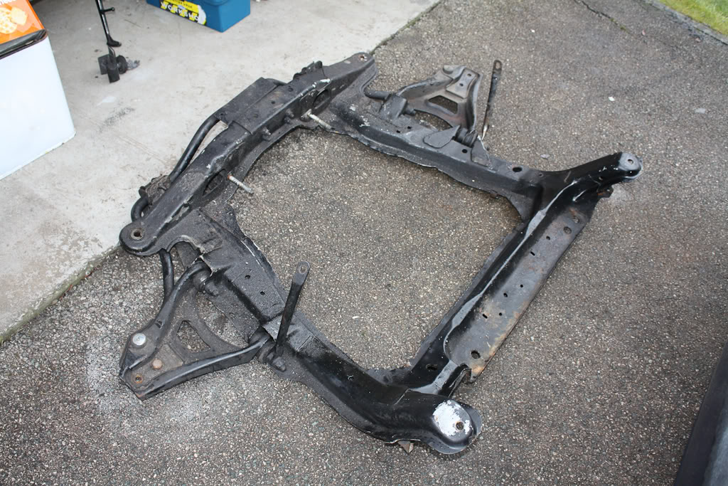

Gave the subframe a good wash down with some Gunk to get the rest of the muck off
Subframe was then wiped down and a few coats of paint added same with the 172 wishbones, no pics of them

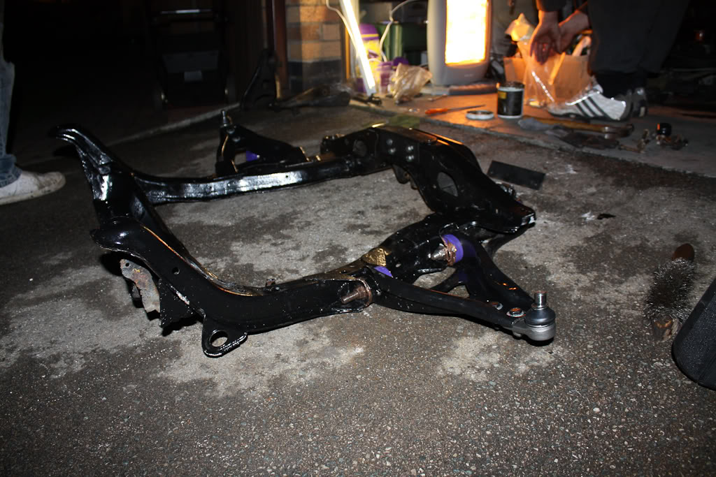

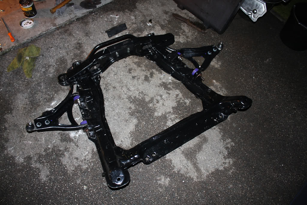

Got the subframe home and then started to build it up with the new stuff
Williams anti roll bar with all new polybushes and bolts
172 wishbones with new polybushes and bolts
Lots of copper grease used in fitting the new bushes verry tight fit

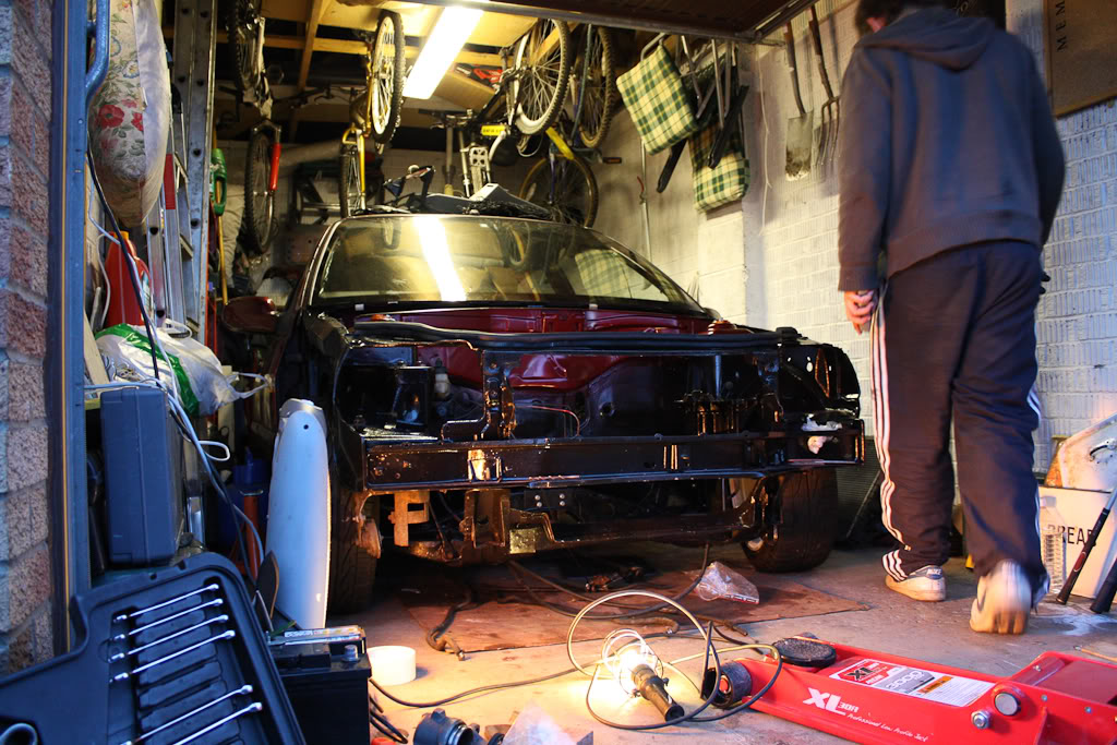

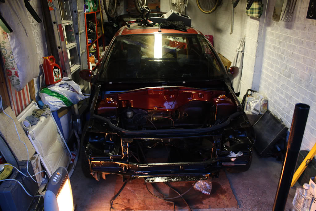

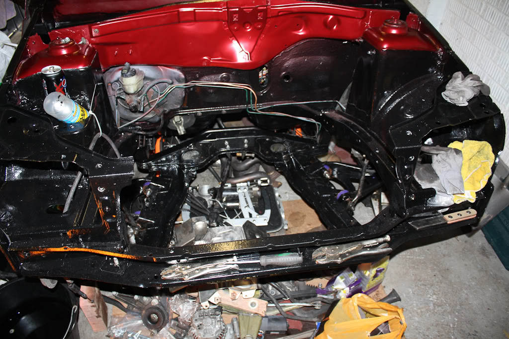

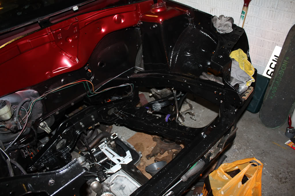

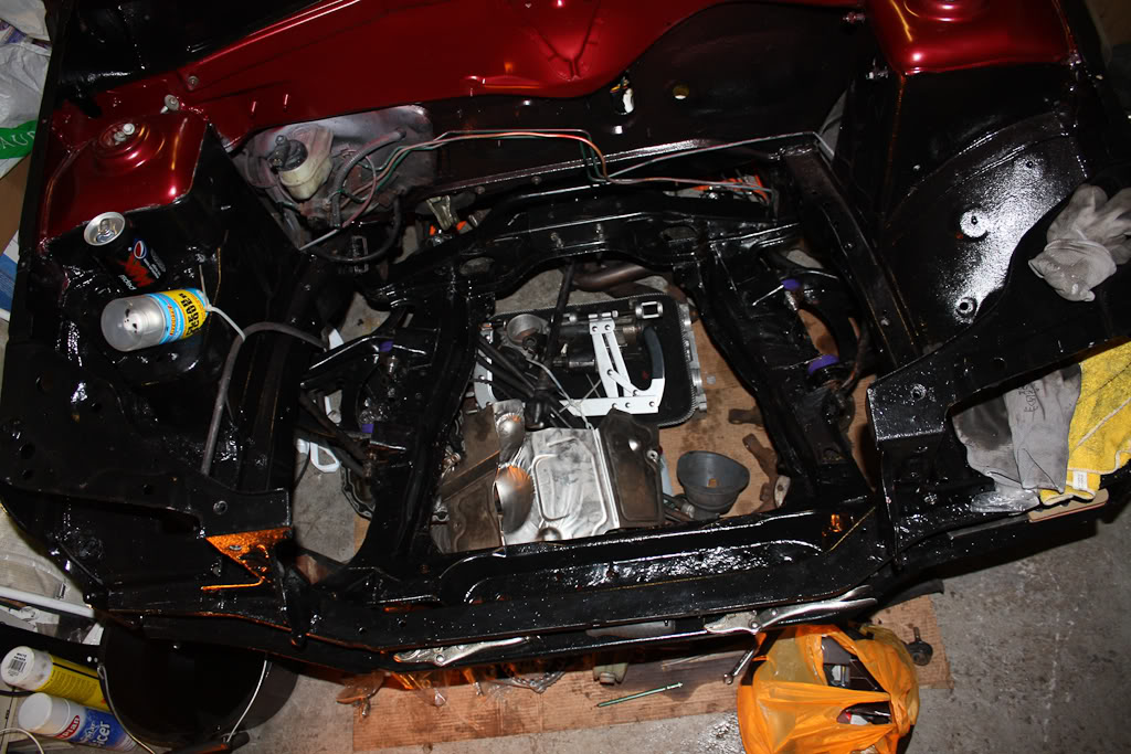

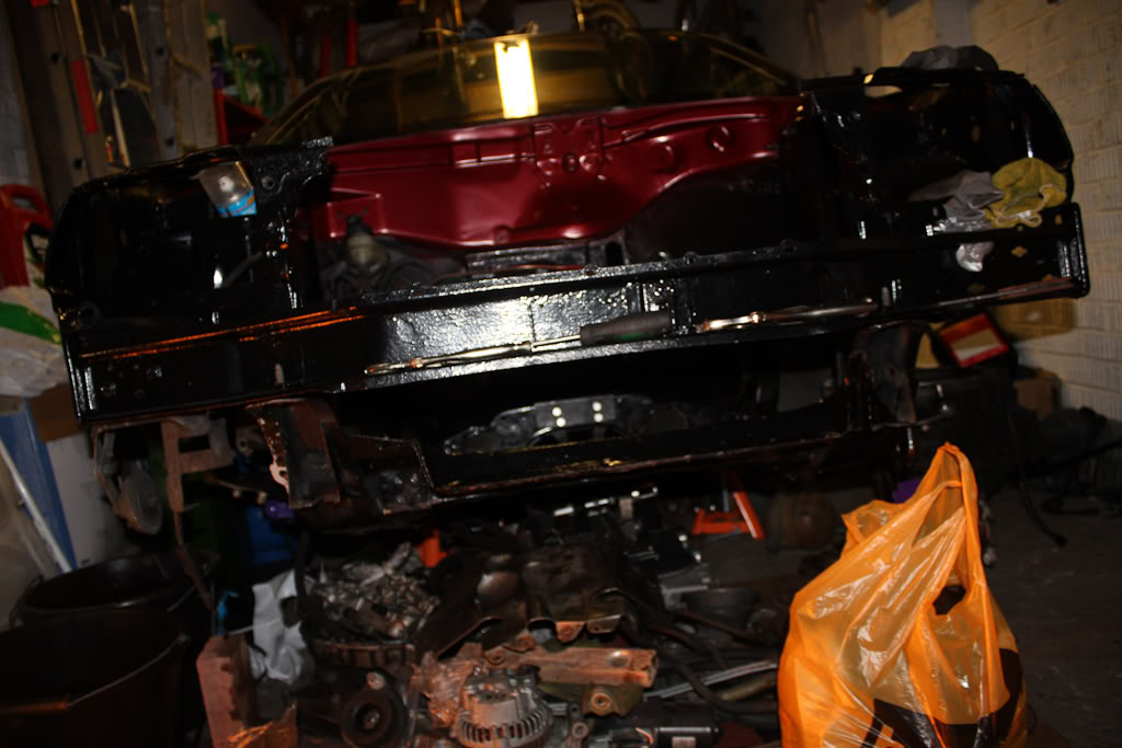

We then dragged the subframe in and put it back on the car

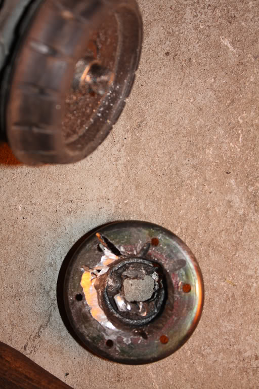

I still have the challange of getting the old susspension off the car as the allen key bit on the top rounded on both sides, i ether have to find someone to lend a buzz gun from or buy one. Bad times :mad:
Cheers wilky ill bare that in mind if i cand get one in the next few days
Subframe is looking nice and fresh
I have also put new ball joints on too

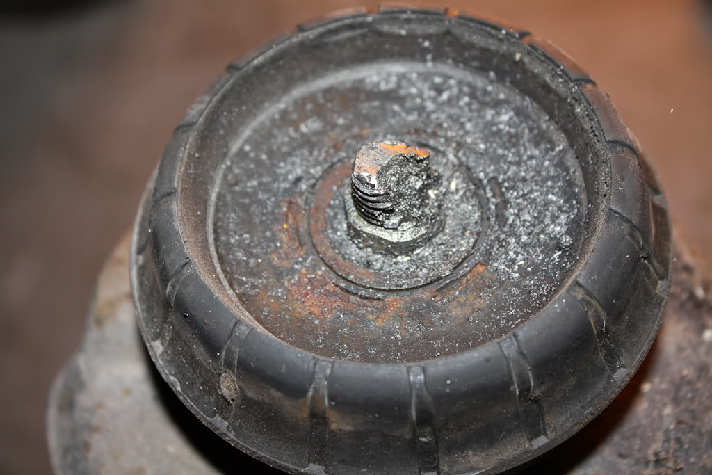

Been trying to take the suspension off yesterday and today, before when i tryed to get them off the allen key part rounded off (Badtimes) so i was humming and harring how to get it off, since i dont have a impact gun or a air compressor i thought the best way to get it off would be to drill it out, well its only taken me the best part of 2 nights to get one side off, here is wot the damage was to the bolt and suspension
Topmount and nut
Suspension top

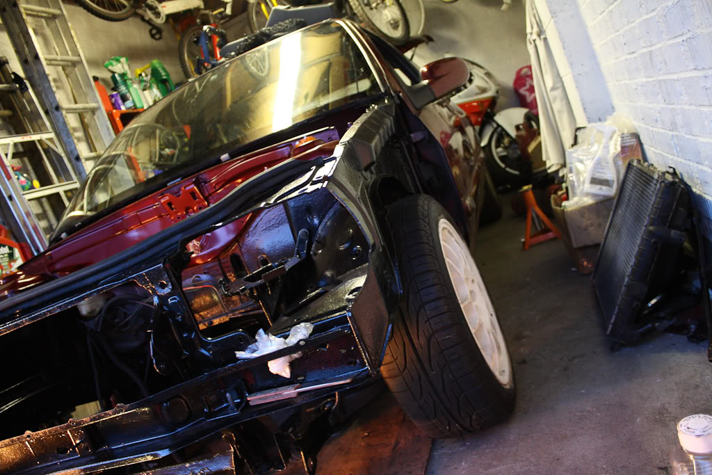

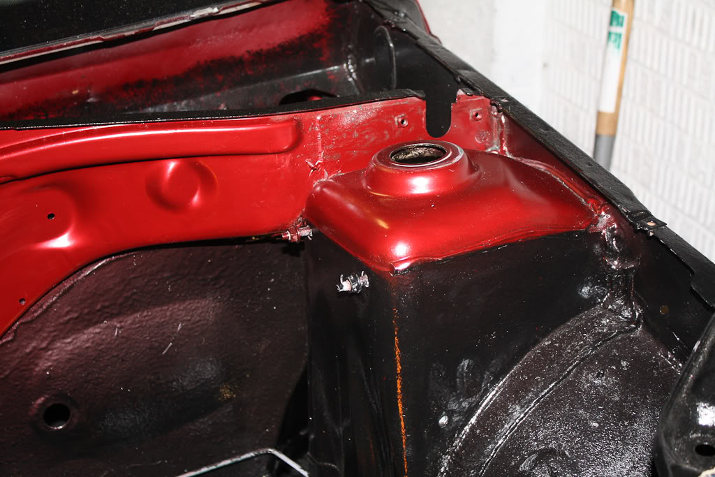

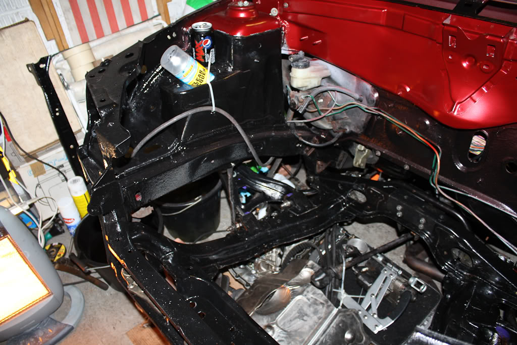

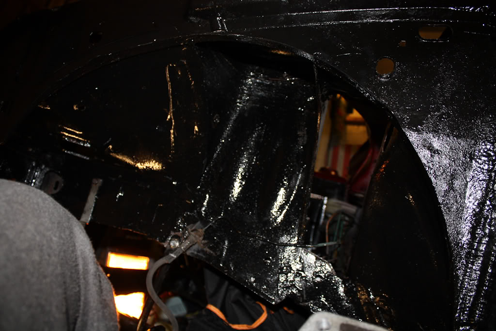

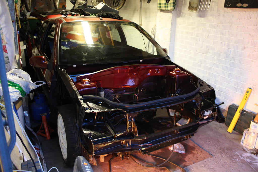

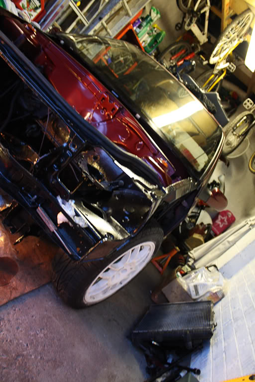

Also got round to painting the inside of the arch looks miles better now

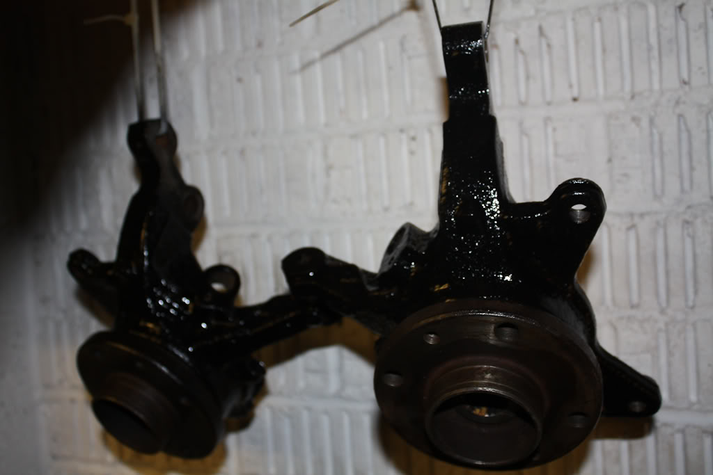

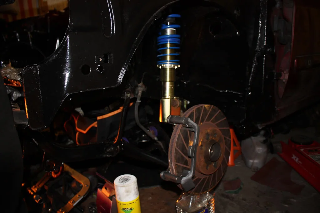

Painted the hubs ready for going on
more to come
Got a little more done on the car today, started off by lending one of my mates electric impact gun, took me the whole of 10 seconds to get the other topmount off not like the other one. Once it was off i then sanded the strut tops and the bulk head down and then gave them a coat of paint again ready for the AST topmounts and FK suspension also fitted the hub too.
Im in need of quite a few bolts, the ones i got with the hubs are all rotten and the threads are broke on some so im going to see wot i can get from the bold place tomorrow, also im on the lookout for most of the engine bolts as i didnt buy a full engine and dont have them and really need to get some asap

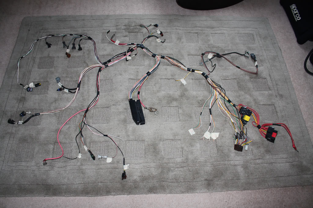

Since ive got to wait for these bolts to come from KAM Racing for the ast solid topmounts, that means i cant put the car on all fours yet, ive been craking on with the wiring loom, im no electrician so ive just been folowing f0xy guide, cheers for that or id have no chance of doing it.
Here is wot ive done so far

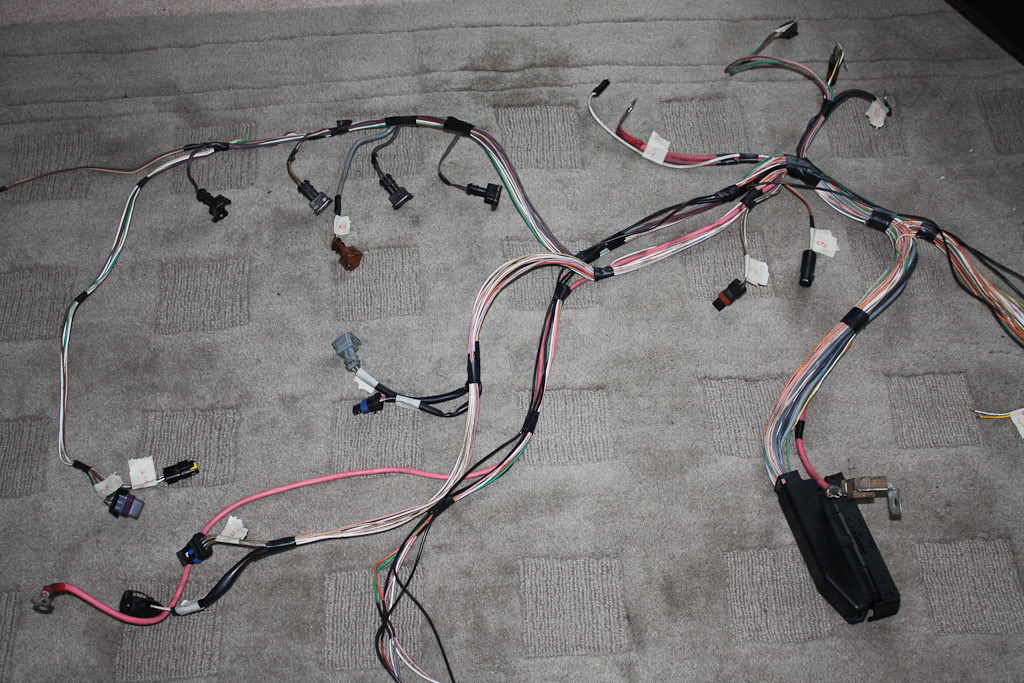

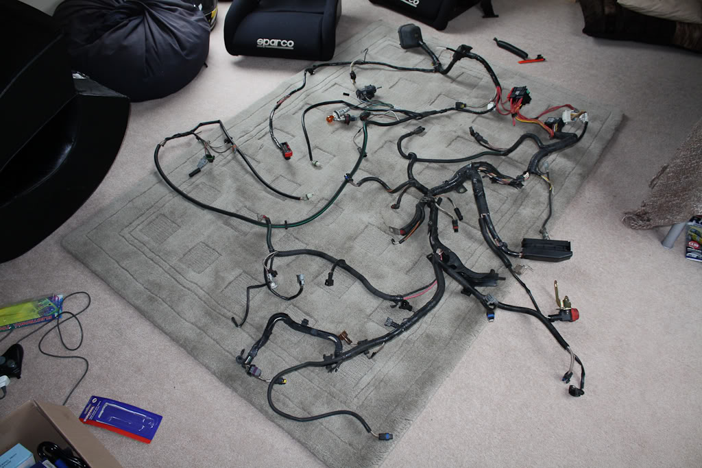

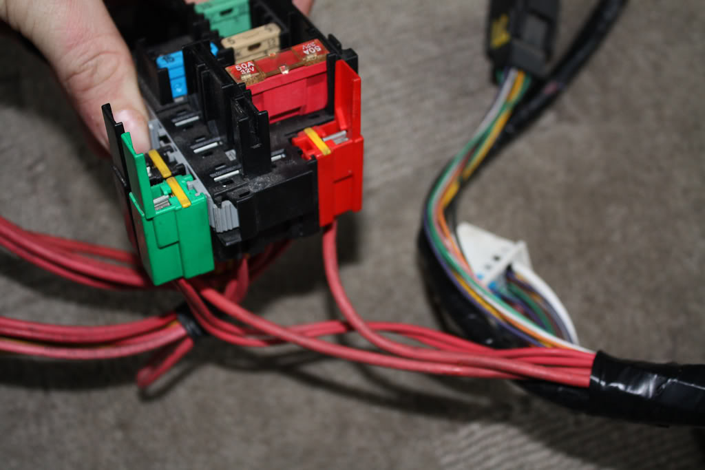

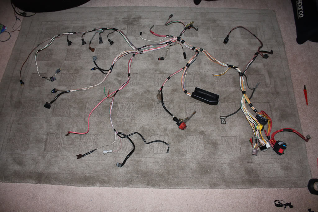

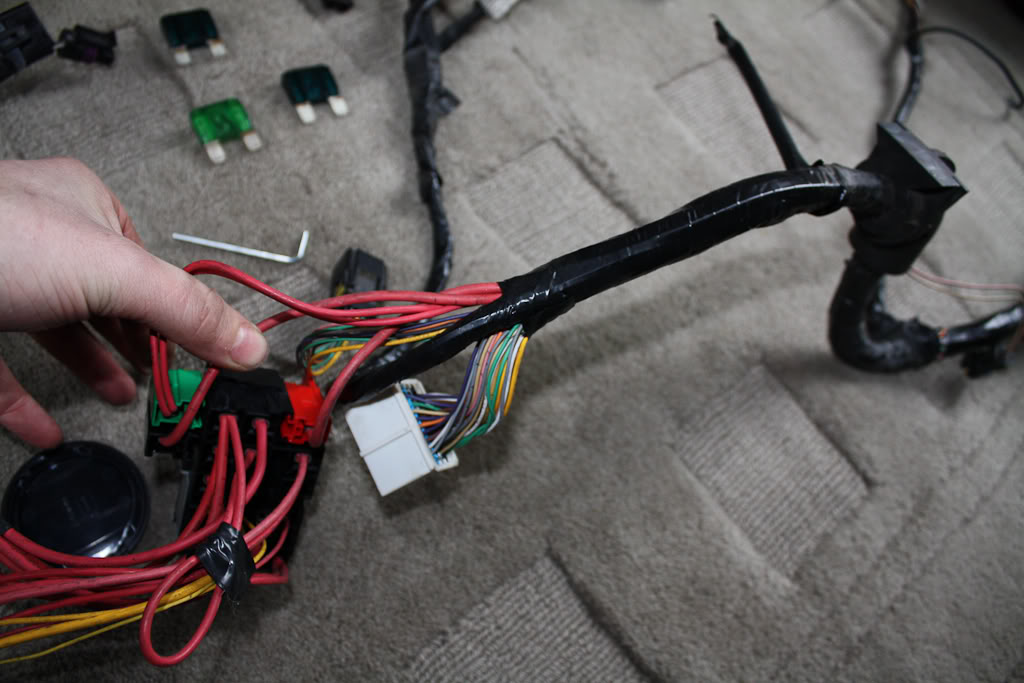

This is how i got the 172 phs 1 loom with everything still on it, as i dont need the lights side of the loom that has come off
The 4 red wires going in at the top going into the red,green and black clips are for the light side of the loom and this is wot has to come out as its not needed

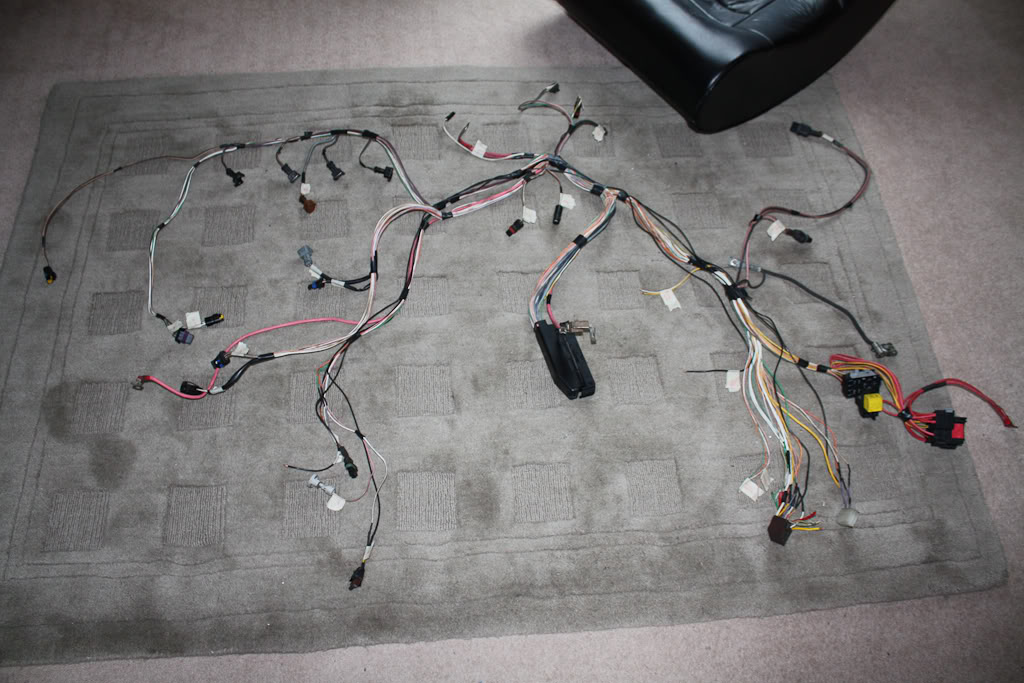

One the light side of the loom is removed i then lay it doewn on the floor and then set about labeling the connectors

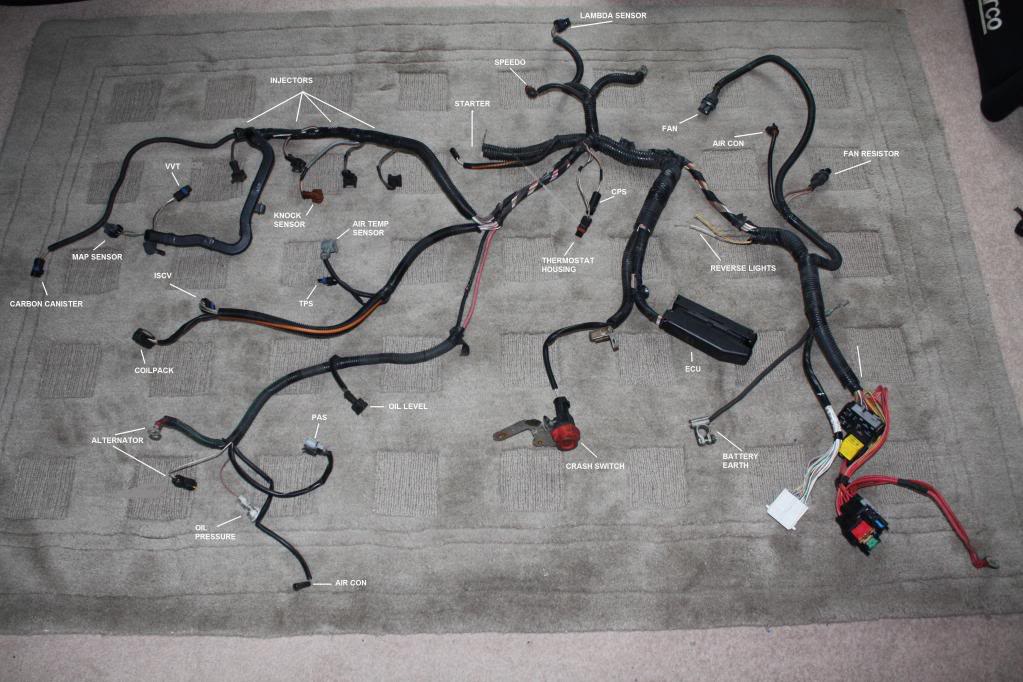

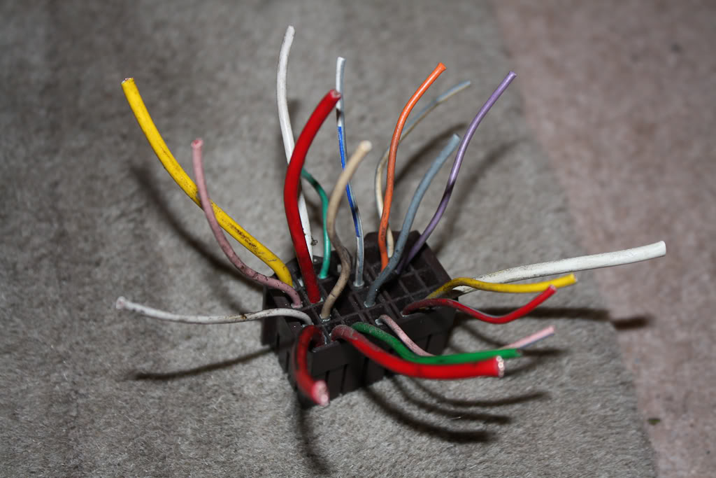

The connectors on the loom that im changing are oil level, oil presure and alternater to valver connectors, this is so i can run the valver alternater because the 172 doesnt fit and the others are so i can run the original or aftermarket guages. I also need to run some new wires too
This is the brown valver connector you need to put on the loom also a white connector with four purple wires coming out of it. This replaces the 172 white connector (above near the fuse box)

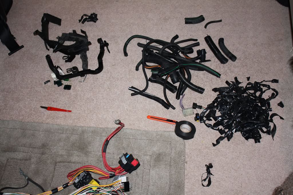

This is how the loom is now still needs some wires adding and some connectors when i get them off the valver loom, ive also stripped everthing off it so i can run the new wires and then put fresh tape and conduit on
All of the old stuff, there was quite alot of tape on it

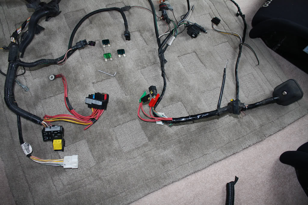

Little more done over the last 2 nights
Lastnight i finished off the wiring loom and labled it, leaving me with only one or two wires to solder as i need some bigger heat shrink then its sorted. Ill be then testing it in the car first before i wrap it up
Few more wires pulled out

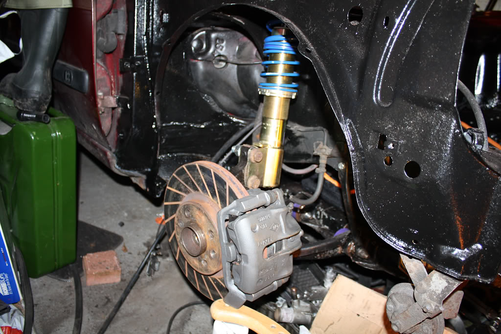

Today ive been and collected some more bolts/nuts and washers to put the hubs, caliper and suspension on, i also painted the off-side arch as i didnt have any paint left over from the other tin, i think its looks rather smart now

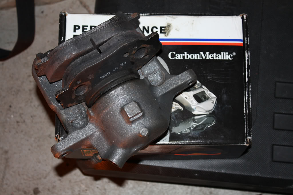

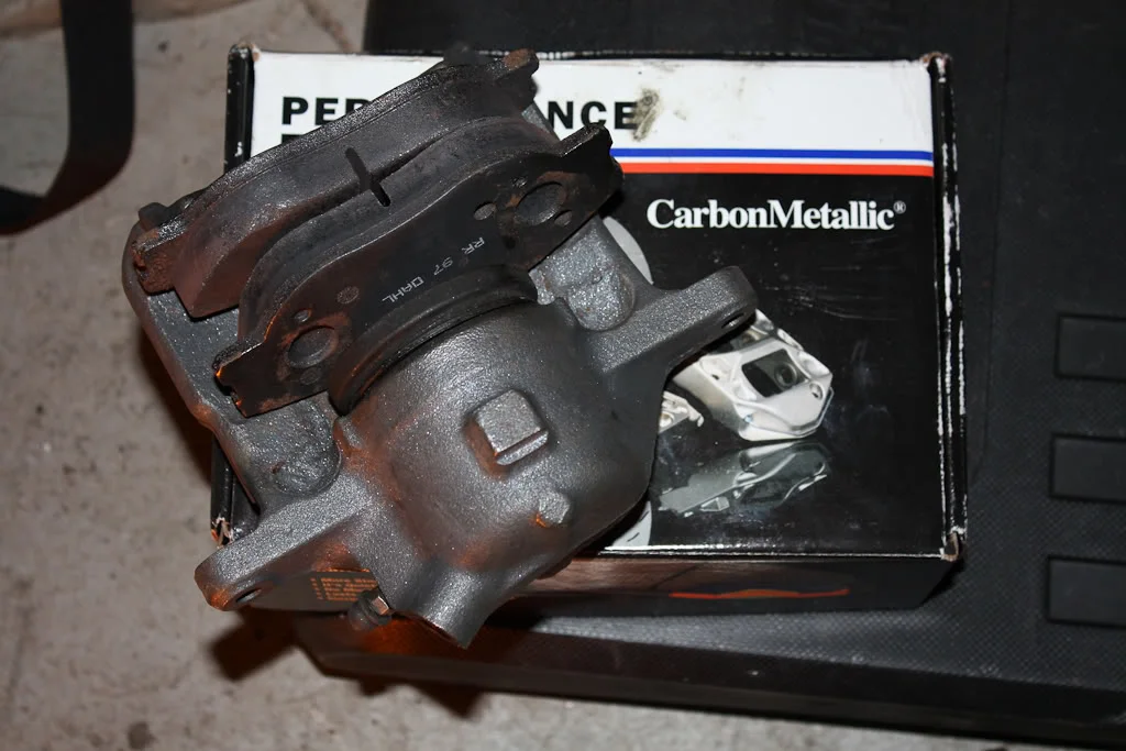

Fitted the pads (PF97 carbon metallic) into the newly refurbed callipers.
Hoping not to kill myself as the car will feel so much different
off-side
Near-side
ill be lowering the car onto all four whhels tomorrow once ive pushed the piston back into the calliper and fitted it, wheels back on, then on the floor, all i have to do then is wait till my braided lines come then i can fit them.

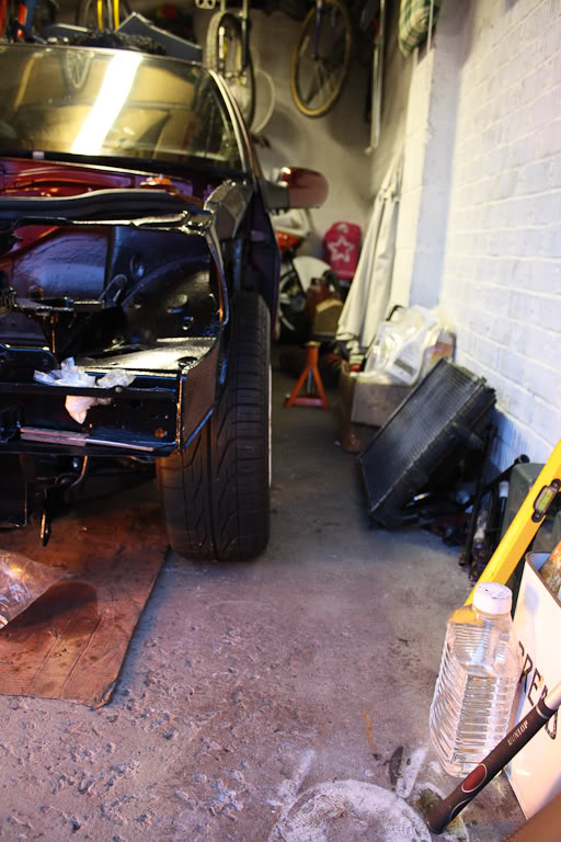

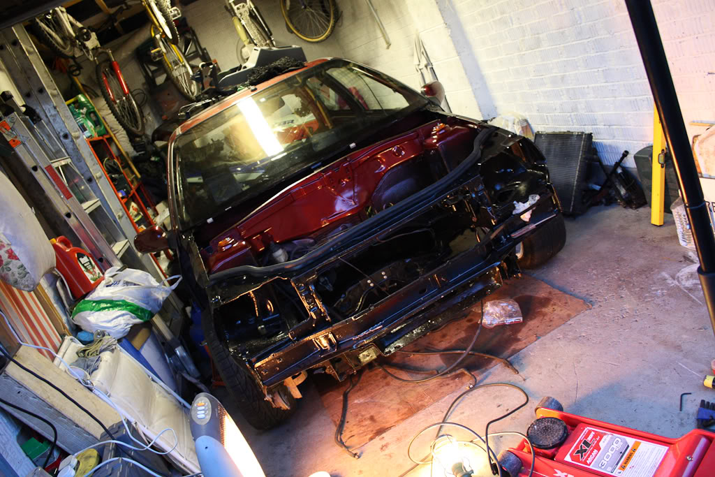

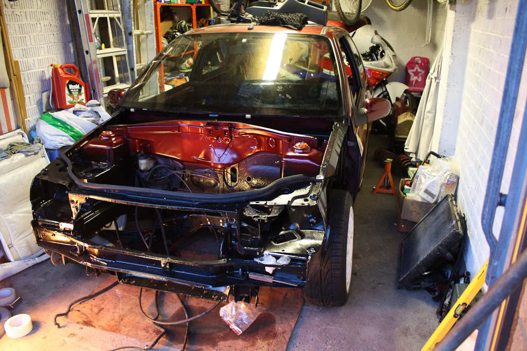

FINALLY the car is now back on all four wheels
Lowered the car down onto the topmounts to hold them in place but i cant screw the dampers down yet as i havent received the nuts from kam racing yet, i have the new style nut but they are such a crap design they chew the metal away and ruin the anodised finish, but im really glad its back down now cant wait to get the rest finished yet
