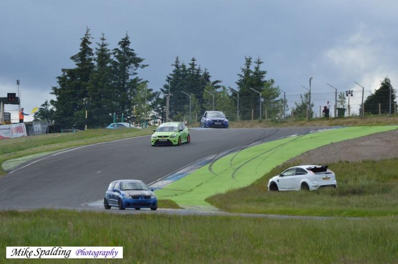

Looks very mean on track.
Do you not like the car? Giving Morgan a shot?? :eek:
:rasp: @ Morgan!

Haha had to destruction test the engine I built out somehow, only joking he took it easy on the car.
Yesterday showed up how much the car now really needs a diff , as it was pointless in the wet.
Totally for got to take the front plate off as well to aid cooling but the temps were fine all day, was worried with it being high comp now it would run hot.

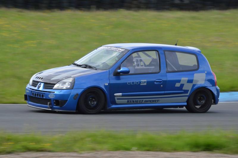

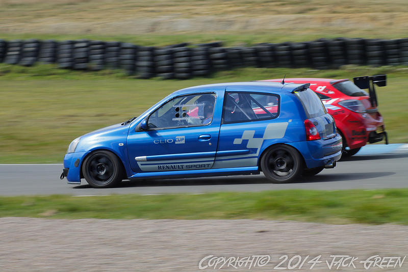

neil a best photo of your car i took yesterday
Neil's cup by W33 BRL, on Flickr
if you want a print let me know

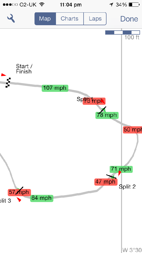

I'm getting just over 110 now in this new one John when I'm solo on both straights. Mental when you think 300bhp cars are getting similar.
  172 cup, Impreza P1
Re: Road/Track 172
You'll not be doing 110. Fastest I ever got was 103 and we've all got the same car essentially.
Check with gps or a vbox and you'll see how far off 110 you really are.

Ok 100+ I was just going off a glance at the speedo before getting on the brakes, and seen 110 a couple of times.

You need to put your foot down Stevie boy ;)
One of the first laps I looked at. Granted not 110 but easily achievable.
Or grow a pair! Either way, fair play!
Also, if I'm reading that correctly, you were mowing the lawn at 78mph. :rasp:
Around about. I'm usually 5-10mph quicker through the bottom of Duffus than at the apex. I was doing 80 at the apex when I spun at the days end :headno:

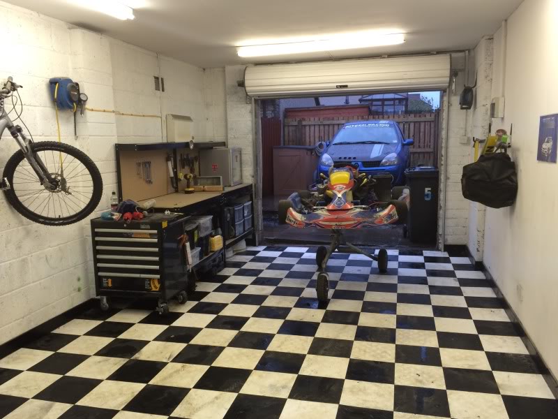

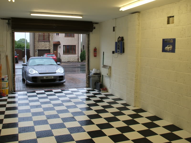

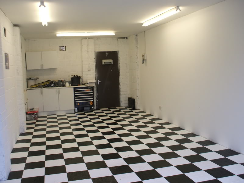

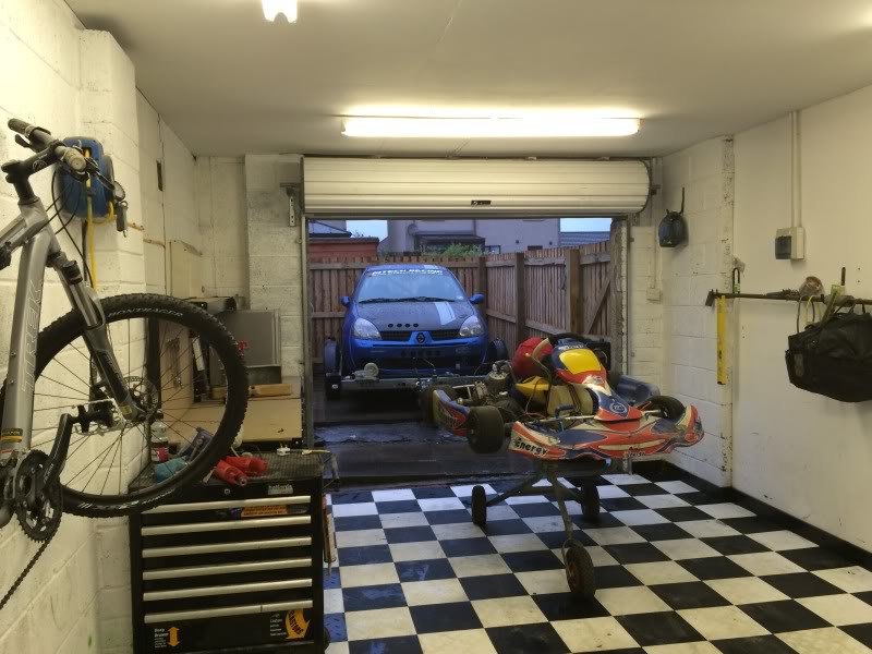

Not done any more mods to the car as I've been busy ,sorting out a storage space for the car and trailer. So this week was spent fencing off a section of my garden and fitting a roller door to the back of my garage to allow access to get the car and trailer out of the way.
Before
After
  172 cup, Impreza P1
Re: Road/Track 172
That really confused me looking at the pics there Neil and not reading the text. :eek:
So you have a through garage with doors at either end. Nice idea.
neil a
Re: Road/Track 172
Yes I did have my hot tub behind the garage but never used it, so sold that last month and made a parking space for the track car. Now just trying to get the floor cleaned up as 4 years of abuse has made a mess of the tiles. Hopefully by next week it will be looking lot more like it did in the second pic :p

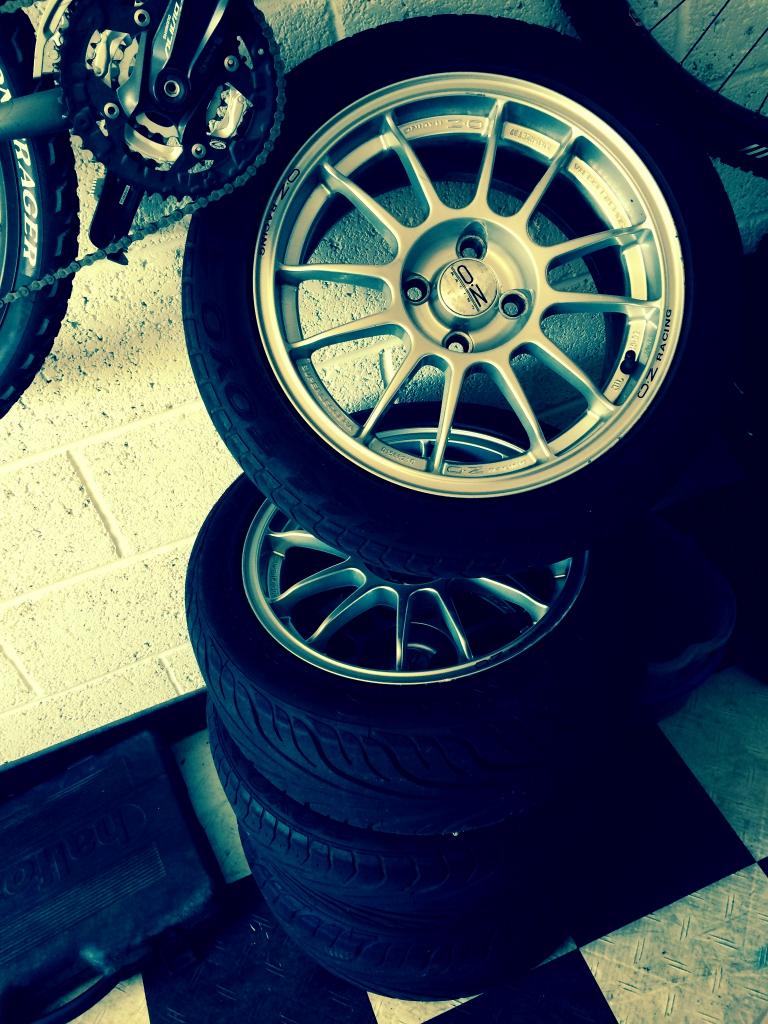

Also ended up with another set of wheels with 2 new RSR's fitted , but need another pair to replace the Toyo's.
