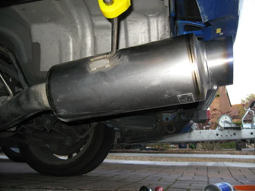

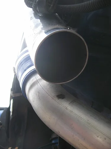

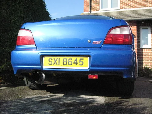

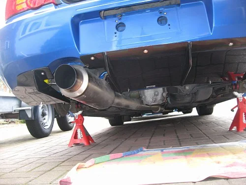

Next up was an exhaust system, after having one on my old Spec-C, i managed to track down a Ganador one peice titanium system.
light as a feather, and sounds awesome!

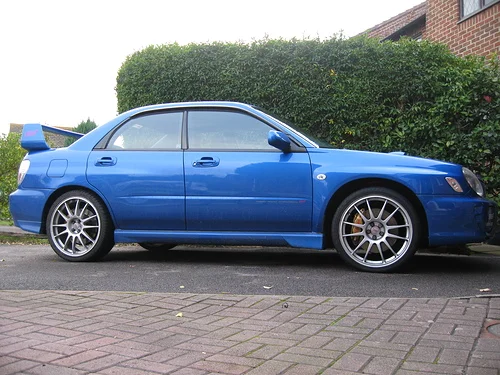

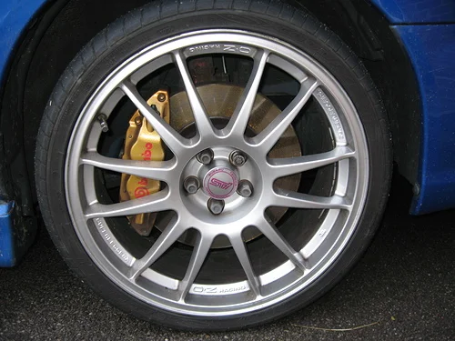

Although i liked the design on the OZ Super L wheels that came with the car, at 19 inches, they were too big for me, so sourced some standard STI rims

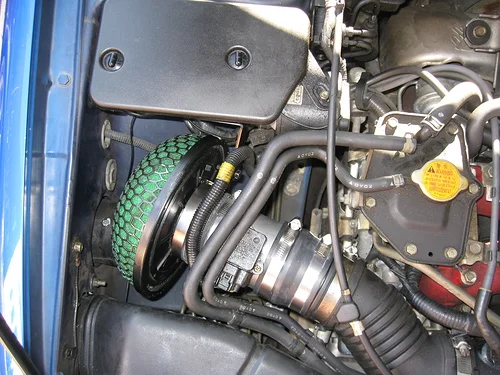

To compliment the exhaust i added a HKS intake kit

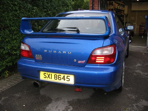

Next on the agenda was to remove the spoiler, as this is a 'less is more' project, and have never been a big fan of the big wing!
Holes filled and lid painted

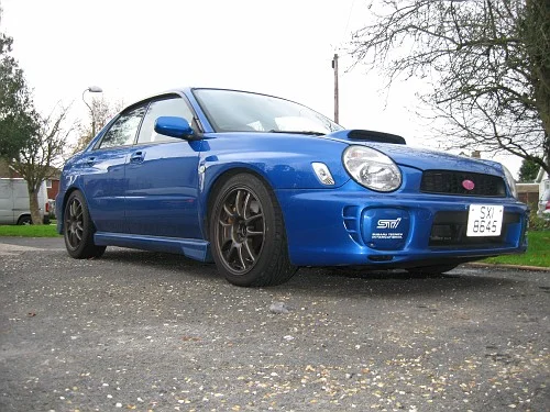

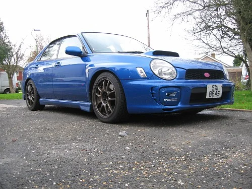

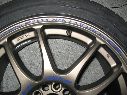

I ordered some Work Emotion CR alloys, 17 x 8 in bronze, which took around 4 weeks to arrive from japan.
I had to apply the stickers myself

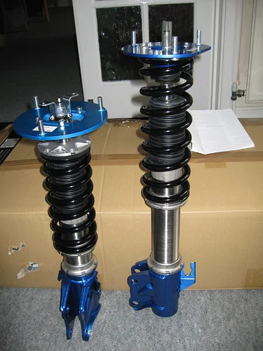

Before they went on, i decided to fit my coilovers. Cusco Zero 2E's. Along with front lower strut bar.

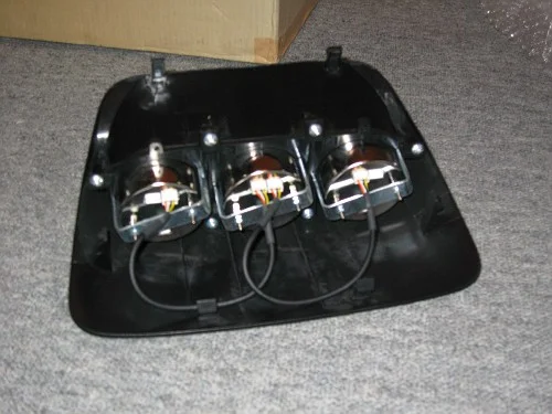

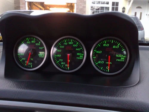

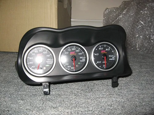

Next up was a set of genuine Genome gauges from Japan

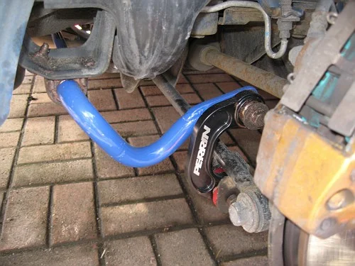

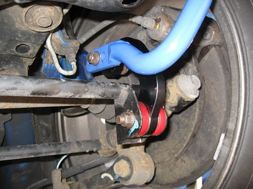

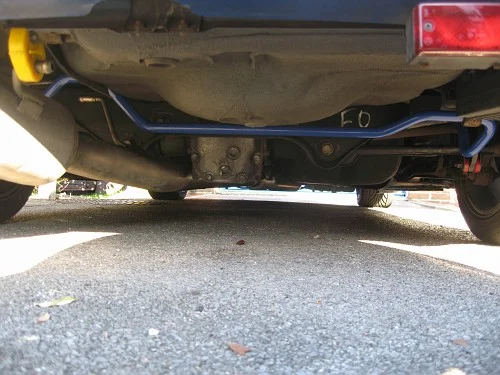

To add to the Cusco coilovers, i purchased a front and rear Cusco anti roll bar, along with some uprated droplinks

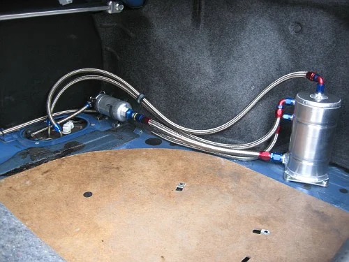

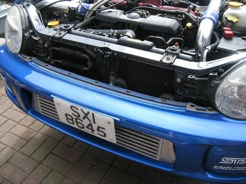

The engine was now due some work, so i went for a Hyperflow front mount intercooler, a Hyperflow top mount oil cooler, Hyperflow inner wing intake, Cosworth sump baffle, oil catch can (with return to sump), walbro fuel pump, RCM sports cat 3inch down pipe and a re-map.
All supplied and fitted by Zen. Car produced 350.5 bhp and 316 lb/ft.

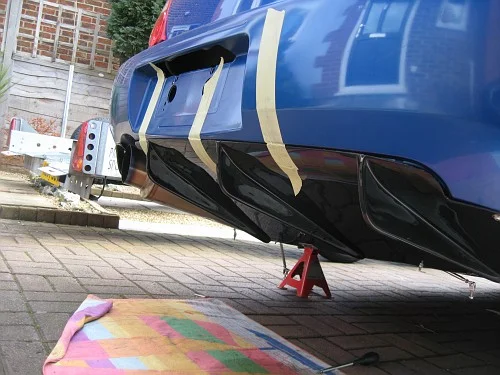

So next was the diffuser, went with an APR grp item
Trial fit
supplied screws in, and its on!
Not 100% happy with the way it sits, so will be removing it and re-attaching it at some point in the near future.

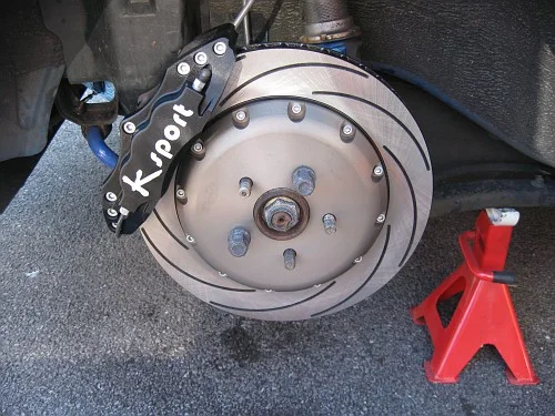

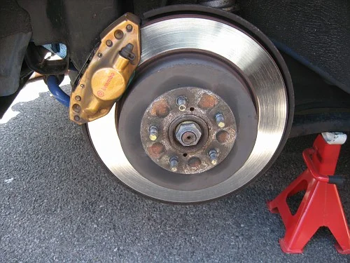

The brakes were the next things on the list. I had wanted a set of AP/Alcons front and rear, but for the price of one set i got both sets of K-Sports.
Old brakes
New Brakes

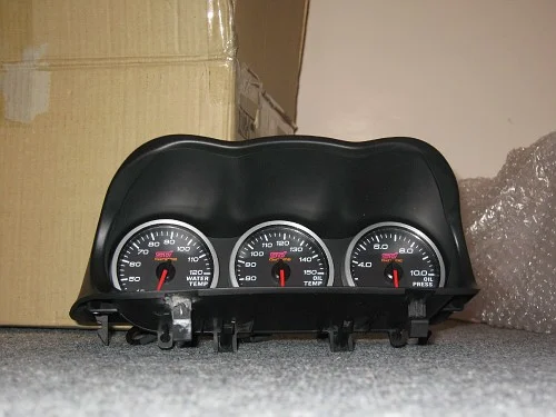

I also managed to pick up a Genome boost gauge, to go with the oil temp, oil press and water temp gauges

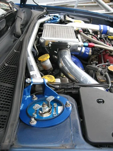

Next job was to finally fit my E-Con controllers to my Cusco coilovers
Strut top motors
Controller

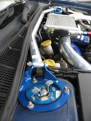

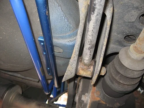

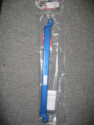

At the same time i also fitted a Cusco front and rear strut brace

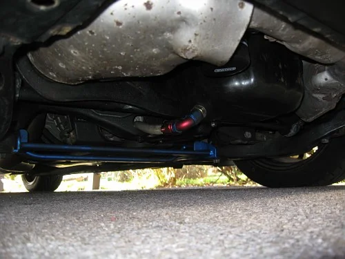

And a lower rear Cusco brace

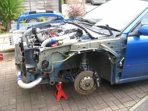

So i decided i would do a front end swap!

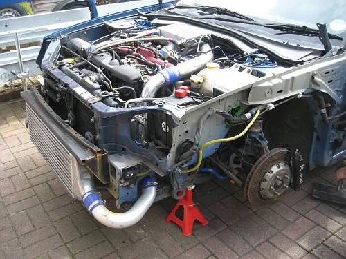

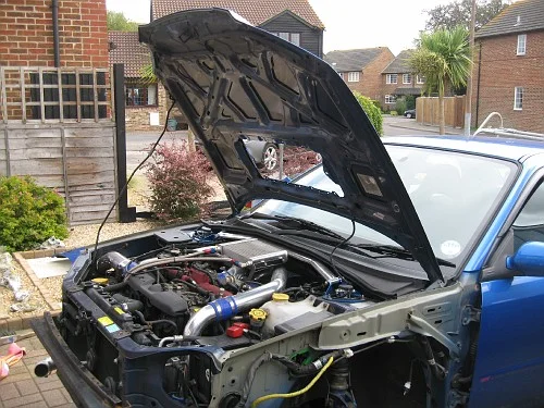

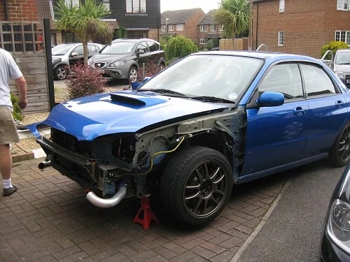

I started this a few days ago

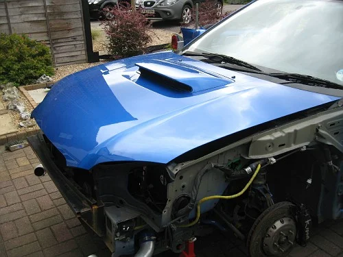

so... panels off!
Version 8 bonnet on

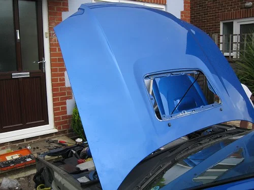

Went with a WRX version 8 scoop, as dont need a big one, as the intercooler is no longer there, and small provides enough air to the oil cooler. Plus, again, less is more!

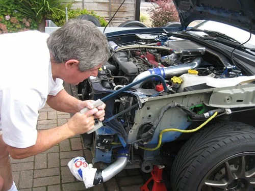

So this is where the conversion gets scary, i have the chargespeed conversion kit, which means cutting the slam panel. Somewhat easier than removing the original and welding in place a V.8 one. but still, scary to take a saw to the fron tof the car!
My old man doing the honours
a few cuts here and there (following chargespeed instructions)
Then chargespeed panel in place
Just doing the wiring for the headlights at the moment, so this is how she currently sits

You're sawing the front of the car off to replace it with a different one....?!

its just the head light part of the slam panel, different shape, so need adjusting. so its either replace the entire slam panel, or use the chargespeed kit.
bit extreme for some, maybe, but i felt i had to do it, rather than fall out of love with the car because of how it looked.
Plus with all the bits done to it, would of been major hassle to sell up and buy a blobeye (version 8).

Only downsides for me are the KSport brakes, which are cheap copies of Tarox (which aren't that great to start with). You could also do with a flat floor so that diffuser is actually capable of doing anything!

regarding the brakes - indeed, would of loved some AP's etc, but at the time the cost of a front set of AP's bought me an entire k-sport setup. And i was dubious of thier quality too, but i can honestly say that they are a decent bit of kit.
Took a serious pounding at the 'Ring recently, and worked perfectly. Plus alot lighter than the standard brembo's. Although i do agree, they dont carry much JDM bling. One day they will be replaced with some Endless or Project MU's, just need to find £5,000 to do it!
