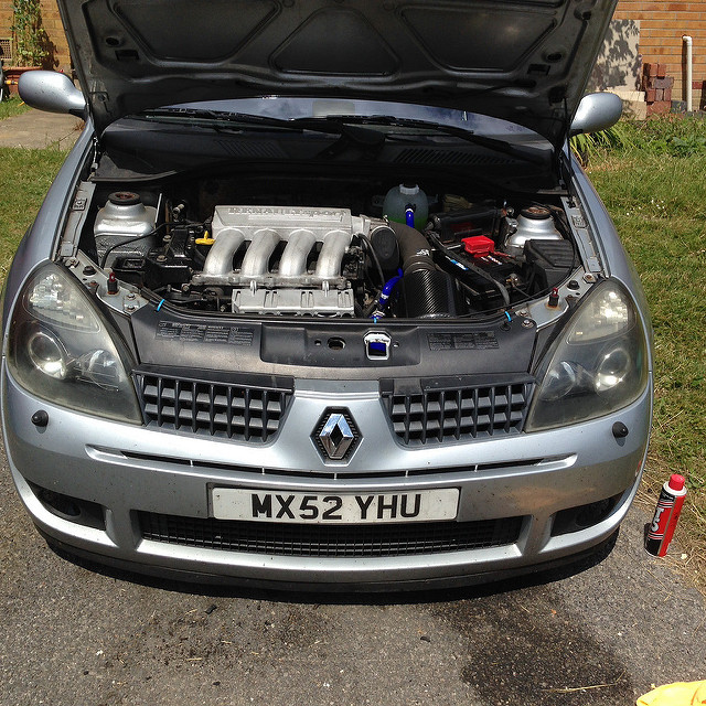

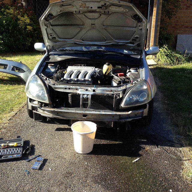

I took the 172 out a run the other week and on returning I noticed some water on the drive. Under closer inspection she was leaking coolant from a split hose. The coolant hoses are all original so a good excuse to change to some silicone hoses. I also plan on changing the manky expansion tank too.
Untitled by fletcher10, on Flickr

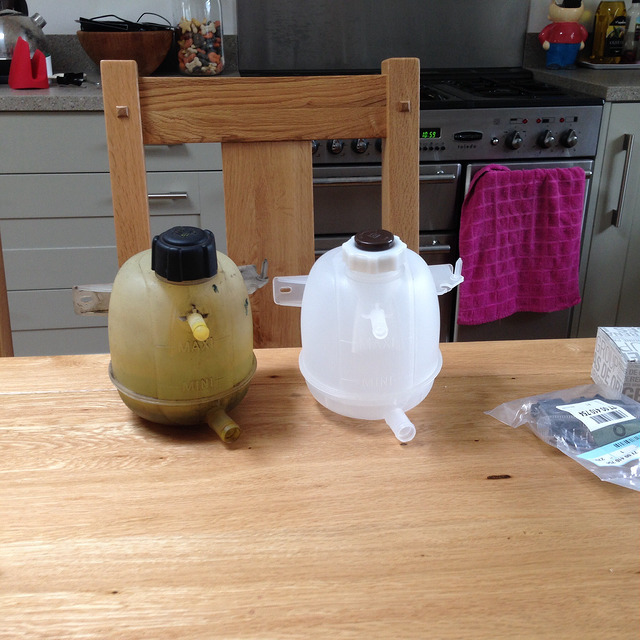

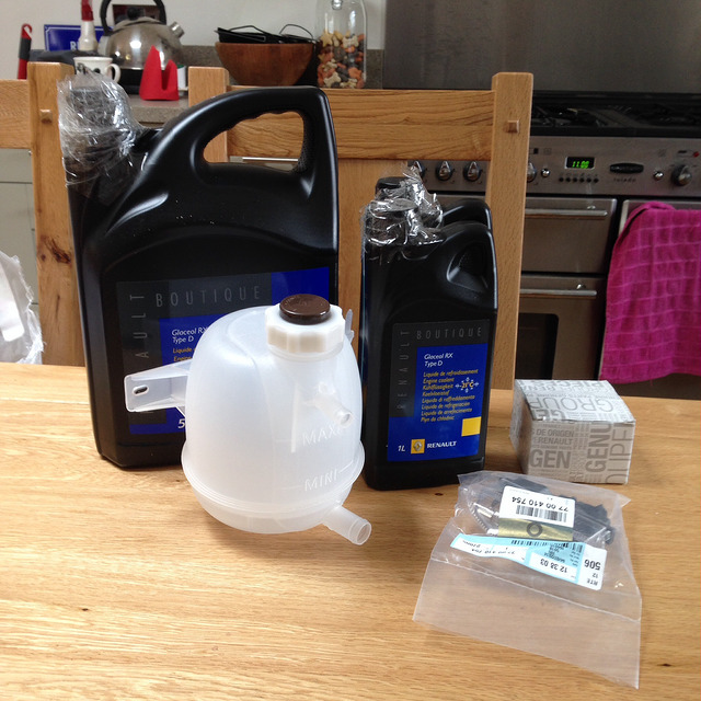

I ordered some parts from Wolverhampton Renault yesterday, they early this morning :)
Nice new coolant bottle.
And the rest of the parts.
I just need to sort out the new coolant hoses now.

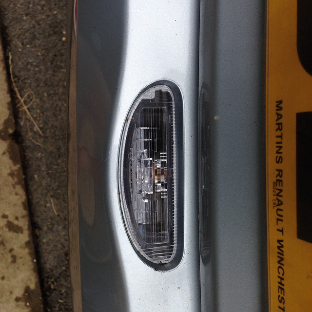

New rear number plate light.

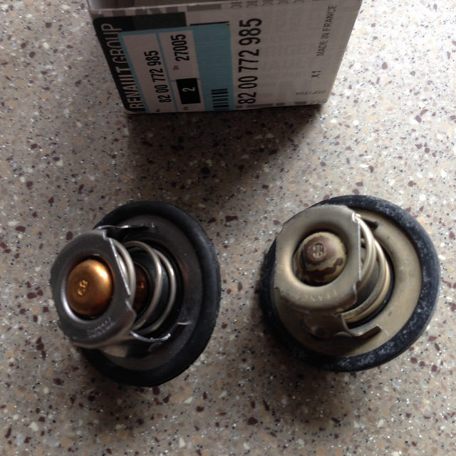

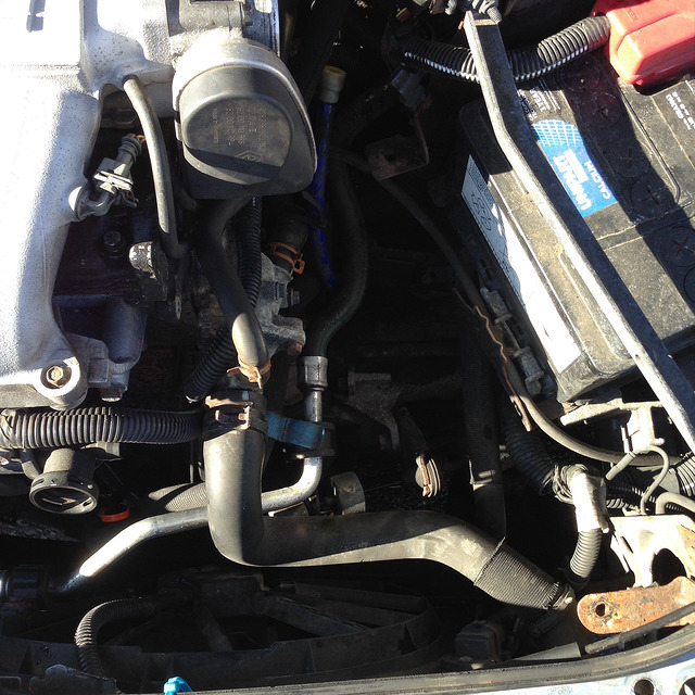

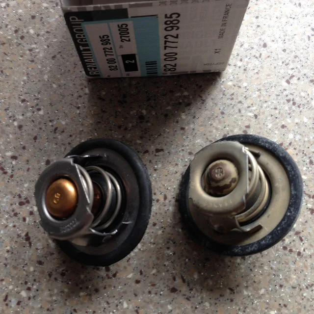

Thermostat had been playing up for a bit so changed that. New > Old

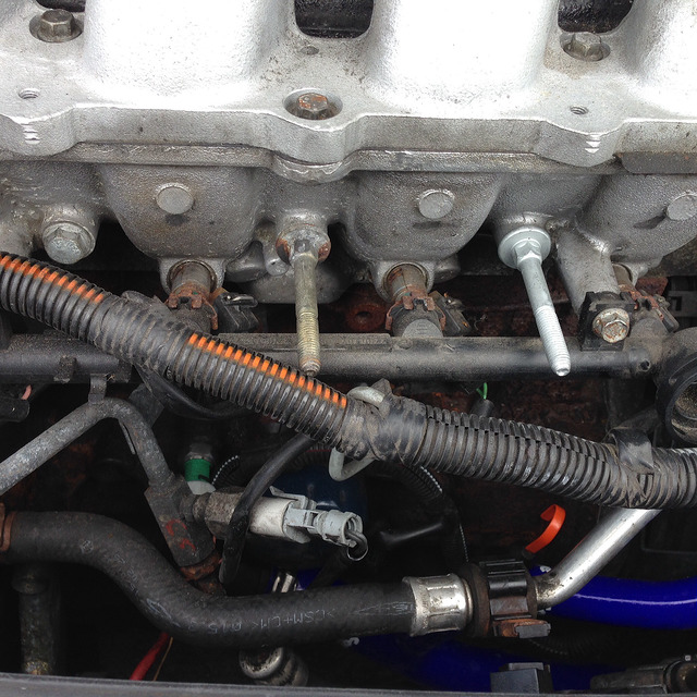

I broke a fuel rail guard bolt when removing the fuel rail guard. So that was replaced.

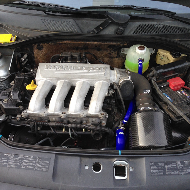

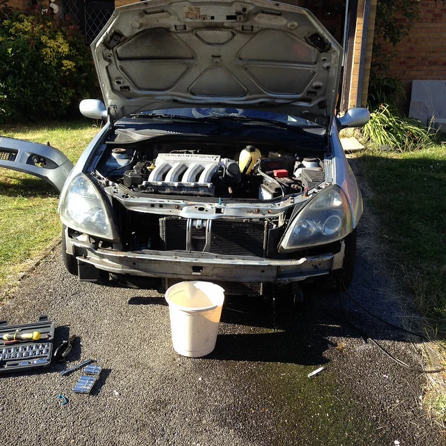

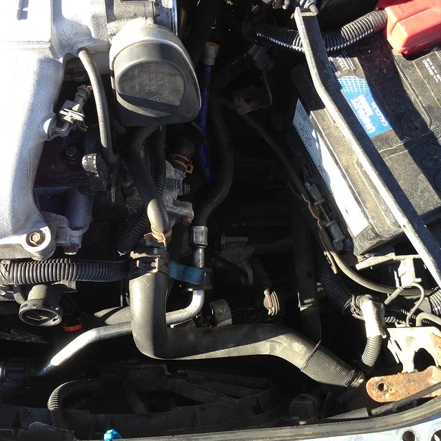

And new forge hoses, not the best pics.

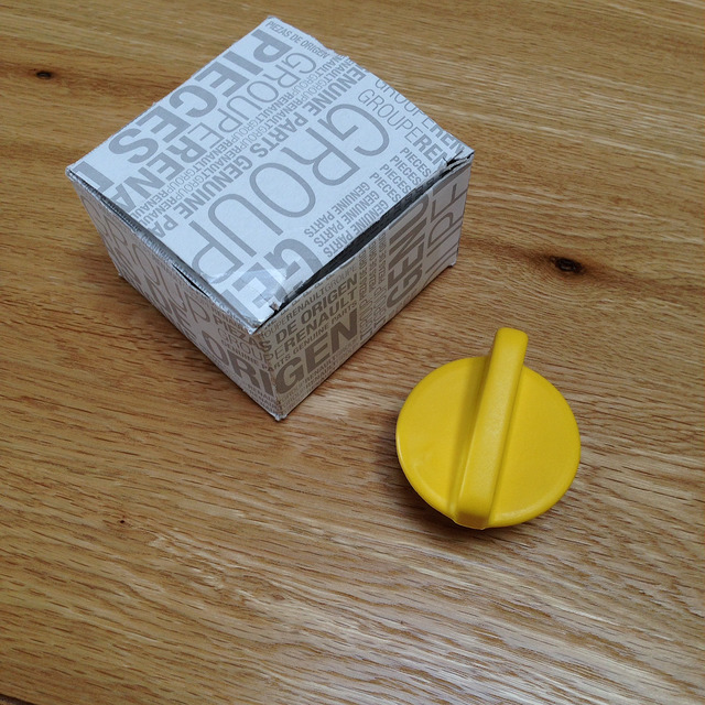

New oil cap. Will fit after next oil change.

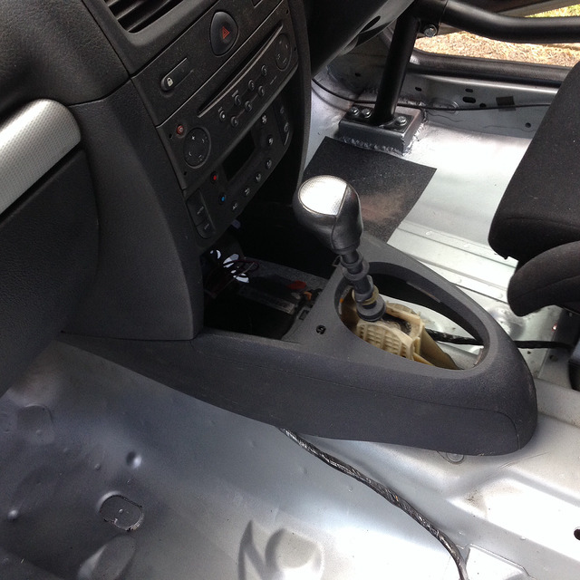

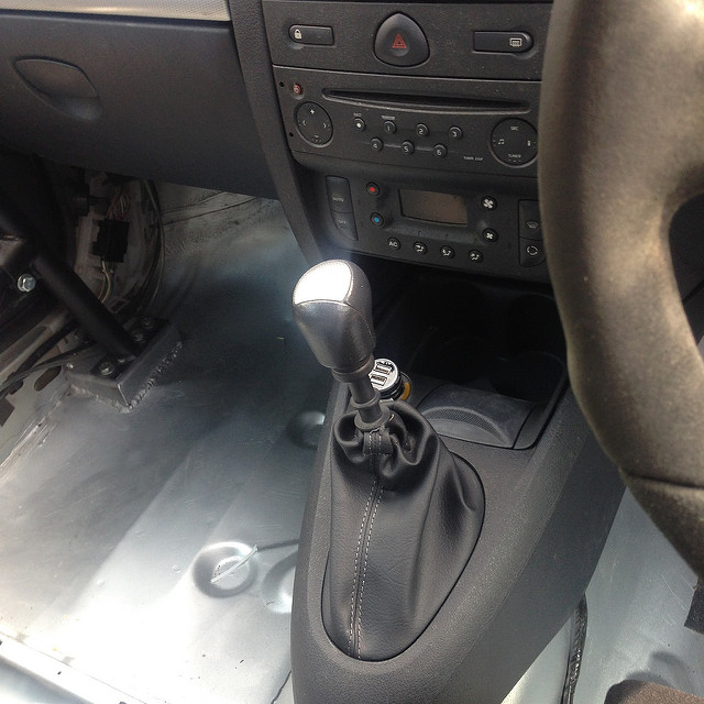

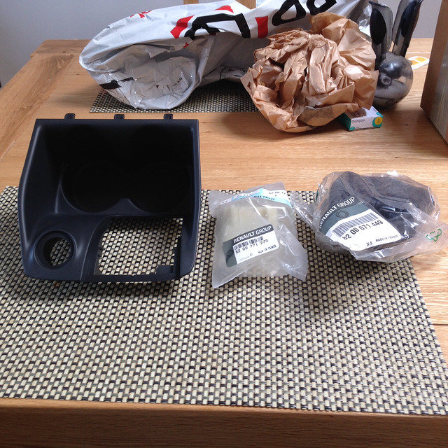

Trying to make car more comfortable for longer trips 'Ring etc. I have installed quite a bit of the interior.
I just wish I had done this before the ring trip. I can actually charge devices again with ease and the cup holders are handy for my phone wallet. All the sound deading has been removed so the weight pentally is minimal.

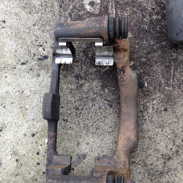

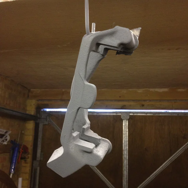

Brakes need changing now :( I am currently running Compbrake 4 pots these use separate bells rotors, to dissipate heat better .good apart from the disc cost ( you can't run standard discs with them) and they have now gone up to £115 each :eek: last time I needed discs they were £100 each.

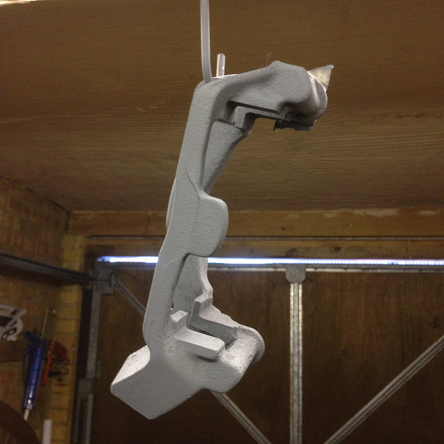

So I have decided to go back to the standard calipers keeping my goodridge braided hoses and run some Carbon Lorraine's RC6/ Brembo HC's.
after a clean and some VHT paint

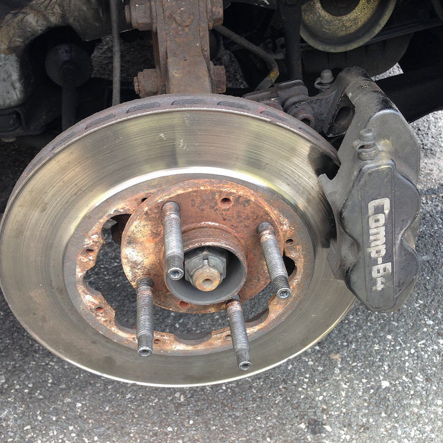

And also today I tried to remove the 4 pots but failed :(
I successfully removed the bell which was also nightmare, and then the top bolt holding the caliper would not budge, so I have given it a good spraying with GT85- WD40. Hopefully I'll get it off after a good 24hrs of it soaking in. If not I will have to drill it out.
